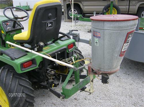

Herd for me! I've used mine on my 550 Mule, 3-pt disk & now use it on my JD 420.
Just clean it good after use & a light coating of oil before storage when using fertilizer. ~~ grnspot
