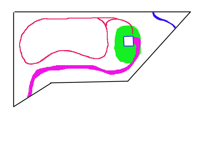

Hopefully, we will be breaking ground soon for our new home on 12 heavily wooded acres. My son has been asking for a go-cart / ATV for at least the past 5 years and we did not have the room for him to ride nor the space to store one. We promised him that some day, we would be building on some acreage and we would get something then. Well, that time is nearing and I need some advice.
Our plan is to have a riding trail (which we may also want for walking) encircling about 6 acres with an access trail to the rear of the house. I thought it would be prudent to have this done by the crew that is cutting the driveway and clearing the building site. I'm assuming I'll have the big trees removed by the same folks who are hauling off the timber from the building site and the stumps can be burned with the other stuff from the homesite.
Once they do the rough clearing of the trail, what is the likely procedure from there? I'm concerned about erosion initially. And, while a rough trail might be fun on an ATV, it wouldn't necessarily be good for a walking trail. I'm thinking I could smooth things out with my little boxblade but it seems like something should be done to stabilize the surface. Then I'm thinking that, no matter what I do to the surface, any significant ATV traffic will undo anything I might attempt.
On the attached drawing (crude, I admit) I've sketched out kind of what I'm talking about. The purple is the driveway, the green is the clearing for the house, the blue is a small creek at the rear of the propery. The red is kind of how I envision the trail.
The property slopes from front to back and there are a few ravines on the property some of which are probably 10-12 feet deep. Of course, this brings up another issue - bridges to cross the ravines or grade the slopes a little. Obviously bridges are better for walking while driving down and into and up out of the ravines would be more fun for the ATV
So, for those of you who have done something like this, I would appreciate any advice you may have to offer.
Thanks

Thanks for the replies. I think the chainsaw method would certainly allow more precision to the trail design and protect against erosion. I hate to admit it here, but the truth is I haven't used a chainsaw in probably 30 years or more and only had limited experience with one then. And, at this point in my life, I'm not sure I want to assume the liability of re-learning the proper use of what I consider to be a very dangerous piece of equipment (particularly when used by someone like me). So, I guess I either go the quick and dirty bulldozer method or hire someone with a chainsaw to cut the stuff my bush hog won't cut. I think my son and I could do the manly bonding stuff clearing out the cut trees and grooming the trail with the tractor.
As far as the width of the trail goes, I was actually thinking a 10-12 ft wide path (? road) anyway to allow safe passing of the ATVs and to give the kids a little room for error in their driving. Therefore, I don't think the dozer would be a problem in that respect. But, as I stated before, I'm just concerned about the surface condition after the dozer has plowed down all of the vegetation and the tracks have chewed up the surface.

You mentioned having timber taken out for the building site. Are you going to have the whole thing logged? If so, the timber company will likely bring in a dozer to make some trails. What they may want to get logs out may be a different plan than what you have pictured. You'll want to walk the property with them to determine and agree upon where the trails will go.
I would avoid putting a trail over stumps cut at ground level. After a period of time, the dirt will erode and the stump will become a huge bump in the trail. These won't be safe for riding and will be a problem when you're grading with a blade.
The trails that you pictured are pretty straight. For an ATV trail, I would propose something with more turns. Riding straight trails can get boring relatively quickly. Kids will compensate by increased speed which is obviously more dangerous. I would also consider some cross trails (top to bottom of the picture provided) to provide more areas. Maybe connect the trail to the driveway at the bottom of the picture as well. The driveway can then be part of the trail system.
How wide are the ravines? Personally, I drive the ATV's through the ravine. For walking, I made a 2' wide bridge for the span. A bridge big enough for an ATV can get pretty pricy.
For grading, the box blade will work fine. The big thing is to grade so no puddles remain as they will create pot holes.
What kind of ground do you have (clay, stone...)? My trails that are primarily clay don't erode to badly from traffic.
