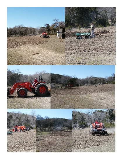

Kyle, I got a 8'6" Hay King disk it works great I need to get a subsoiler to do a first pass break up as the disk doesn't get down quite far enough but I planted with the disk only and everything is coming up great. As far as the sonotube I decided to pass when we figured out I'd be handling 22,000lbs of concrete. I'm going to go with the treated 6 x 6's as they are still using cca for 6x6 and larger lumber because they assume it would be for commercial or farm use. As far as termites they tell me out here that if you have mesquites you have termites and we only have 1 one on 347 acres so I'm going to chance it, worst case my kids will have to do something about it after I'm long planted like my food plots.
Steve
   / Auger Bit Size survey
Kyle, Here are some pictures of the food plots and disk.

Kyle,Those pictures don't show the disk that well heres another single.
Steve
