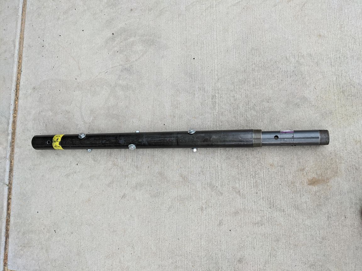

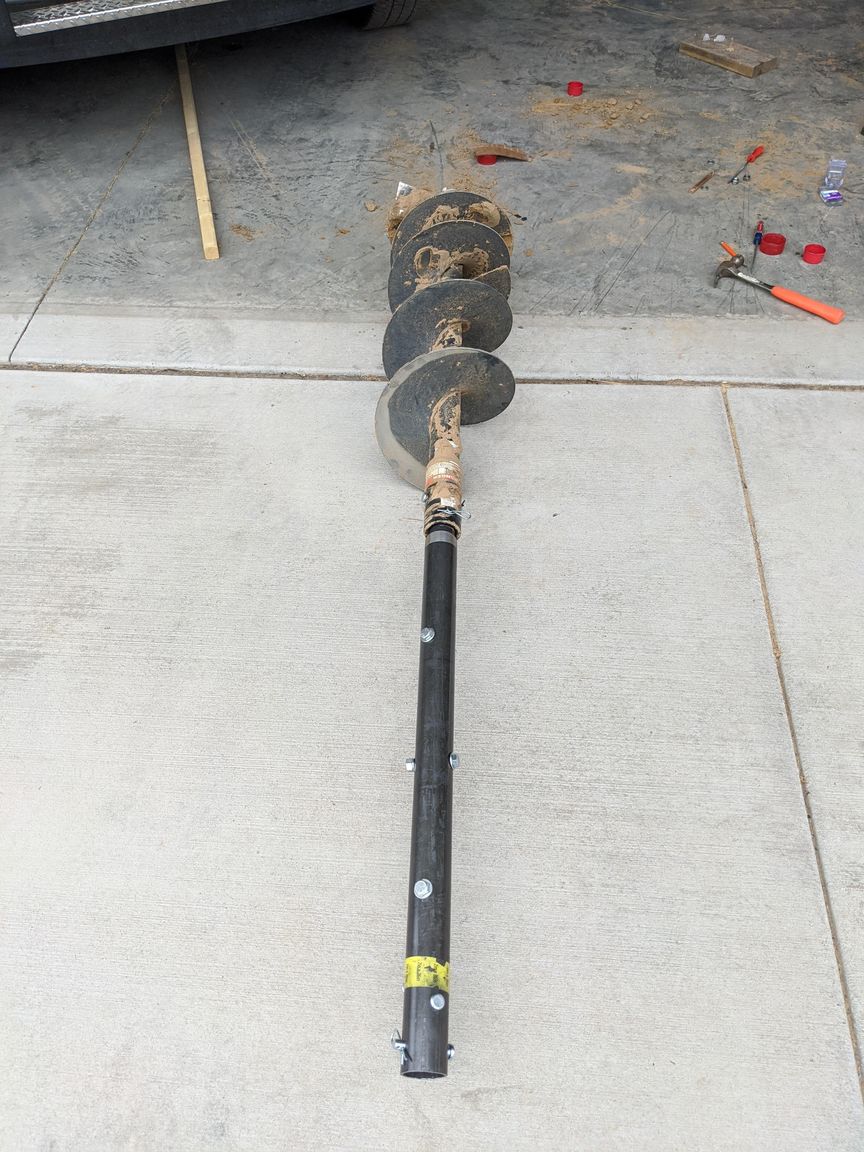

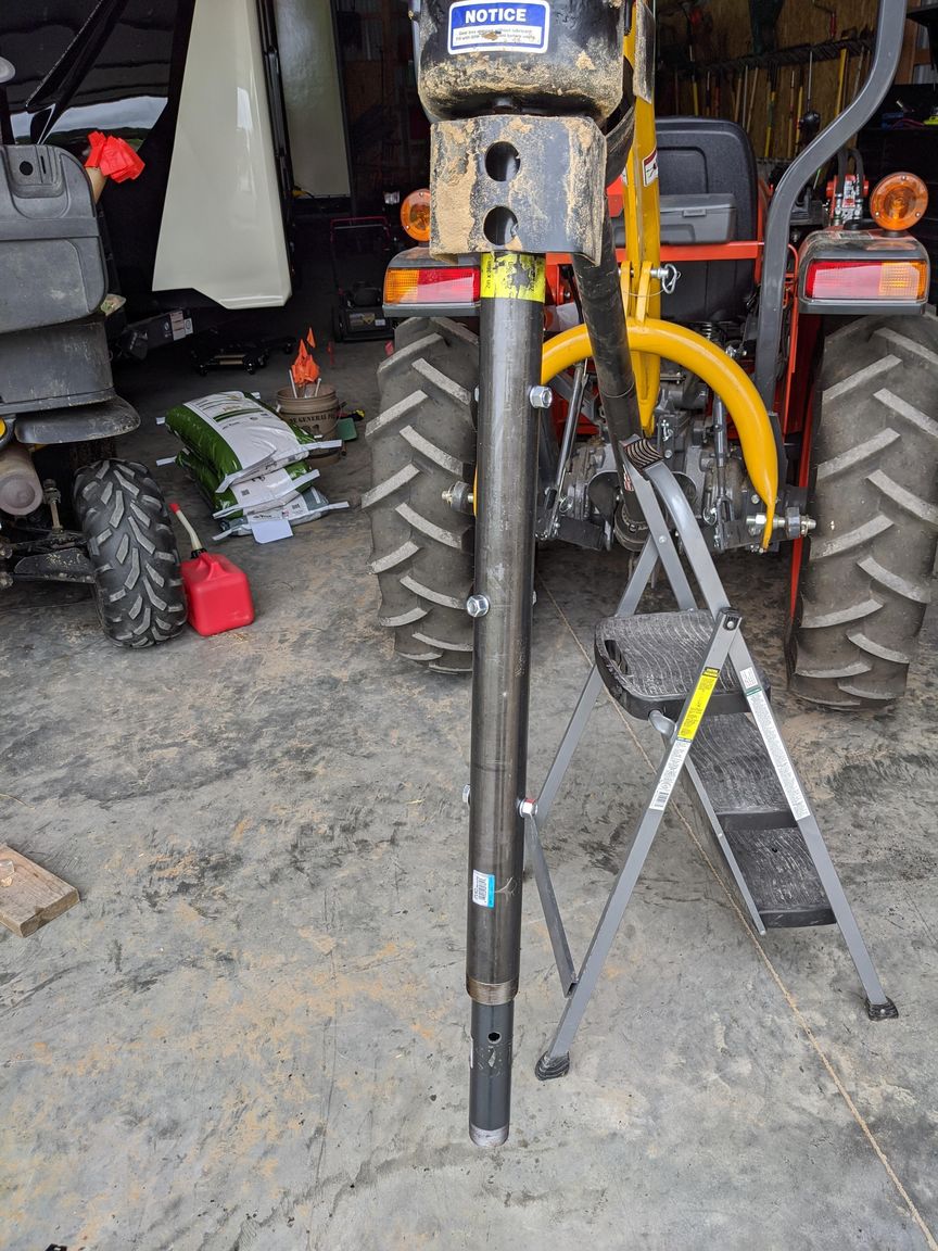

Hey all,
I am sinking fence corner and other posts 5' and my auger only goes down 3 feet. After hand digging the last 2 feet for 5 holes over 2 days, I figured there had to be a better way. I have a County Line/SpeeCo auger with a 2" round drive shaft. I searched for weeks for an extension with no success. I do not have welding equipment, but got to looking at the standard sizes of black pipe. Here is what I found:
SCH 40 Pipe 1 1/2 in
Outside Diameter 1.9"
Inside Diameter 1.61"
SCH 40 Pipe 2 in
Outside Diameter 2.375"
Inside Diameter 2.067"
The inside diameter of the 2" pipe would be .067" (approx 1/16") wider than my auger receptacle on my existing auger bit (part that attaches to auger head)
Inserting the 1.5" pipe into the 2" pipe would have 0.167" (approx 3/16") clearance
Inserting the 1.5" pipe into the auger bit would have .1" (approx 1/16") clearance
This all sounded like pretty reasonable tolerances, so I decided to make my own extension. Another idea I had that I didn't take advantage of, is by having one pipe inside the other, you could potentially make the length of the extension adjustable. I found, for at least my skills and equipment, getting holes lined up was very difficult, so makeing it adjustable was next to impossible.
Here is what I built.
I used clevis pins on each end to make swapping easy. However, that displaced shear pins, so there may be some risk with that. I am in sand and am not digging near my woods-lines (roots), so I figured I'd be ok.

Yesterday we got 3 holes done before we got rained out. Doing the math, it looks like it takes 25% of the time (75% less) than digging 2/5 of each hole by hand. It's totally worth the time and money for the extension.

Sounds like you made your project a lot easier! Good job making the extension. Any wobble to it or are the tolerances close enough?

I had a little bit of a hard time lining up the holes between the pipes. It took a small bit of filing and encouragement with a hammer to put together. As such things are tight. The inside pipe is against one side of the outside pipe instead of perfectly centered. When drilling everything looks fine. No wobble or anything out of alignment.
