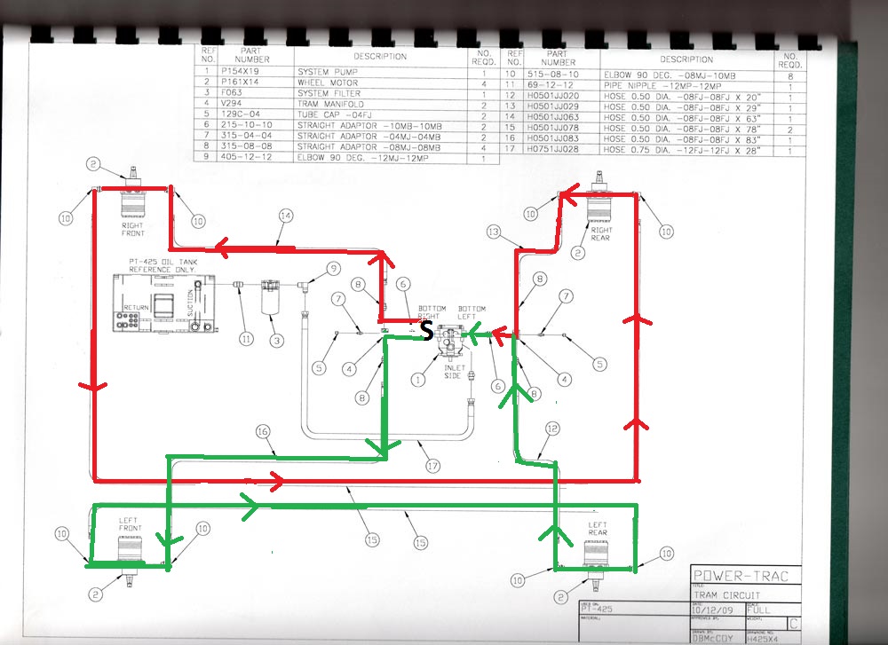

Let me put it another way.
Does your aux circuit have a return hose and is anything plugged into it?
Do you have a hyd schematic for the machine? Something like this.

The rerun oil from the motor is NOT going directly to tank. The 753 of this vintage used the return oil from the hydraulic valve to furnish charge pressure to the hydrstatic pump, Oil out of the valve after coming back from the work port goes to oil cooler, through filter, then to hydrostatic pump where there is a 165 psi. relief valve. So back pressure on the return line from auxiliary coupper will always be a minimum 165 psi. If oil was rerouted directly to tank, the hydrosatic pump would starve of oil while running the auxiliary.

i think you will find a valve down stream of the couplers and when you deactivate the spool to stop the motor from turning the drum, you block the return to tank hose, the drum turning the motor turns it into a pump and builds pressure fast, and with no return to tank,blows the hose. A 4 way cushion valve will prevent this.... Jim
check on page 72, it shows the aux hoses and valve https://www.usedloaderparts.com/wp-content/uploads/2014/08/pdf-bobcat-753g-parts-manual.pdf

I looked at the schematic and there is a control valve downstream as you thought there might be. Help me understand something, bearing in mind I'm a newbie to hydraulics when you answer or keep it real simple I should say. I just assumed to the two lines that make up the auxiliary hydro circuit were one line as a feed, and the other as 'back to tank'. Am I missing something here. I just assumed that connecting one fluid hose to the auxiliary feed at the Bobcat and the other end of the hose would connect to the flow control valve to control the mixer. Fluid would pass thru the valve, drive the motor and the fluid just goes thru the motor and out the other hose to a reservoir, not really under any real pressure. Are you saying that the return doesn't go dump in a nice quiet little reservoir tank, but slams possible into the other valve and creates pressure? Should I be looking for a way to truly dump return fluid directly into the reservoir? I think we may be getting close. Your thoughts. Thanks again for a everybody's help. Mark
