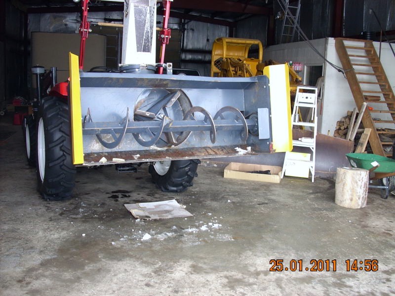

Hi Guys,
Thanks for the info - I really appreciate it.
My fan/impeller clearance is 5/8" - too much. I will be fixing that somehow this summer - maybe fitting renewable blade tips on each paddle.
The auger clearance I have to measure - but from what I recall, is close to 2" or there abouts. I will measure it tomorrow.
Here is a picture of my old blower and you can see the excessive clearance on the fan.
With the right PTO speed , it still throws a good distance around 30ft at 740rpm instead of 540 rpm.
Thanks
Jim

   / AUGER TO CASING CLEARANCE ???? #5
Everybody says that the fan/housing clearance is super-critical, but I don't believe it. Bigger is better, and a closer clearance via longer fan blades will give you higher fan-tip speed, but other than that, I totally don't believe that the gap itself makes any difference. Within 10 seconds of running the machine, that space is filled with super-packed snow, making the gap roughly zero, and is as solid as steel as far as the fan is concerned. If I closed a gap from the outside using collar or something, I'd bet there would be no difference in performance.
I'd like to see proof to the contrary, if it exists.

   / AUGER TO CASING CLEARANCE ???? #6
Jay - if you look at the surface inside the fan housing, it's polished bright with lots of sweep scratches. If it was packed with snow how would it get that way? The centrifugal force shoves the snow (and rocks, sticks, dirt, toys etc) against the outside until it gets launched up the chute. It rides hard against the inside surface and keeps it shiny clean. The only time I've seen a buildup in there is when the machine was much colder than the air temp and it temporarily froze on the surface until it equalized. Then it was gone.
No proof, but here's why I think impeller clearance matters. The impeller sections alternately fill with snow, then air, then snow etc. Impeller clearance allows back-leakage of snow and displaced air at the outside of the circle, right where it is most disruptive to tip velocity. The snow is fighting a local headwind at each tip. In a water pump it has more effect than in a snow pump. Snow is semi-solid and holds itself together a bit, helping to plug the gap. I agree the effect isn't large unless the gap is. Take care, Dick B
I'm sure the snow moves in there, but I'd bet that it doesn't clear every rotation. Don't know - never looked. I try to never be on that side of the blower while it's turned on (skeered).
Here's an experiment for someone with nothing to do and a hunger for science. Take a blower with a 1/2 fan/housing gap and make a pass, and measure throw distance. Then extend the fan blades to reduce the gap to maybe 1/8" (something easy, like tacking on some filler pieces of steel) then make the run again and see if the distance increases measurably.

   / AUGER TO CASING CLEARANCE ???? #13
Hi Guys,
Thanks
Jim
I have a 60" version of your machine. I thought of adding rubber strips to the edges similar to the setup on those small single stage combination auger/fans. I don't know if it would do much good on our machines because the back wall is flat and not shaped to the auger. There would still be room at the lower corner. For now I keep my trusty square edge shovel handy to dig out the snow before putting it away.
I do want to add rubber strips to the ends of the fan blades as some say that will make a difference.
I'm not impressed with the chute on these. I think it is too big and boxy and doesn't get a good flow moving easily. I see bigger blowers with the half round shaped chutes with segmented deflectors that look smaller then the chute on ours. Those chutes can keep the flow going right down to a tiny bit. If the snow gets thin on mine, it turns into a puff cloud.
