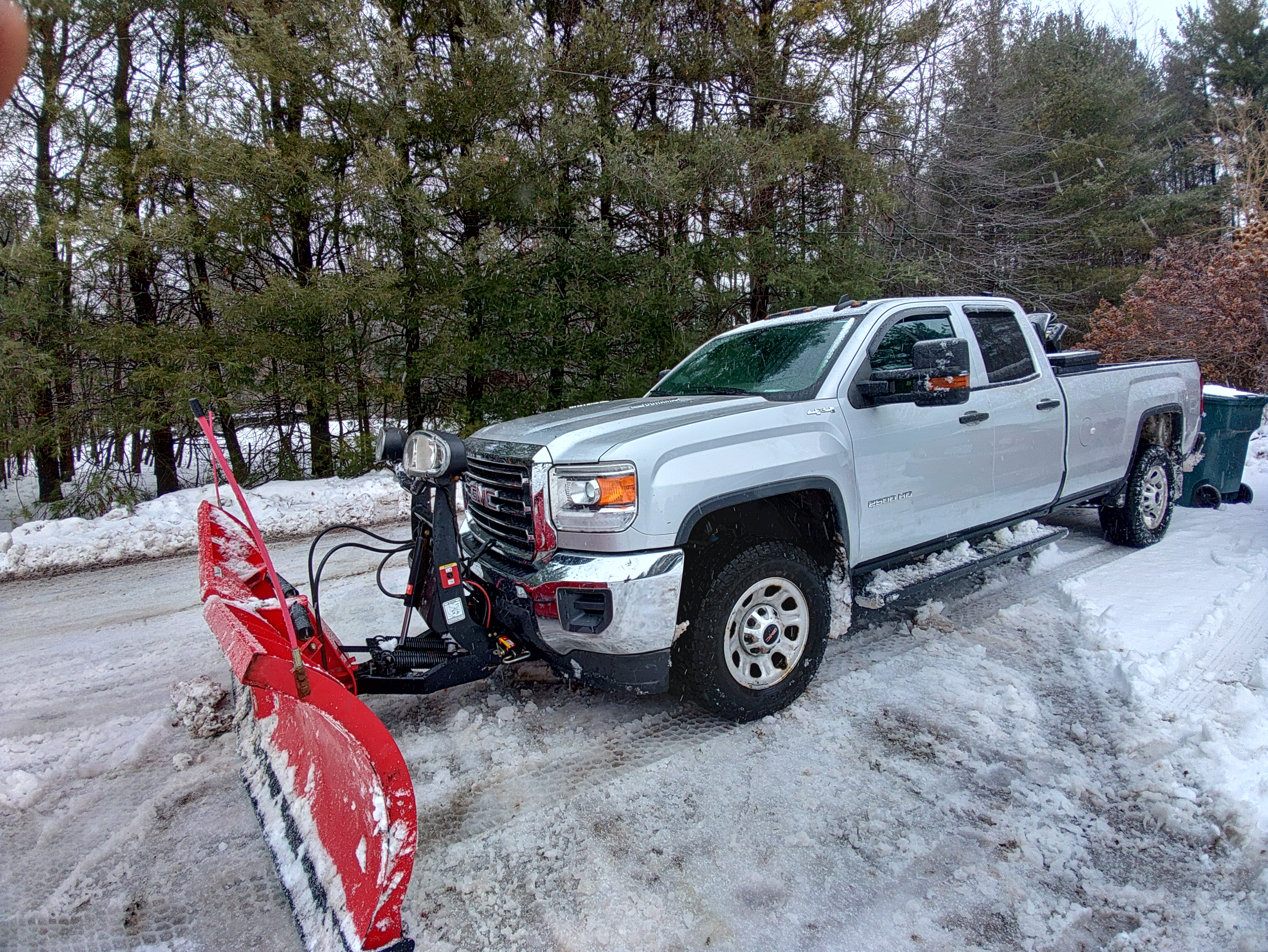

So this huge boss v plow I got for my 3/4 ton is barely used all steel 9'2" long weighs almost 1k lbs. Given to me by a family member. Having it installed professionally Bought all new wiring harnesses and mounting plate for my truck. Completely upgrading all front end components with heavier duty aftermarket kryptonite brand, like ball joints, tye rods, steering arms, shocks etc at the same time. Temporarily putting a junk JD 260 in the truck box for weight until I save up enough money to buy an 8' dumper dog. Looked at turf savers for plow all they are is pipes or rounded channel with mounting brackets to bolt onto cutting edge using existing bolt holes. I have some scrap high pressure tubes lying around so I'm going to notch those weld them to cutting edge cutting angles on inside to allow movement for plow angles. Ill be using 8018 electrode cuz I have so much of it given to me, to weld on cutting edge I'm also running a xcross pattern on bottom of pipe for hard facing. Any suggestions or questions feel free to ask.

I tried plowing with the tube on the bottom of the cutting edge and found it left a thin layer of ice after plowing.
