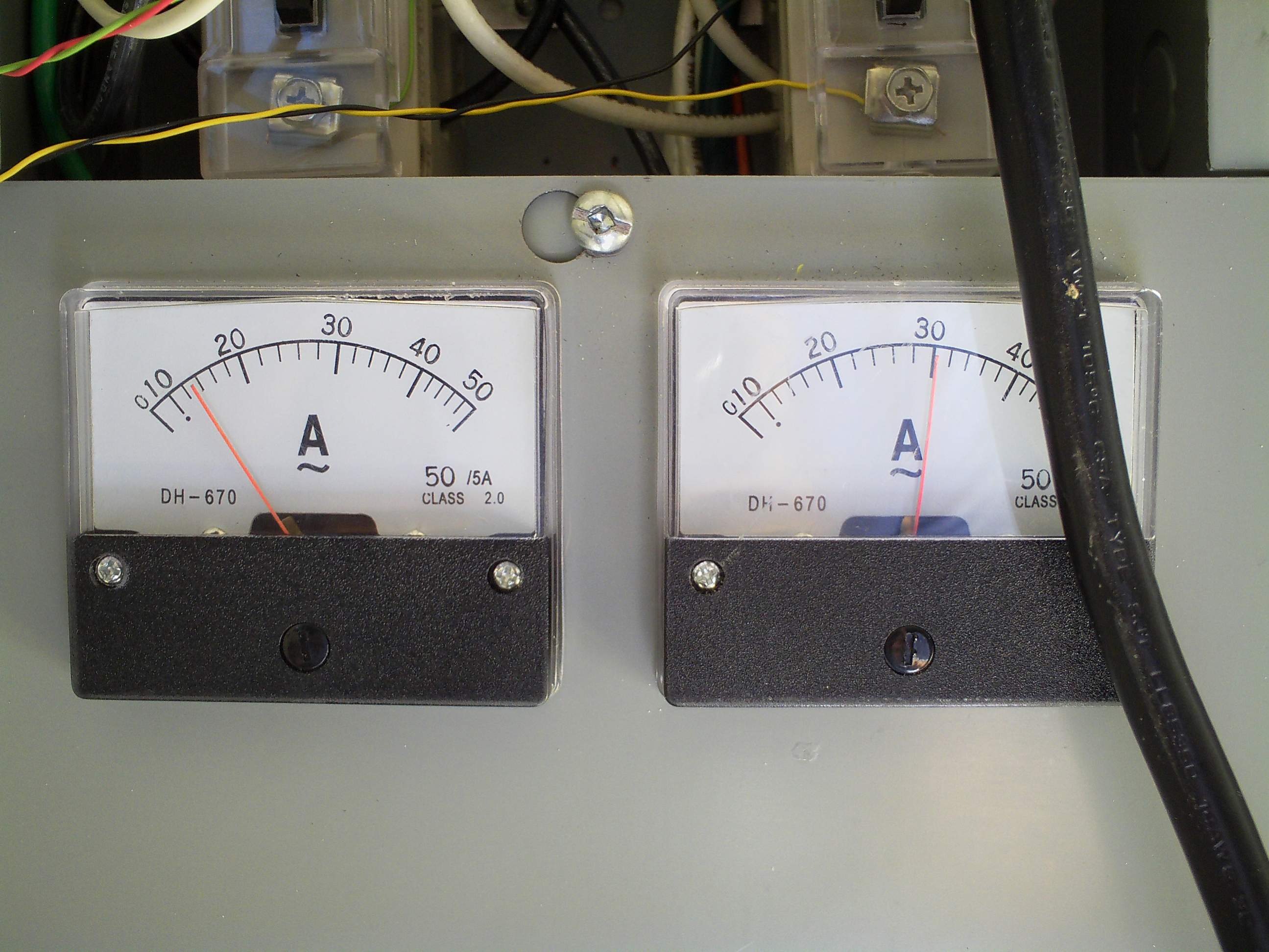

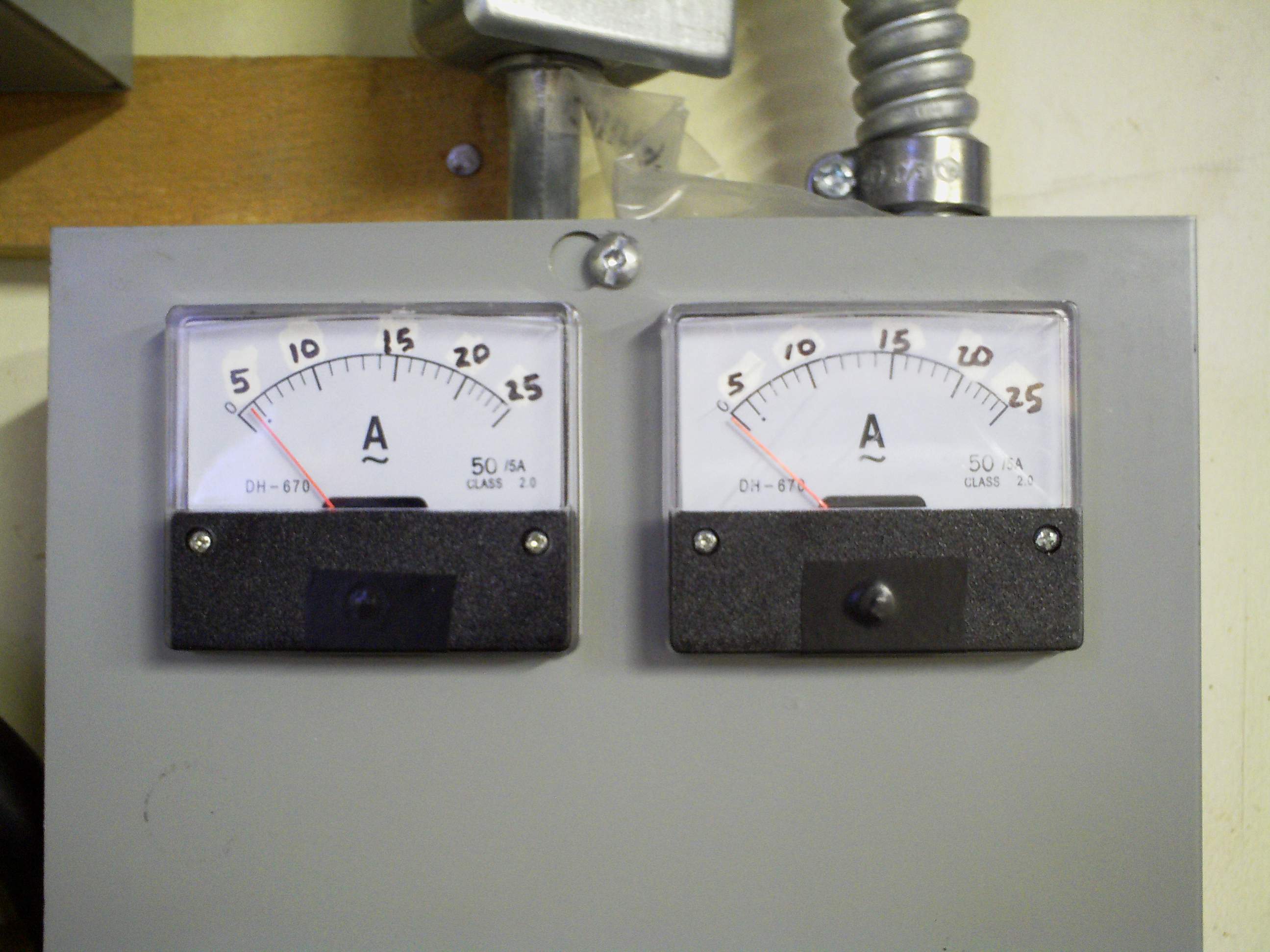

My gas generator has half the capacity of the diesel generator, so I needed a way to monitor the load regardless of which generator was connected to to the ATS. I installed current transformer/meters on L1 and L1 (before the load bank) so that I can see the load and reduce it reliably if necessary.

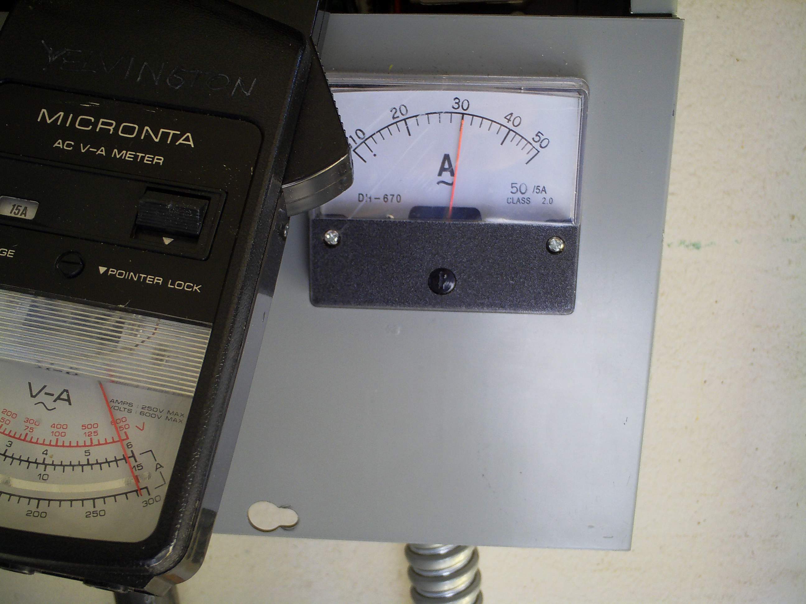

The CT/meters were 50A, and the maximum that I'd expect for either leg would be 30A (the breaker on the diesel generator). I put a second loop through each CT to set the range to 25A, and relabeled the meter faces for the new range.
I compared deflection between the single and double-loop CTs, and the linearity on the inexpensive meters was quite acceptable. I mechanically adjusted the meters so that the mid-scale reading matched my two other current meters.
Photos attached for your consideration.
