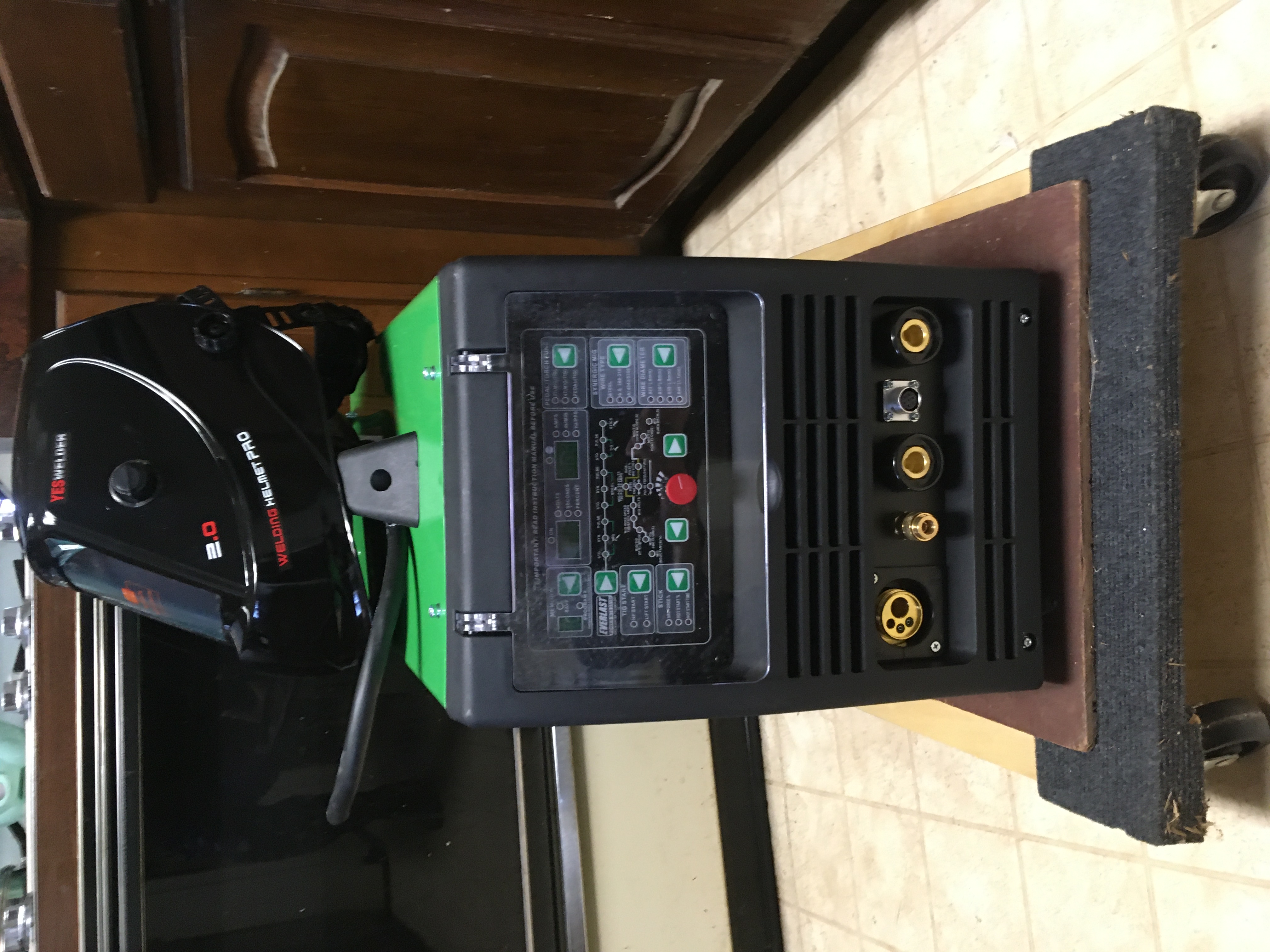

I bought a similar one, but it didn't come with instructions. (YESWELDER LYG-M800D) There are two shade ranges, but I'm not sure how to select them. 5-9 or 9-13? Outer shields are so big I'm looking for replacements. Came with & calls for 4.75" x 5.5" vs the 4.5" x 5.25" seen everywhere. btw, I found out that an iPhone is quite good for testing wall mounts. ;)
YESWELDER Large Viewing Screen 3.94"X3.27" True Color Solar Power Auto Darkening Welding Helmet, 4 Arc Sensor Wide Shade 4~5/9-9/13 for TIG MIG Arc Cut Grinding Welder Mask LYG-M8D - - Amazon.com
