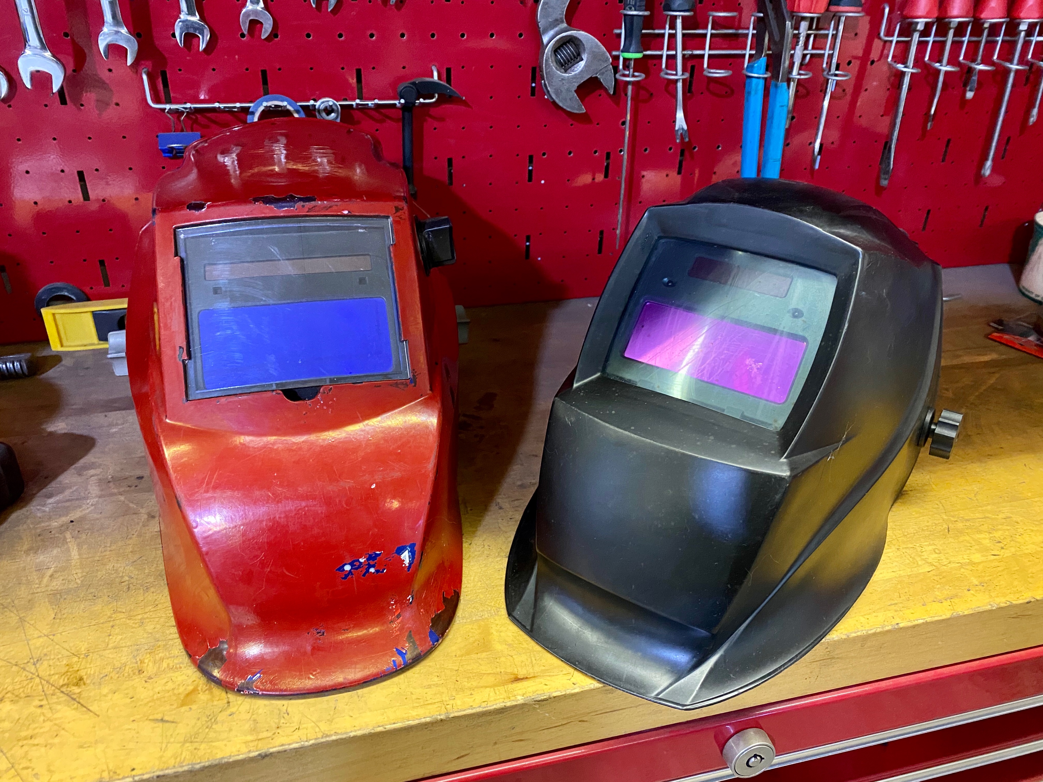

I just picked up these two cheap no name AD helmets today.
They both work great although I will need to fiddle with the shade adjustment on the red one when I have time.
So far I have only cleaned and disinfected them before trying.
Also can’t attest to headgear comfort but they both sat on my normal sized noggin okay.
I paid ten dollars for the two.
