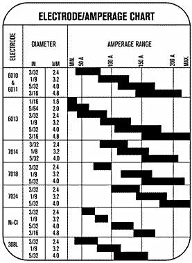

6013 is the easiest rod to weld with to me, 7018 holds well but you need to turn your heat up and it's harder to strike an arc with after the initial arc because the burn back of the rod in the flux. When welding the thinner stuff it's hard to do with a stick welder, there's a fine line between being hot enough to weld it and to hot and not burn a hole in it. Keep practicing, I been welding for 31 years and it's still cool to me. Mig welding is the easiest but more expensive, I stick welded for 10 years before ever migging and migging is so much easier. Stick is better on rusted or painted metal with a 6013 it will eat right through it whereas with a mig you have to have it clean etc.
Oh yeah I know it needs to be turned up for 70xx rods. I found this little guide about that:electrode_current_chart.jpg
I'm going to print that out and laminate and keep it near the welder. I figure I'll mostly use 6013 and use the 7018 for the heavy duty stuff.
