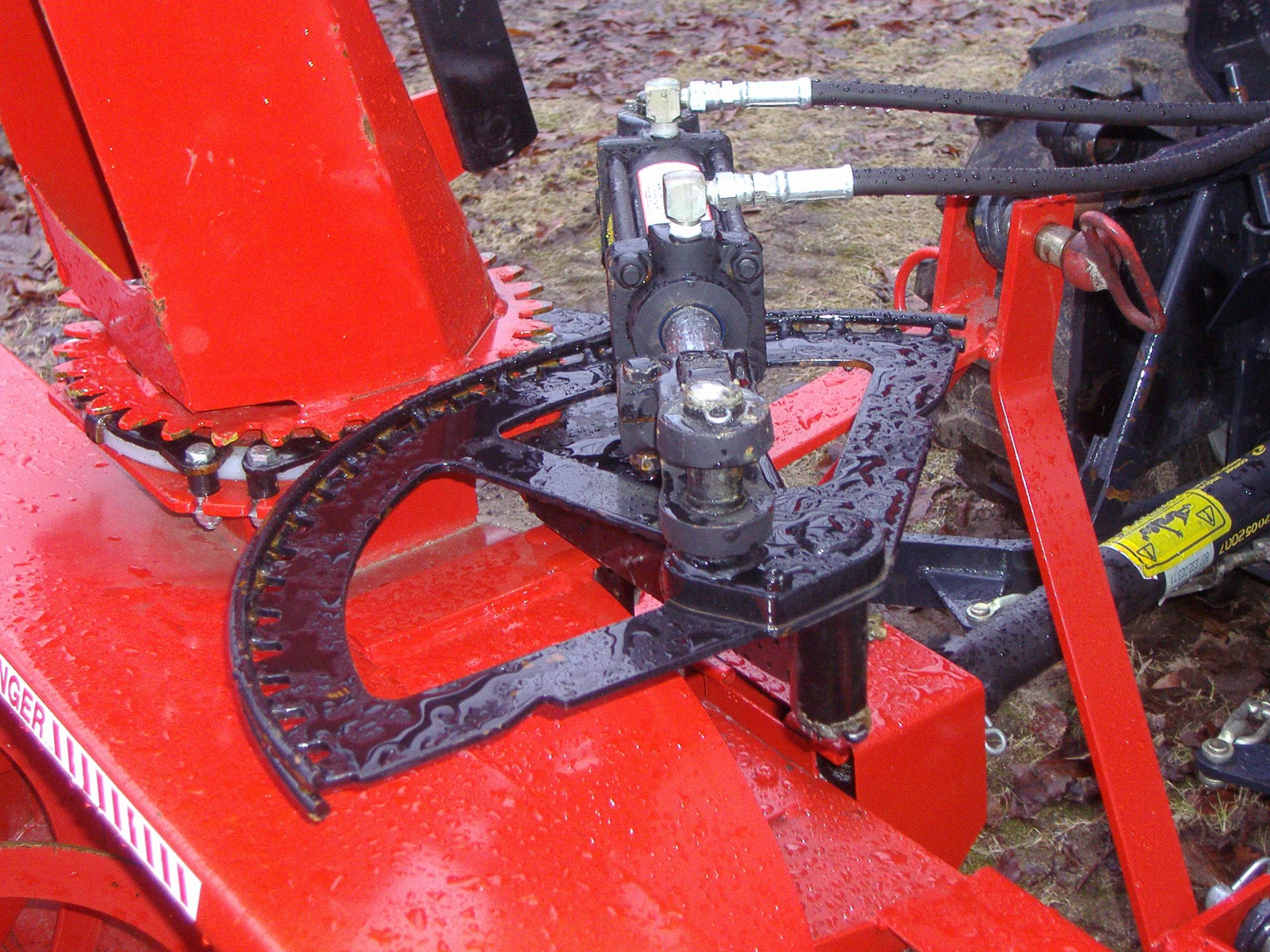

bobzap, that looks as good (if not better) as any factory set-up! :)
   / Automatic Chute Rotation and Discharge (AGAIN) #12
Yes, very nice. I don't have a deflector (yet) but my hydraulic rotation is the most confounded contraption I've seen lately. They took off the crank handle assembly and bolted on what looks like about a third of a wagon wheel with teeth on the circumference. A hydraulic cylinder is connected about two inches from the pivot point of the wheel, thus converting linear movement into circular movement.
It works fine, it just looks pretty goofy. When I figure out a new rig and get it built, at least I'll have some cool parts to build something else with.

   / Automatic Chute Rotation and Discharge (AGAIN) #15
Here's a picture of the contraption.

   / Automatic Chute Rotation and Discharge (AGAIN) #17
my wife says I should put together kits and sell them..
Bob, great job and your wife is correct. I don't own a snowblower but if I did I would certainly buy your product.
