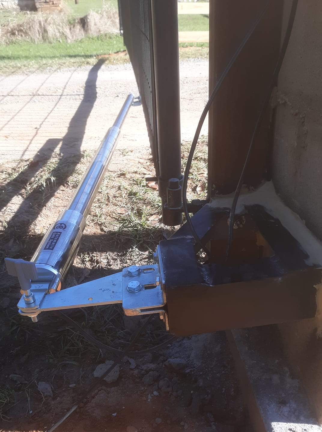

I looked at those brands before buying mine, but I wasn't very excited about any of them. Somebody on here recommended JSJ ProTech LLC
I called them up and bought one for my place. They guy on the phone was very helpful, and the opener arrived in about a week. Instruction where a little odd. Everything you added to it, like remote opener, had to be connected to the main control panel. It felt confusing to me, but I did manage to figure it out.
I've had it for a year now and so far it's been flawless. We only had snow once and I shoveled the snow away from the gate so it would open without having to push all the snow out of the way. We don't stay very cold for very long, but it was -8 one day, and we stayed below freezing for five days.
I like that it's stainless steel, and that it's a worm gear. I think the hydraulic cylinders wear out too quickly in the other types of openers.

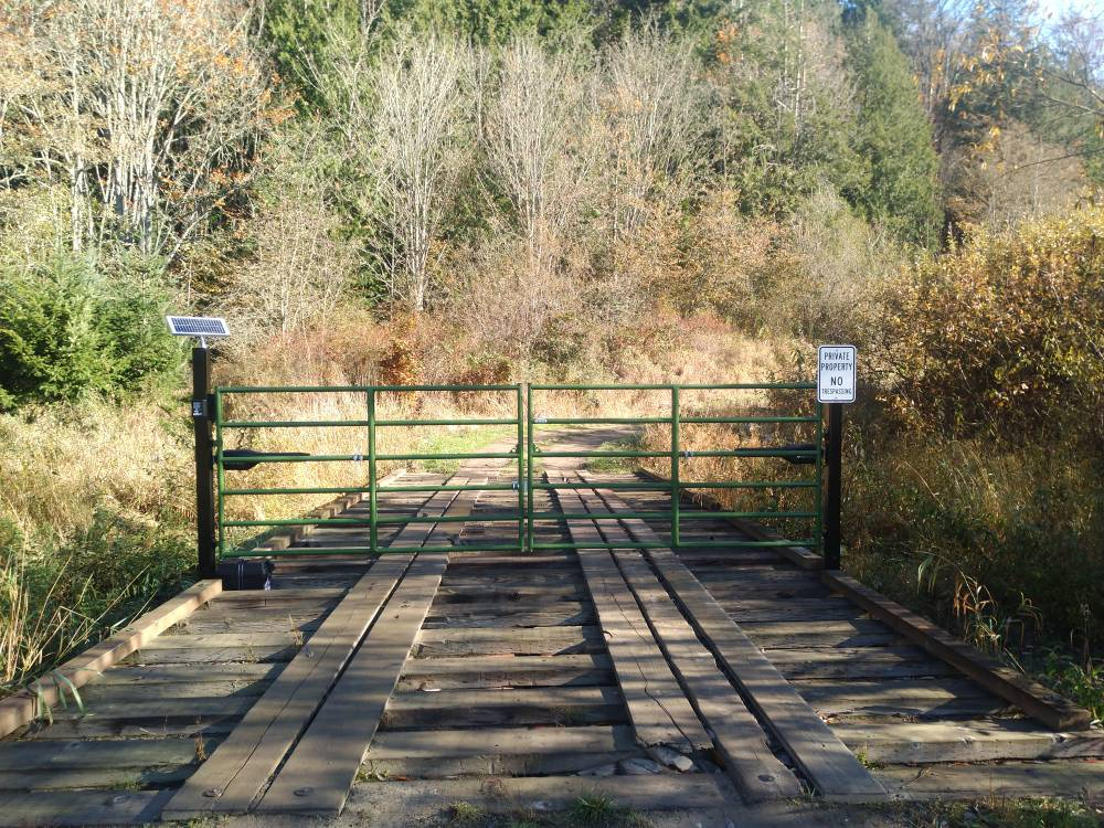

I used Ghost Controls, no problems so far other than if it closes on a car (or in my case a log processor) and safeties out it's a bit of a trick to get it to reset. Installation and programming was super easy. I used the small solar panel and the battery hasn't run dead in the year and half since I put it in (we live north of Seattle where it rains every day)...
We had snow and 6 degree weather here a couple weeks ago and no issues.

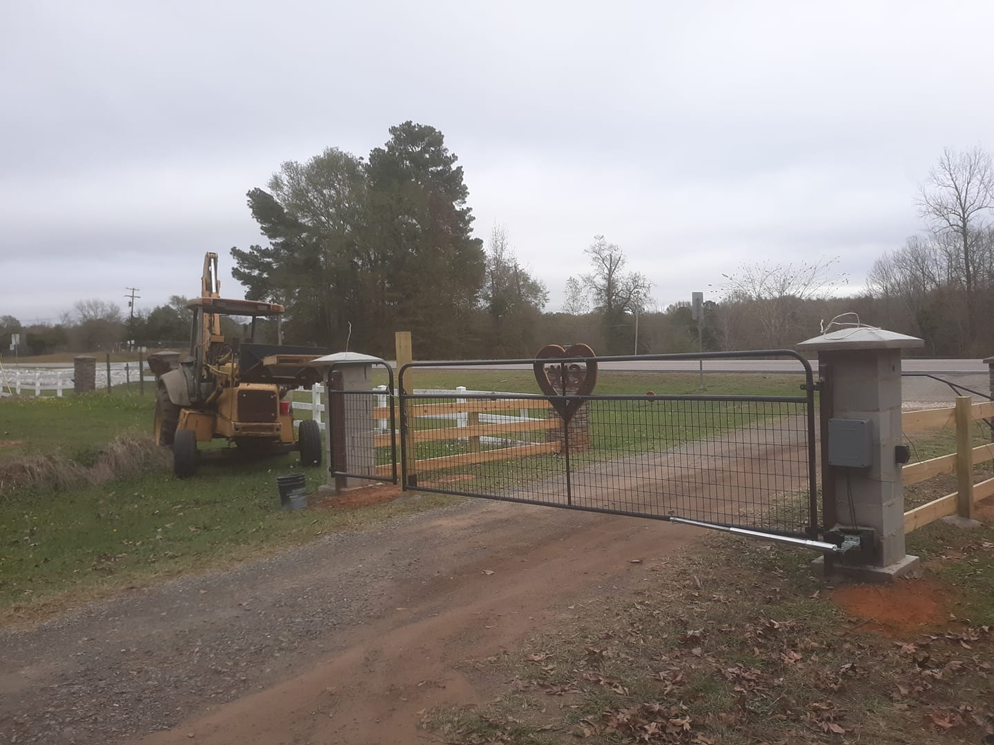

I’ve had a single (very heavy) gate opener called Patriot made by US automatic for about 15 years. It has been rock solid and is operated by a solar charged battery. The only issues I’ve had: two fuses have blown and needed replacement and I’m on my third battery in 15 years. The buried actuator that opens the gate when a vehicle exits shorted out due to moisture years ago, so we use key fobs in the vehicle to control the opener and also have pin pads mounted in waterproof boxes on either side of the gate. Considering how heavy my welded pipe gate is, I’m extremely impressed with this workhorse that continues to operate every day.

That's identical to the setup I have except it's a driveway and not a bridge. A couple questions
1. You have a latch between the two gates, is that the Ghost latch? If so does it keep the gates from being pushed open enough that a dog could sneak through the opening?
2. What size battery do you have and about how many hours of sun do you get a day? How many times a day is the gate operated? My location only gets a few hours of sun in the winter and I'm not sure I can keep the battery charged.
3. How far away will the remote operate the gate? Our house is about 200' from the gate and I'd like to be able to open it from the house if possible. If that won't work I'll have to either put in a keypad or a button so people can let themselves out. I can't use the driveway vehicle sensor because the tractors and mower will trigger it.
/ Automatic gate opener #11
I didn't use the latch, that's the 'butt plate' that comes with the kit. That said, even without the latch there's not that much play between the gates, maybe 4" at the most if you push each gate opposite directions. I did look at them when I bought my setup and they looked they would work pretty good but some of the reviews said they were pretty easy to open so they didn't really make the gate that much more secure.
I used a group 31 battery and a 10 watt solar panel, I ordered the 30 watt panel because where the gate is only gets sun for 4-6 hours a day but it's still sitting in my shop. The 10 watt panel keeps the battery charged just fine. The gate opens probably 4-6 times a day.
The remote range is only like 50 ft and the gate is a mile from my house so I used keypads. They're super easy to install, take a 'C' battery if I remember. They have a couple different modes which is cool, you can put in temporary codes and there's a way to make it open with any key press if you don't want to give someone a code but you want the gate to be closed.
