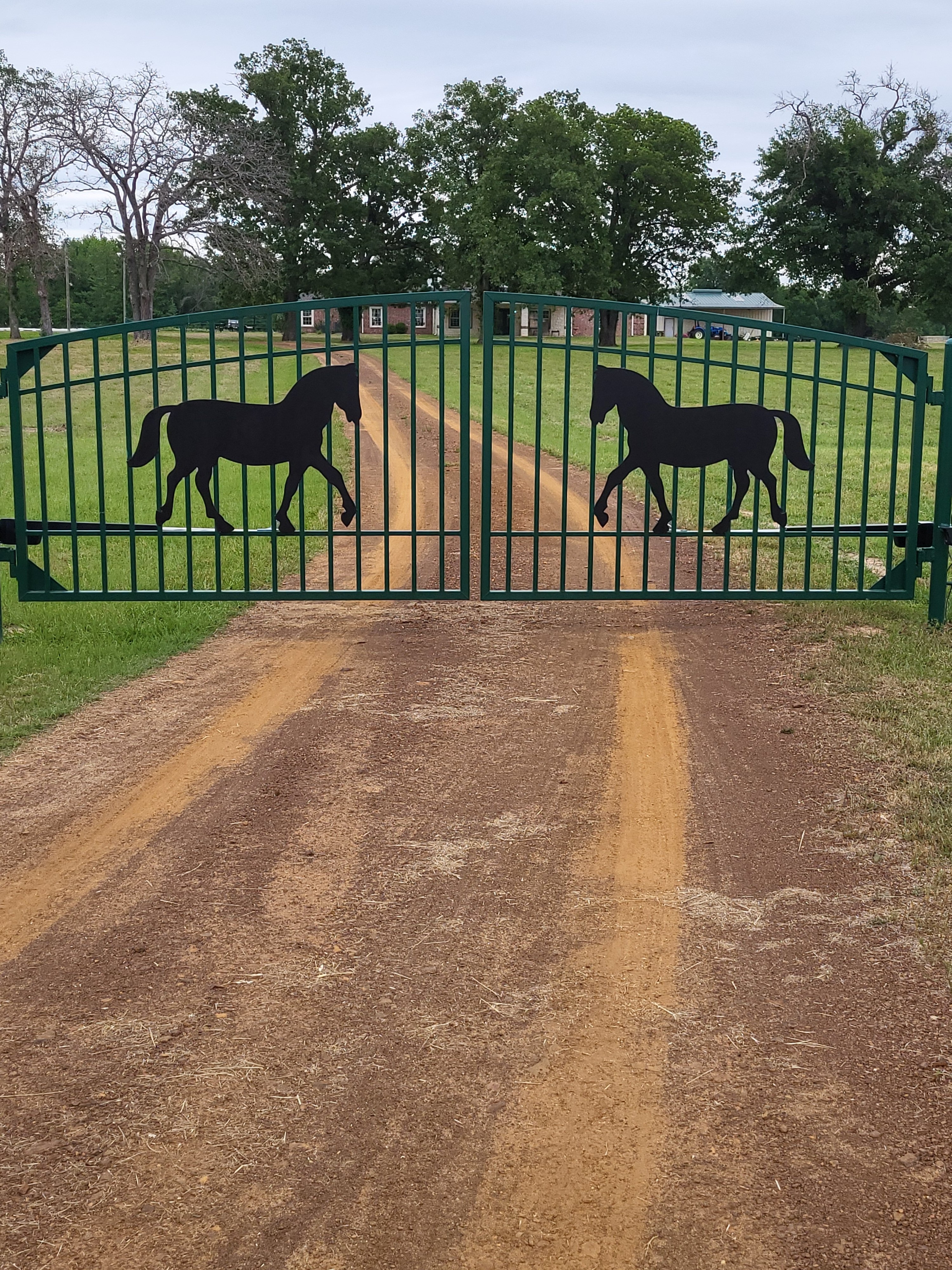

Had my gates custom made and used Nice brand openers. Solar powered with keypad and two driveway sensors.
