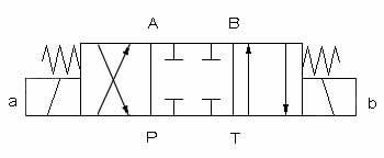

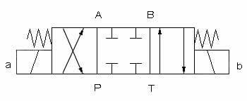

   / Aux. Hydraulics #18
This is a basic 3 position block to center valve . Valves come In different variations depending on the need. You have pressure, tank, a and b ports. Fluid flows depending on position of the spool whether solenoid or lever actuated, maybe this helps clear up some of your question. uploadfromtaptalk1488046809204.jpg
There are also manifold blocks that can be used to add more valves to a system. You can also stack valves to limit fluid pressure and flow.
