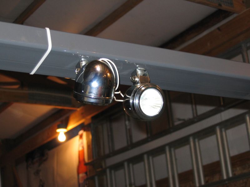

Not on mine. I just installed two 55W lamps under the ROPES on my new BX23. After reading here I measured the current load at the battery. The max alternator output I saw was about 14 amps. The tractor takes about 1.5 amps to run (no lights). Draw is about 6 amps with the lights on. The two 55w lights draw about 8 amps. All this means that with headlights and aux. lights on the alternator is maxed.
I plan on running only the aux lights or the headlights not both.
I was going to mount 4 lights but thought better of it after taking these measurements. I checked with my dealer on the upgrade kit and was quoted $312. Here on TBN the price was suggested to be closer to $165.
YMMV HTH

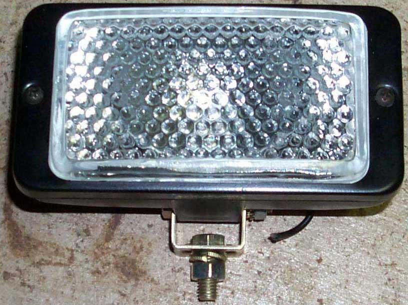

I just got back from the NY Farm Show. Bought a set of lights there for my canopy project, pic of one is attached. It is a 55W H3 bulb, so I guess I could downsize it to 35watts if I need to. Best part was -these are $6 ea. /forums/images/graemlins/grin.gif /forums/images/graemlins/grin.gif Vendor was Custer Products 1 800-490-3158, they are in Ohio. Item # for this light is S072 described as 3"by6" flood pattern. He had other styles available, gave me a 4 page typed product list. As I disclaimer, I am not associated with them.
