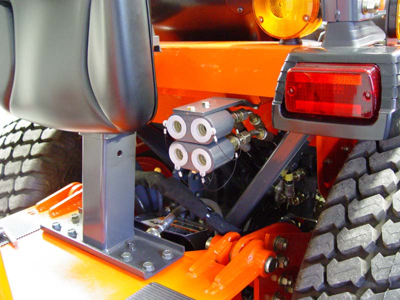

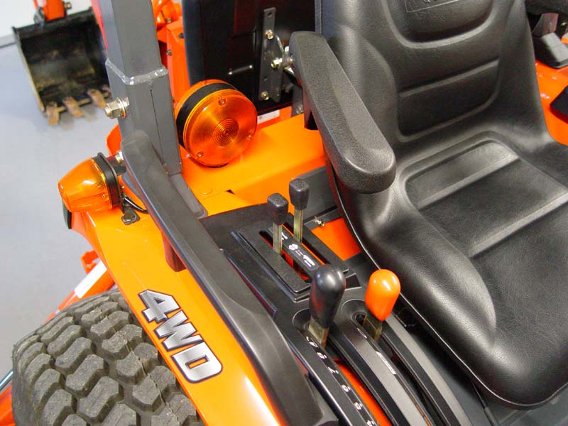

I was just checking to see if anyone had this option on there tractor. I was thinking about getting this installed to use for TNT. Is there a package# for this? It would be nice having the control handles mounted right behind the 3 point and cruise control. Also anyone know the cost for this option? Thanks, Jim

It cost me around 800$USD for two valves (no float because I already have an outlet for the backhoe). The float thing is: you have a choice to make whether you want your first valve with float or not. Must of the guys here on TBN will tell you to go with float. I didn't because I have a rear outlet for my backhoe so I can use that outlet for a log splitter for instance (the log splitter comes with a valve to operate it but you need a constant hydraulic flow... that's why the float option).
Here are two pics of my installation. I'll add those pics to my tread "candies for B3030".

The other one.

Thank You my friend. There are not any tractors in my area to compare this to. The pics are a real big help. I also have the backhoe so Im like you about the float. I will check with the dealer. I know they have to have a single part# for a kit. I also will check to see how much for everything installed. It will be a little while since we are in transition. I like to have all my ducks in a row before attempting an install by my self /forums/images/graemlins/wink.gif Maybe I can have it done before next spring if I do it myself. Thanks Jim
