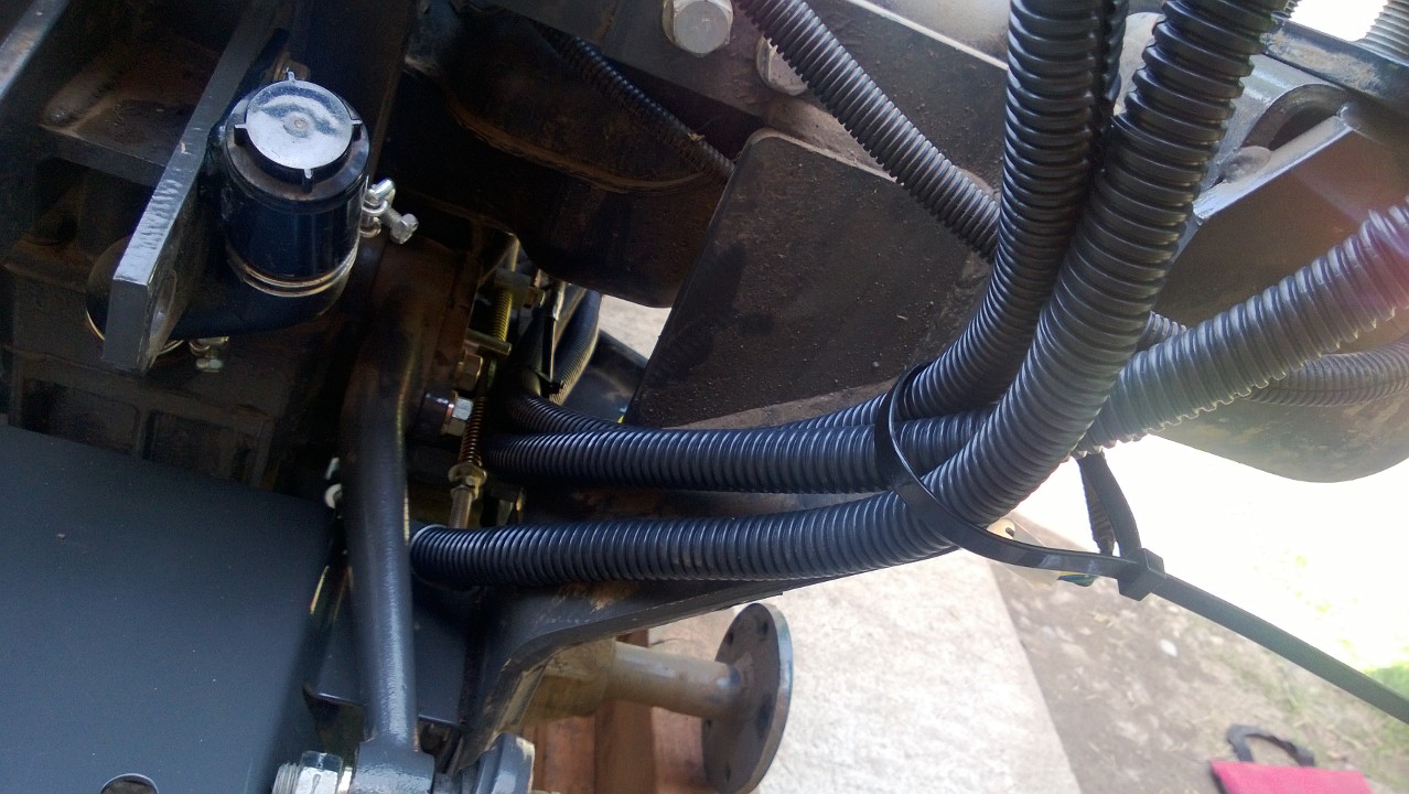

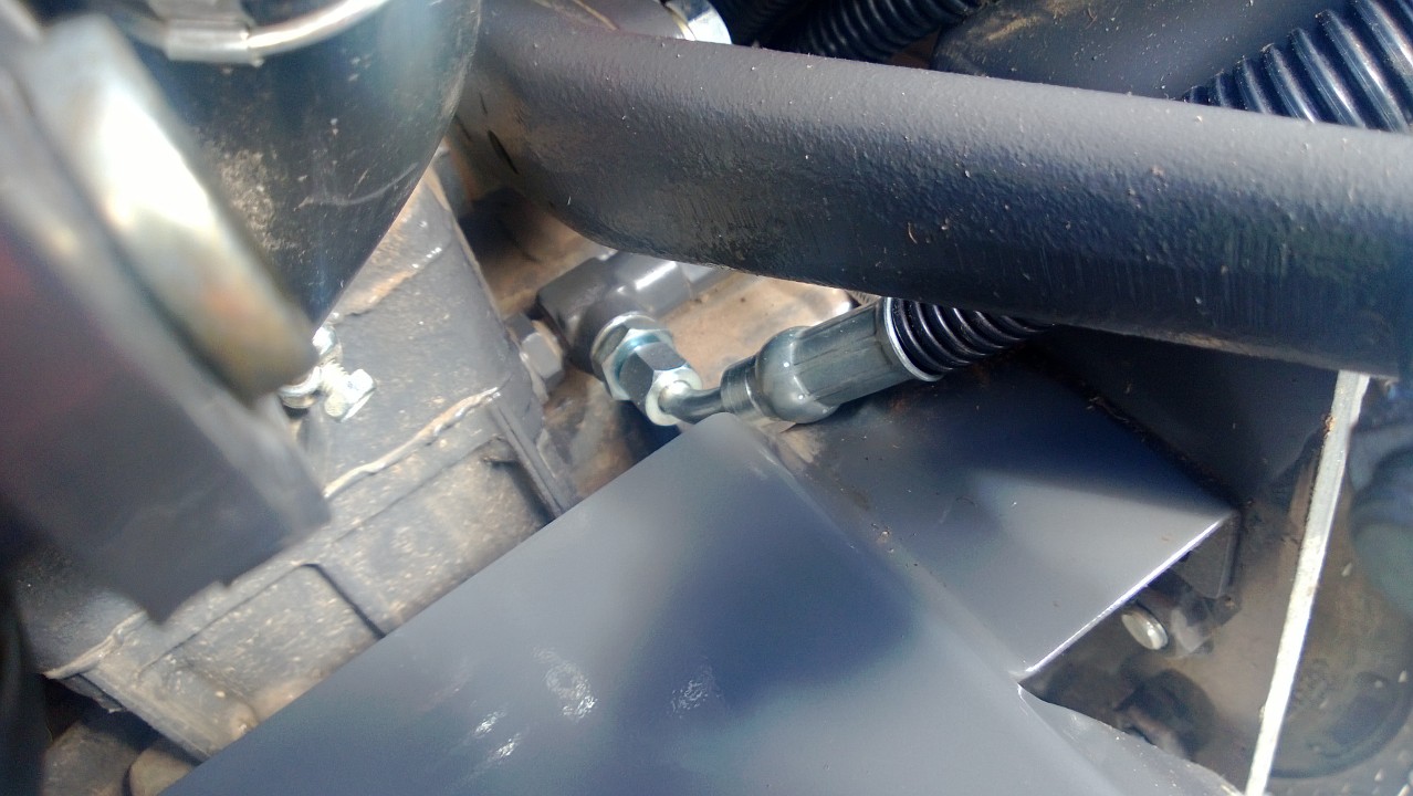

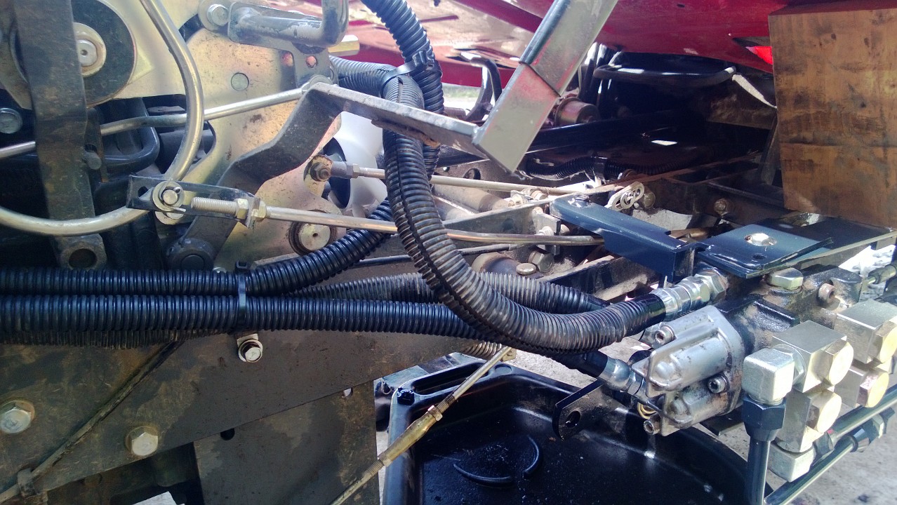

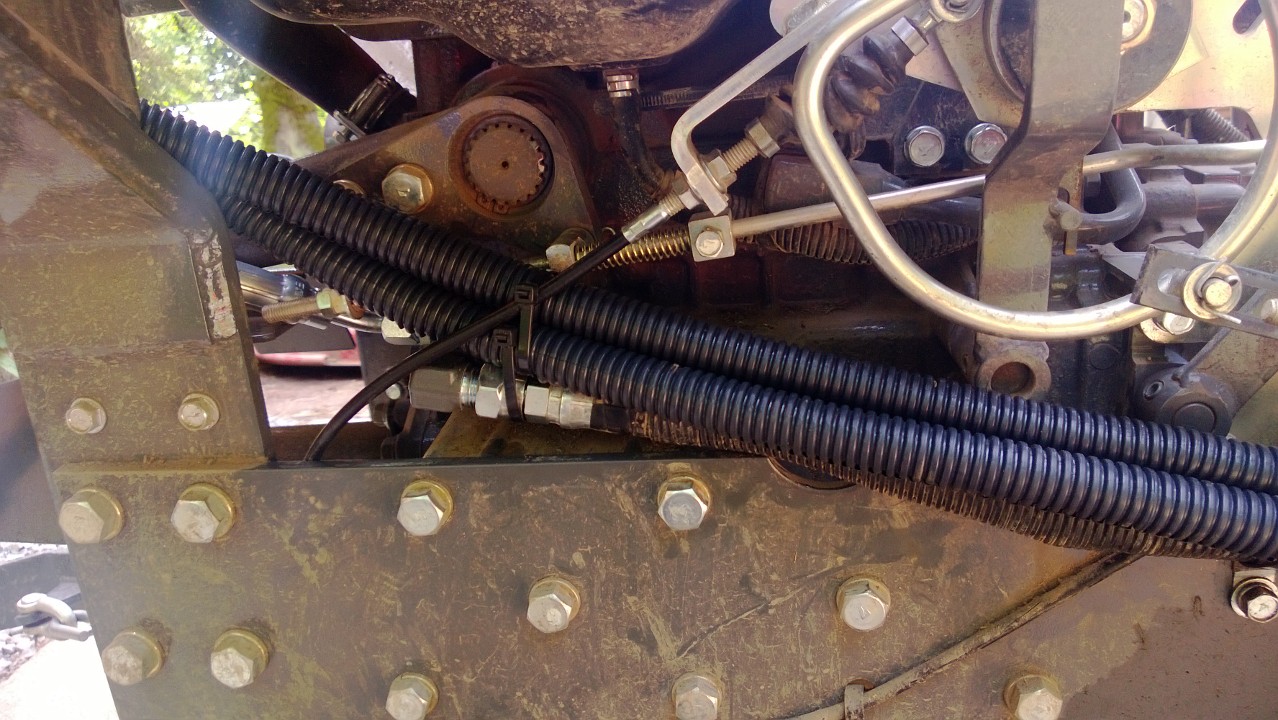

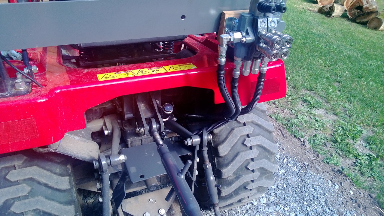

As you can see the valves are mounted on a wooden block, I've got to make that a bit more professional but haven't got around to it. I have since switched out the QCs from all females to one female & one male per port so that I don't have to worry about connecting my implements the wrong way:
Connection to tank using a 45:
Loader valve:
Wheel well:
Up towards aux valve:
I have since installed top and tilt cylinders from fit right hydraulics and the setup works really well.
