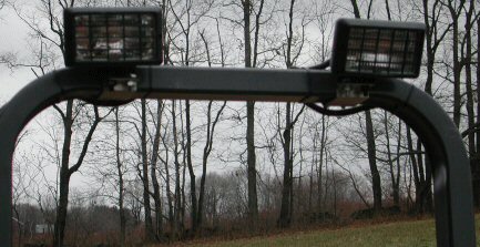

Here are some pics of the overhead light brackets and rear work light that I fabricated. Now I just apparently need the alternator upgrade.
regards,
Steve

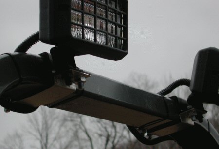

The Brackets are snugged with bolts around the ROPS and padded with foam weather stripping. I can shake the whole tractor just by pulling on the light brackets.
I also did not now about the auxilliary work light wiring. I tied everything into the rear lights so that they come on with the light switch. Part of the reason for this has been time constraints on my part. Perhaps next summer I will pull the apparently tough to get at dash off and add separate switches. The only concern with using the existing light switch is that it may or may not be designed to handle the extra amps of added lights.

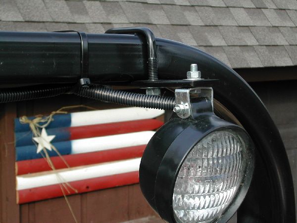

Turbo, I did the same thing Steve noted. Simply made two brackets from 3/16 x 1 1/4" flat steel that span the ROPS bar with enough overhang on each side to drill and run some 5/16" x maybe 3" bolts through. Countersunk one plate at each location to take a 1/4 x 20 x 1" flat head screw which connects the light bracket to the plate. I used foam pipe insulation sandwiched flat between the bracket and the ROPS. Same principal as Steve's top lights. You'll be lucky to find any light with a bracket to mount directly to the ROPS.
Steve, What, you going to play a night game under those lights? /forums/images/graemlins/grin.gif /forums/images/graemlins/grin.gif That's more auxillary lighting than I have and I'm thinking it's like daytime!!

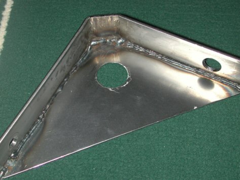

Rear bracket I fabricated from 1" stock in a vise, the weld a piece of 20 GA sheet on the back.
