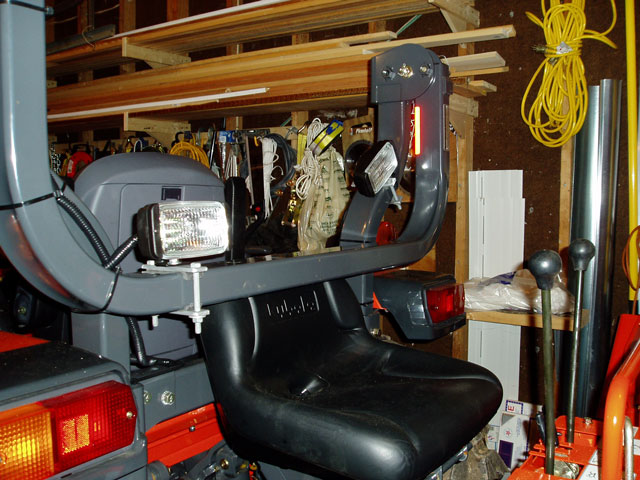

Finally got that digital camera. Here are the lights I installed. The locations seem odd but the lighting is very good from these positions. Better than if I did it symetrically I believe. As you can see the left light facing rearward is forward facing with the POPS up. Sure mitigates the FEL bucket interference with the factory lights. You can see the brackets that were fabricated to mount the lights to the ROPS. I'll try and post another closer shot of the bracket. This is my first photo post so here goes....
   / Auxiliary lights on a 3830 #19
Speaking of lights. I let the dealer install mine when I got the tractor. Even though they have their own switches, I have to turn on the headlights to use them?! That's an aweful waste of battery when I only need the rear lights. Is this the way the factory lights work or did the dealer install them wrong?
