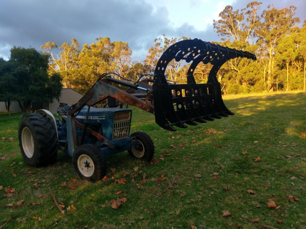

I have an old Ford 4100 that I spent considerable time and money rebuilding a few years ago, including a new hydraulic pump. Last year I overhauled the FEL, including adding a 3rd function, and this year I built a grapple which has been an absolute boon. When I bought the tractor, it came with a PTO-driven auxilliary power pack that had been used to power the FEL. It is essentially a big steel tank that mounts on the 3pl and has a geared pump inside it driven off the PTO. When I was overhauling the loader, I pulled the pump out and cleaned out the old milky oil and gunk, stripped down the pump and cleaned it out but it is, not surprisingly, quite worn. I decided to reassemble the unit with fresh oil and see how functional it would be.
I now find that, unsurprisingly, the worn-out pump lacks power. The tractor's own hydraulic pump lacks the flow to move the FEL and grapple at a good rate (I have remotes on the tractor so I can power the FEL when using the 3pl / PTO for other implements).
I plan to replace the pump in the auxilliary hydraulic power pack. I am seeking advice on what size pump would provide a suitable flow rate to give good functionality to the FEL and grapple. The old worn-out pump in the aux unit is, according to my measurements and an online calculator, approx 19cc per rev. I don't know what this equates to in GPH / LPM etc.

I figured out the required flow rate in order to roll the bucket through it's full rotation (about 220 degrees) in 8 seconds would be about 29 litres (7.6 gal) per minute (this would also close the grapple in about 2 seconds which might even be a shade too quick). I need to find out the gear ratio and a suitable speed so I can figure out what size pump will do this.
Info about what size pumps are on other similar setups that work well, is very handy to know in order to confirm I am in the ballpark.
The flow rating of the valve is a good point- would it be marked on the valve? I bought a new valve for the loader rebuild and to add a third function but it sat on my shelf for a few years and the sale info is long gone.

Thanks for the replies. I've figured out a few things so far; the loader spool valve that I have is rated to a 45l/min nominal flow; the pump is geared up at just over 3 to 1, i.e. the pump spins approx 3.1 turns for every turn of the PTO shaft. It is a DIN mount which means that a replacement pump with this mount style is readily available in various displacement sizes.
The tractor is rated at 45 hp at the PTO.
I measured the rams, the curl rams are 2.5" bore x 24" stroke and the grapple rams 2.5" x 6". This makes the volume to extend the curl rams 118 cubic inches, 1.93litres. 2 rams, 3.86 litres. I think a reasonable time to roll the bucket over (it rolls through about 220 degrees) is about 8 seconds, or 0.133 minutes, 3.86 /.133 makes it 29 l/min. That would close the grapple in 2 seconds.
A 25cc pump geared at 3.1:1 at 540RPM would flow approximately 42 LPM; given that, as stated above by Dave M7040, I don't generally run the thing at full noise, I'm thinking this would provide a good working rate at reasonable working revs.
If the 60hp JD2030 can power an optional pump with a 70LPM flow, I'm thinking my 45hp should be able to run 42LPM easily enough.
Am I missing anything? Does this all sound reasonable?
