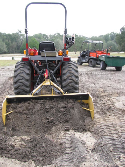

To me, being able to prudently push dirt with a Rollover Box Blade, with the tractor operating in reverse, is the best of several advantages to rigid, telescoping stabilizers.

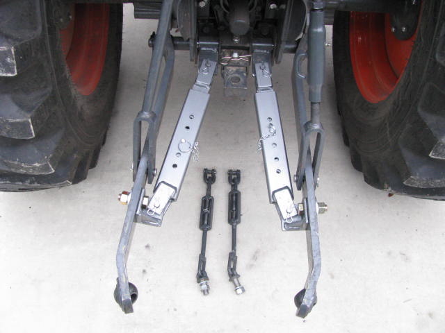

In PHOTO it is apparent how much beefier STABILWORKS aftermarket stabilizers are, relative to OEM Kubota turnbuckle 'chain' stabilizers supplied on my B3300SU.

I don't think "beefy" matters too much with stabilizers, as they are supposed to work only in tension. One side stabilizer should go into tension and check sway motion of the 3-point before the other side goes into compression.
If a stabilizer design, or a stabilizer installation, or a user's stabilizer adjustment allows one stabilizer to go into compression, then it is wrong and is transferring the wrong load to the lift arm and tractor mount. If a stabilizer bends or breaks in compression, then it's an indication something isn't right.
Look at all properly designed stabilizers, whether turnbuckle type or telescoping type, and you'll see they have a built-in relief design (often in the form of a knuckle, or a loop, or a chain link) that causes them to trip when put into compression and then become slack. When properly adjusted, this should allow the opposite stabilizer to carry a tension load.

To me, being able to prudently push dirt with a Rollover Box Blade, with the tractor operating in reverse, is the greatest of several advantages to rigid, telescoping stabilizers.
That should not matter -- the rigid lower arms control that, not the stabilizers.
