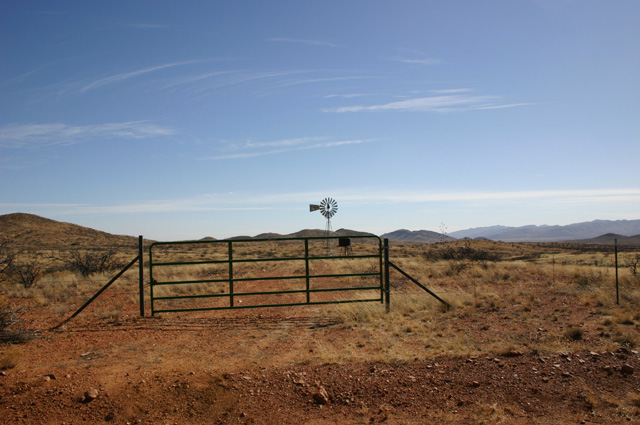

I also have several that use this technique of a 45 degree brace. These are metal post so it would be harder to do with a wooden post. Unless you have some reason to use wood I much prefer the steel post like these.

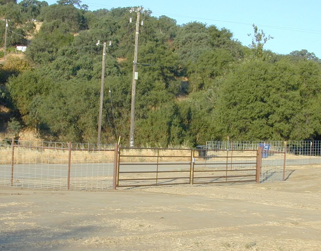

Though I've built plenty of wood post fences, I'm with the "steel crowd".
My new entrance is a simple looking "country" design (H brace). Gate posts are 3.5" sch. 80, support posts are 2" sch. 40, and horizontal braces are 1.5" sch. 40, all with welded joints. All posts set in sackmix. Gate hinges are fabbed from 5/8" bolts and drilled and tapped into the 0.30" wall gate posts. All post holes were slightly tamped then shot with my laser level then, all posts were cut in the shop to calculated length. Fine leveling of the 2 12' gates was to be done with washer shims on the hinges, but they didn't need it :cool:
