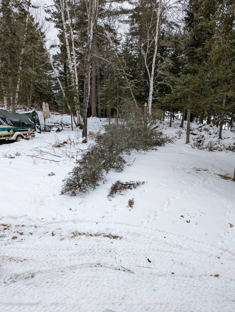

Looks like I have the first job lined up for the chipper this spring...
   / Awaiting my Woodland Mills WC68 #35
thats great. shove the whole thing in there on low speed and stand back and watch it eat.
