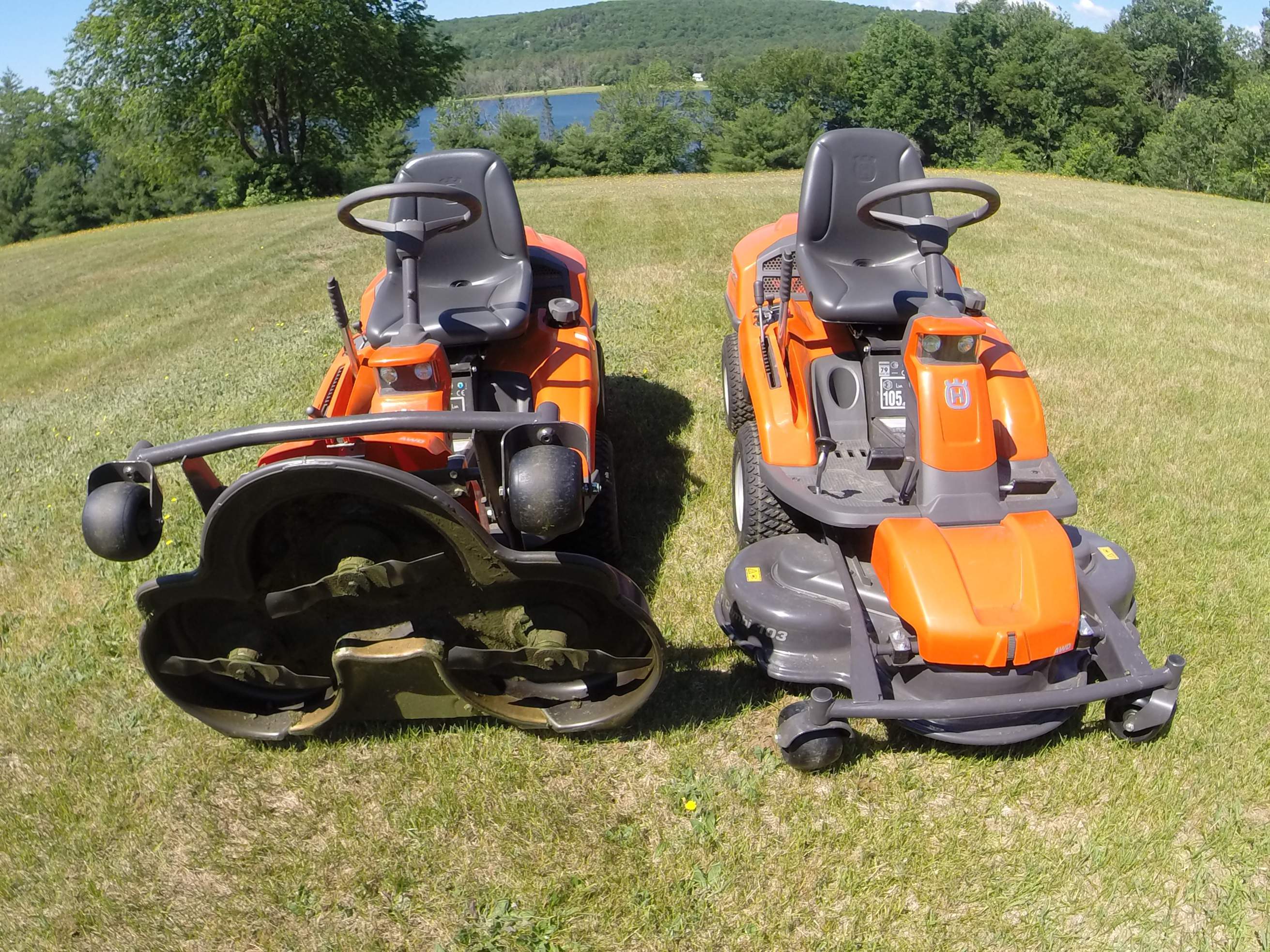

I really like my Husqvarna R322T AWD machines.
I use to have a Wheel Horse 416-H and a 414-8, both had mid-mount mowers.
In order to properly clean the decks of built up grass clippings, the decks had to be removed, then re-installed.
Easier to do compared to my sisters brand new Cub Cadet, but still a little cumbersome.
Needless to say, the mower decks rarely were cleaned out of built up grass clippings.
The Husqvarna R322T mower deck can be placed in service position in less than a minute, so clippings now get cleaned out after every mowing session.
The engine being in the rear means less noticeable engine noise and you are not driving through the engine's exhaust either.
Mowing with the Wheel Horse always seemed like a chore, but mowing with the R322T is fun.
The R322T can also power a sweeper, snow blower or flail mower
It can push a snow plow or tow a trailer, lawn sweeper, lawn roller, de-thatcher, or spiked aerator.
It only weighs 570 pounds so it's not going to put ruts in those soft areas of your lawn like some heavier GTs might do.
Articulating mowers like the Husqvarna R322T are very popular in European countries and other parts of the world,
but many folks here in North America don't know much about them yet.
