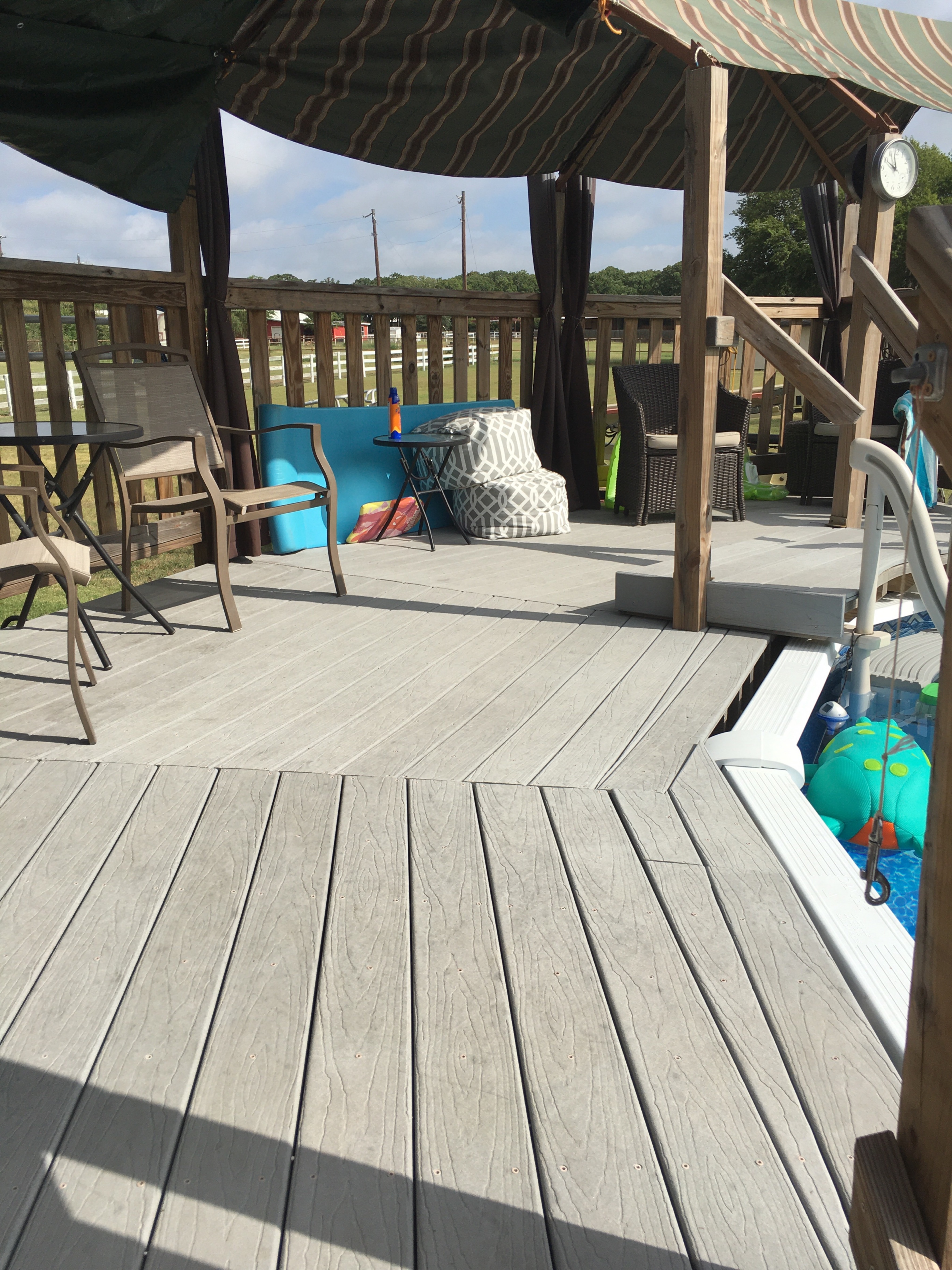

I wanted composite decking on my pool deck so that I wouldn’t have to worry about splinters. Before I started construction I looked at several other peoples decks and noticed that they all had sag in the span of the deck boards (all of the decks I looked at were Trex). they used 16 inch on center spacing. When I built my pool deck I used 12 inch on center spacing. I’m in my third season now and I’m very happy with the results. the only issues I’ve had are due to my own mistakes or the shrinkage of the pressure treated lumber I used for the framing.
I used Lowe’s ChoiceDek which is no longer available. I’m sure any composite decking you choose will be fine just pay attention to your frame spacing.
