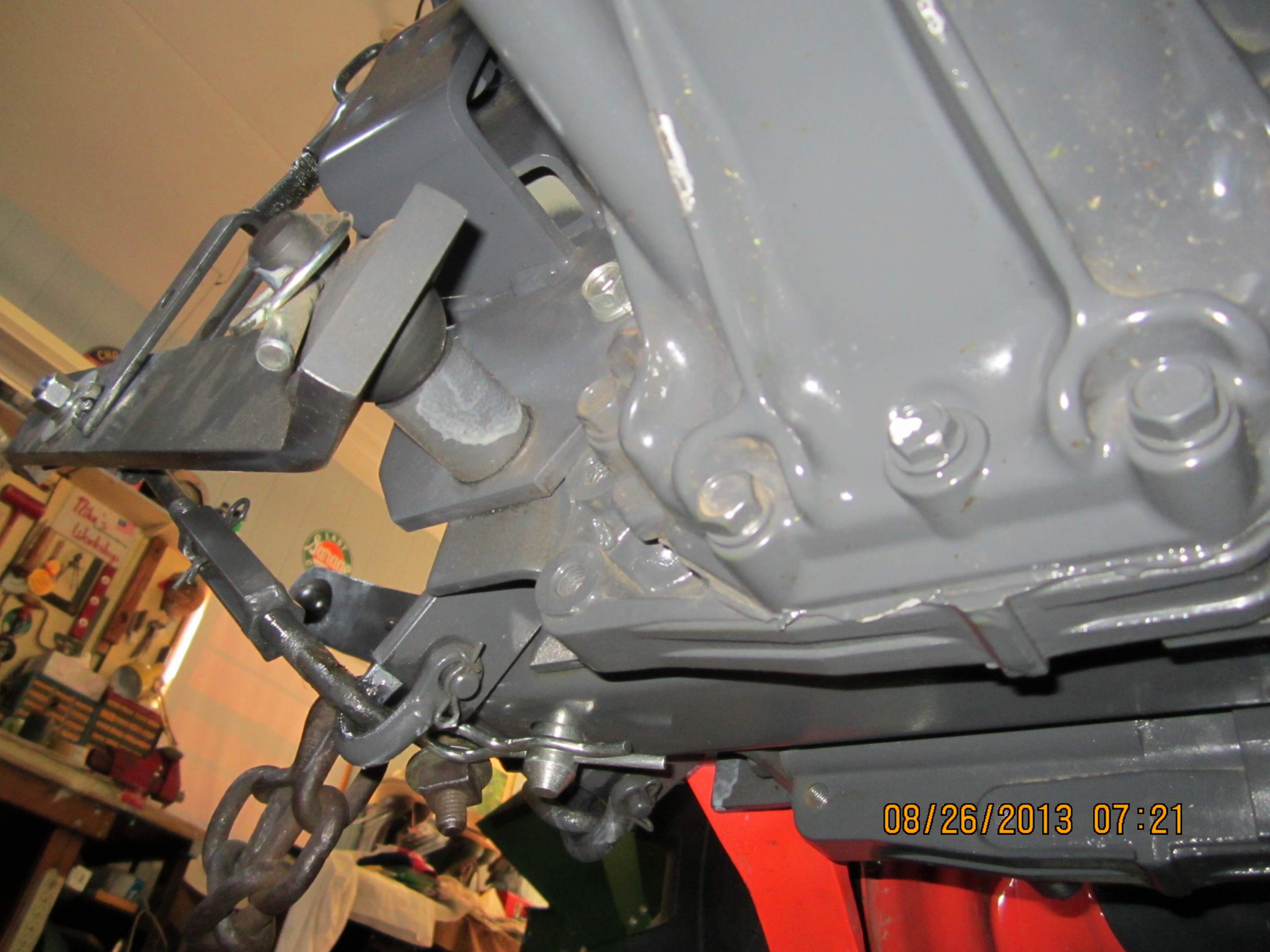

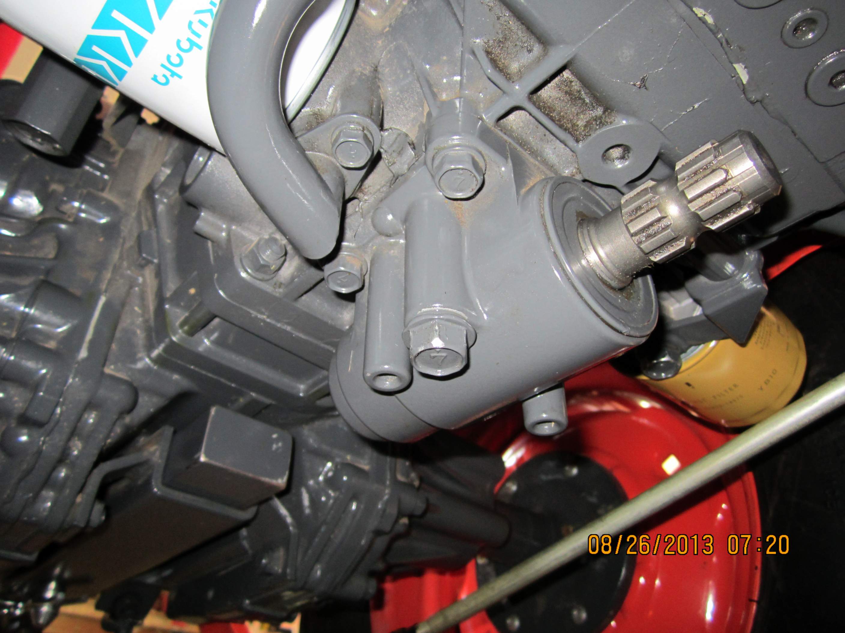

Okay so I tried the "Search Function". Forget that. In draining the HST filter oil outlet and the Hydraulic filter oil outlet, I get only 2 gallons. The book specifies the capacity as 4 gallons. So I looked for the other elusive drain plugs in the rear end. Let's see??? It looks like most of the bolts are holding the rear end together. Since I own a parts manual, I looked there to see if there is any identification of such. The manual show to likely bolts but calls them "flange bolts"...not drain plugs. Well I loosened one on either side and the oil does drain out. So the job is done. But the Owners Manual sure didn't help me much. Can anybody else confirm my expericence or tell me where I went wrong? Thanks.........Mike........Oh Yeah.......watch out for the little steel ball that is spring loaded on the HST side drain plug.

It sounds like you found all the drain plugs. I'm not familiar with the B2620, but on the B2630,B3030 there are three drain plugs. One for the transmission and one on each side of the rear axle housing.
Vic
   / B 2620 HST/Hydraulic Fluid Change #5
There should not be any spring loaded steel ball in the drain plug. You must have pulled out something else:eek:
You can tell the drain plug as it is centered between 2 mounting bolts and if you look carefully you will see it only screws into the outer housing and not both inner and outer. It also will have a brass or aluminum washer.

Thanks kuboman. I just studied the Owner Manual again, and really think I followed it for both the HST and Hydraulic filter drain plugs. I did find the ( one left /one right) axle housing bolts that are for drain purposes when I did the work originally....but they were not all that obvious to me. I took some pictures this morning and hope to struggle through to get them posted.

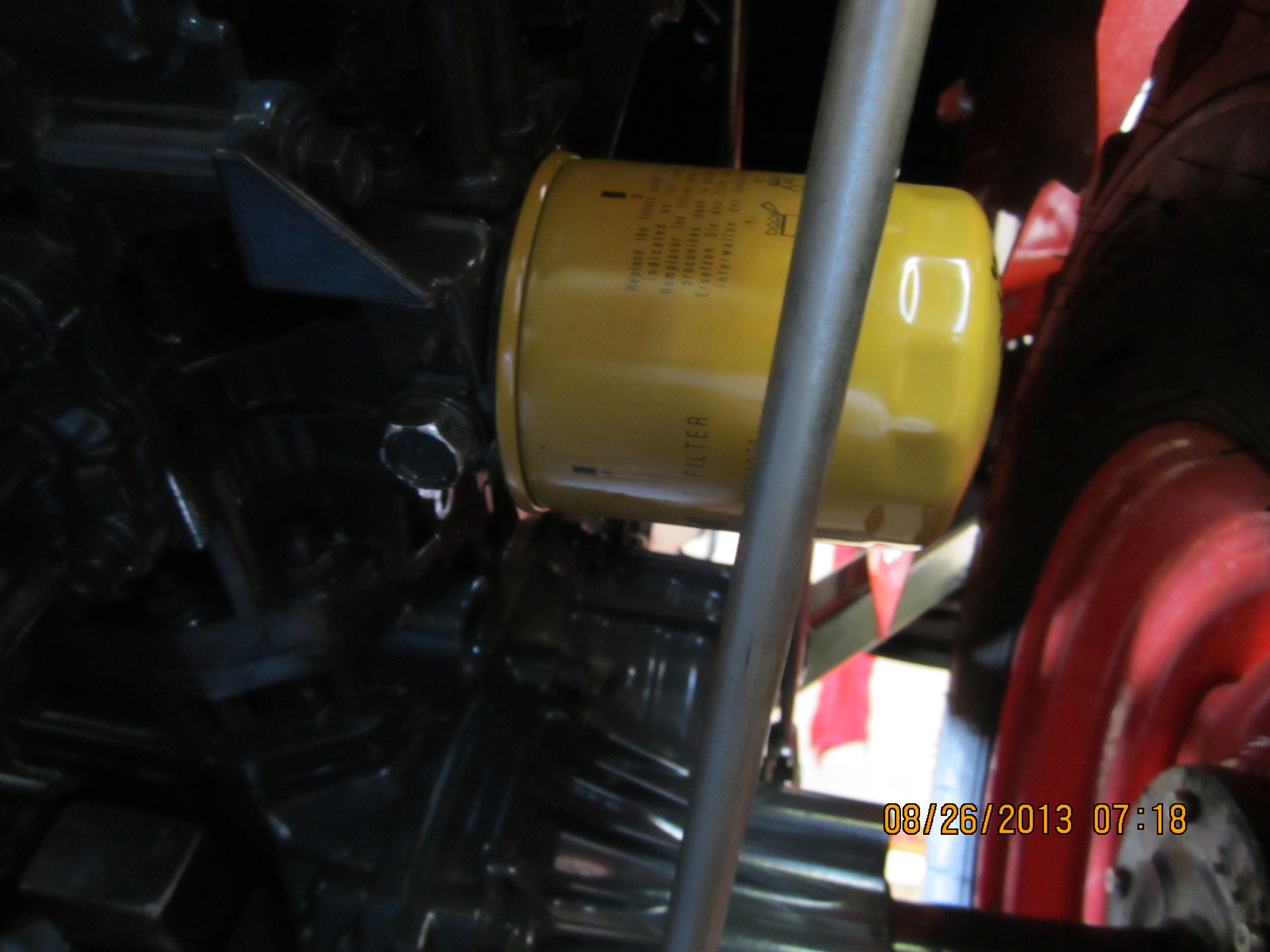

IMG_0673.JPGIMG_0673.JPGIMG_0674.jpgIMG_0675.jpg Well, it took longer to post these pictures than it did to drain the fluid. Apparently I was not suppose to remove the bolt at the base of the HST filter (the one with the spring and ball). So I stand corrected.....I did not follow the OE manual. Thus it looks like the bolt at the base of the mid PTO (17 mm) and the (12 mm) middle bolt on on either side of the rear axle case are the three that one removes to do a complete fluid drain. Am I stupid, blind or just hard headed. :confused2: Thanks everybody. Mike

So in your last 2 pictures there is a drain on your mid pto and the other picture the drain is the one between the 2 outer mounting bolts. Both sides are identical.

Looks like you found the right ones in the pictures. I believe you are correct that you do not have strainer. I thought my 3200 did not have one too because of the the 2620 I had before but discovered I was wrong with careful investigation and some smarter than me members here.:shocked:
