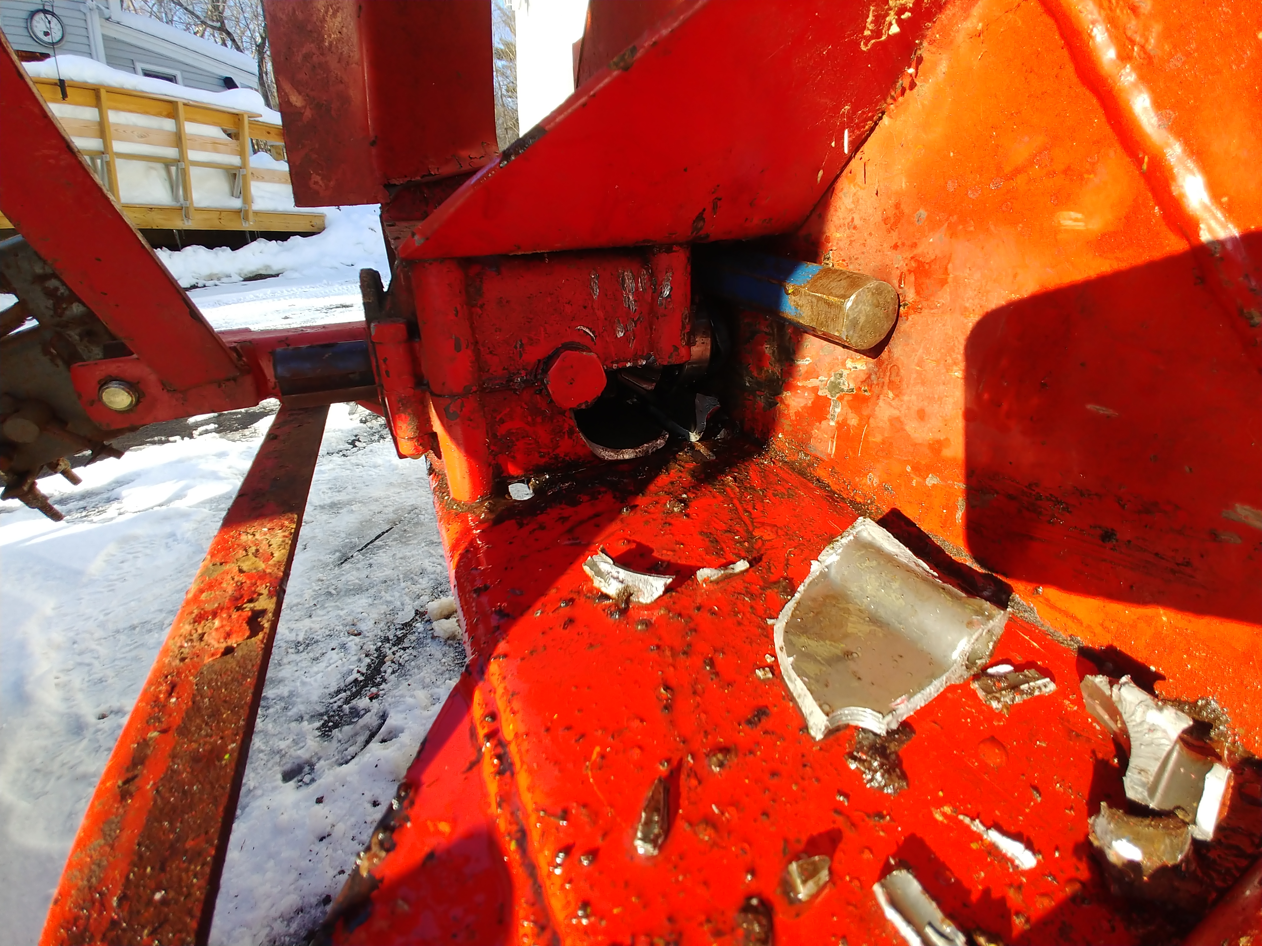

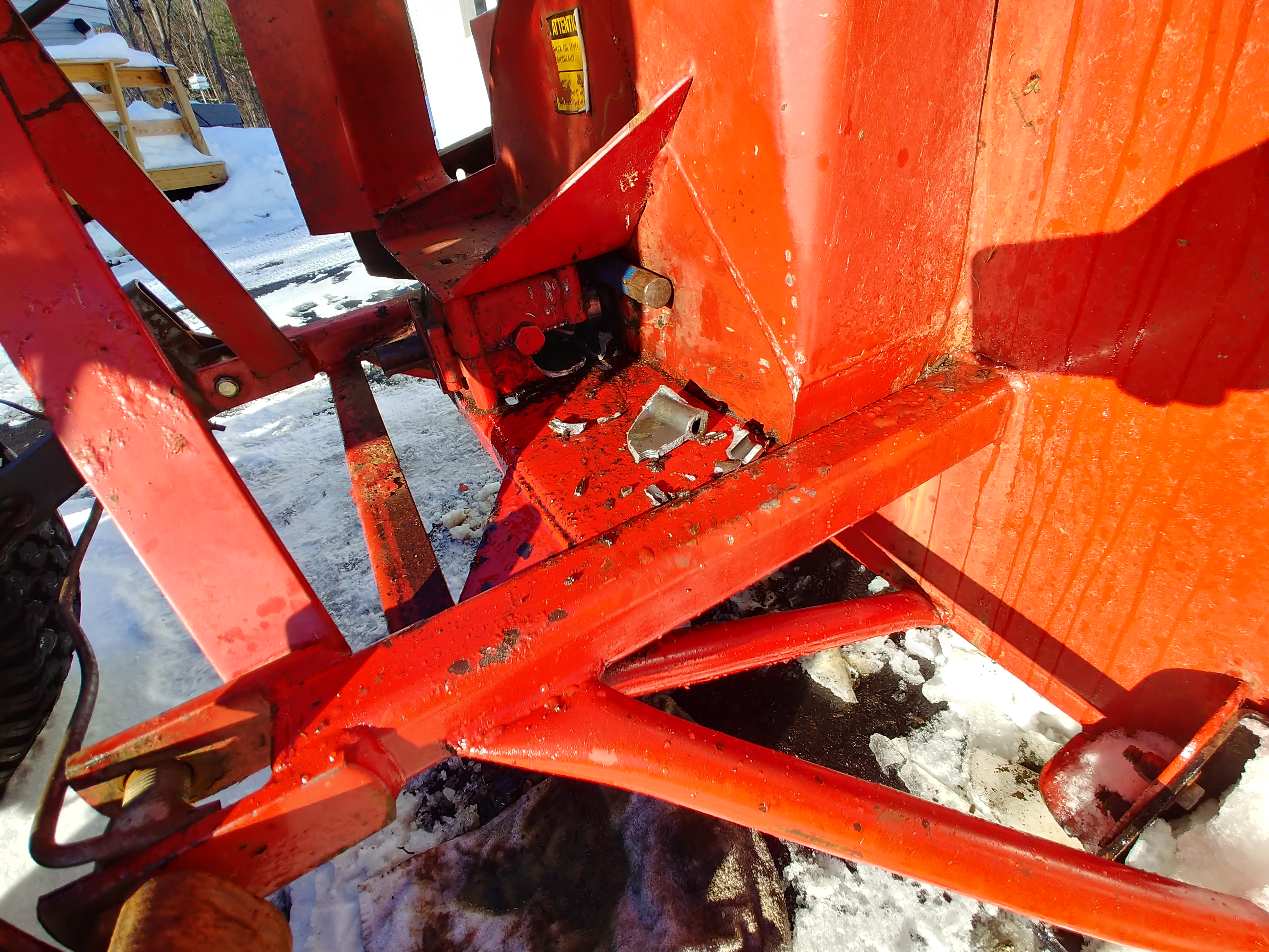

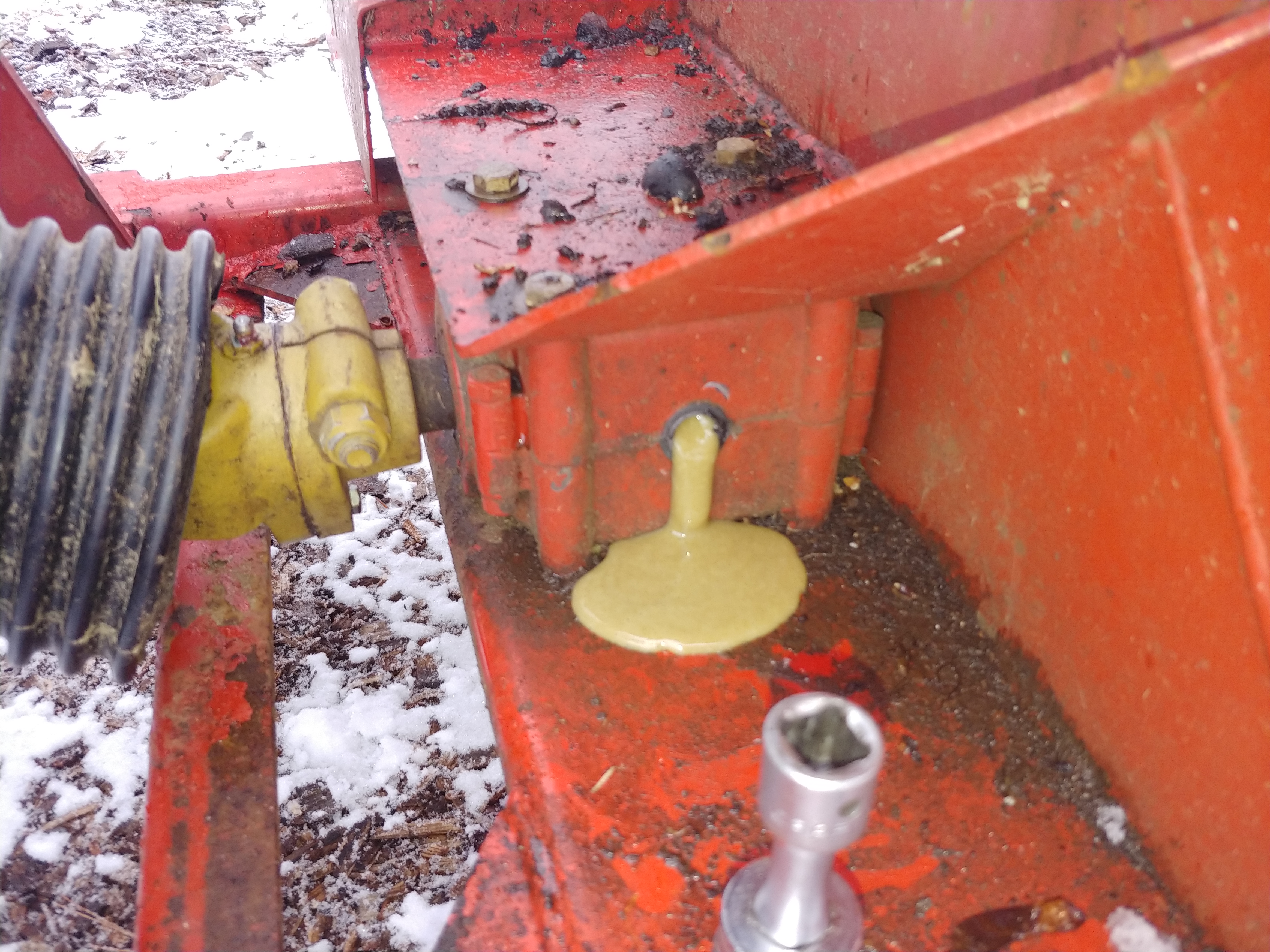

Well, I have run this set up for years and this is not the Usual noise. but you encouraged me to pull the blower shaft... all quiet... I think i found the problem....DOH

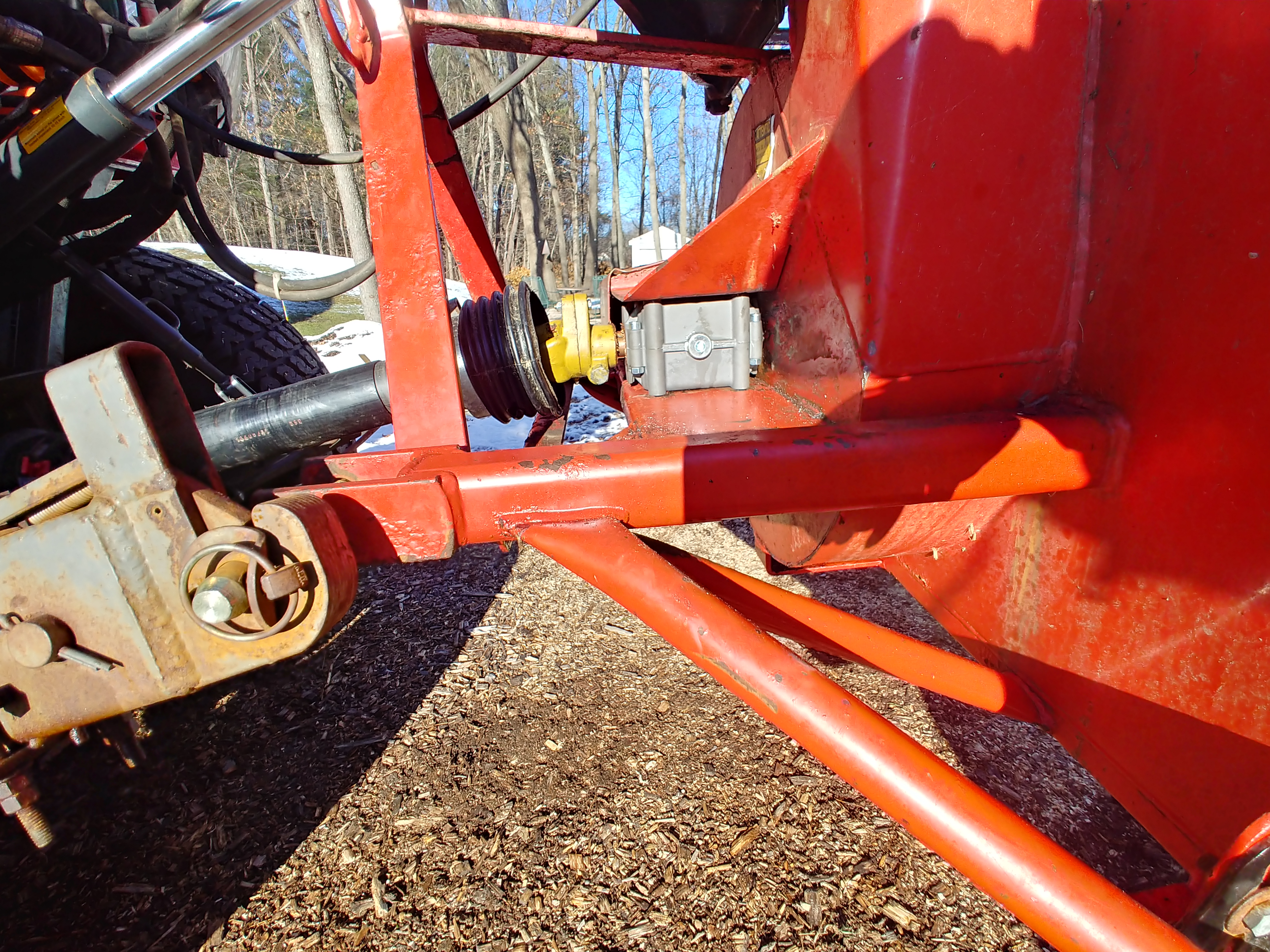

No Bueno.... Drained the snot, flushed the box with brake clean, refilled, and ran it, drained and refiled and still noisy... My stupidity... I thought about checking it when I hooked it up.... Ordered a new one from Canada... $430 :( , about a week to the dealer and then he'll ship it to me... he's 2 hrs away... for now i'll use the plow and pray for no snow...

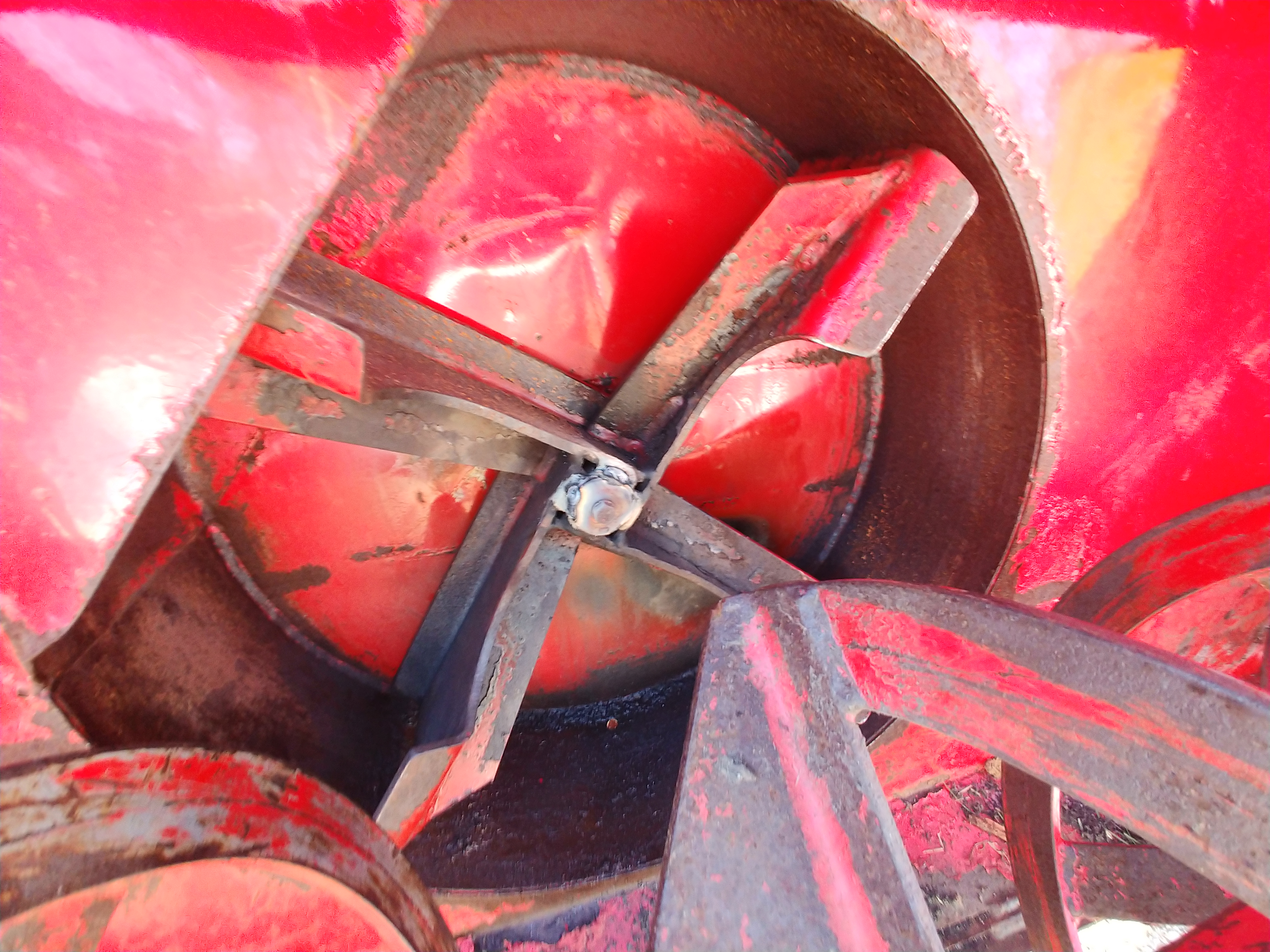

It fought me the whole way.... The blower is a 2007 and probably the original box and impeller, and the impeller was seized to the shaft..
No amount of heat, penetrating oil, or heavy hammers was breaking it free from the shaft....
Had to dismember the old gearbox to make room / access the shaft, and then with a $15 carbide tip sawzall blade, cut the shaft to pull the impeller...
Then a 20T press to push the old shaft out...
Reassembly was pretty smooth. A few swears... every nicely coated with neversieze.
After looking at the old gears, I wasn't entirely convinced this was the problem, but after firing it up, she purred and no more "turbo prop sound" from the assembly...
