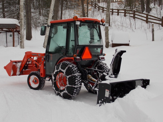

Kubota B3030 B 2.15 EM.JPGHoe,
I didn't mean to ignore you; I don't visit here like I use to--especially since Kubota discontinued my B3030 and added regens to their engines.
As I don't run a belly mower, I can't comment if it would work with spacers. I needed spacers to make chains work on my rear tires for the bad winters we've been getting lately. I would have been sunk without chains.

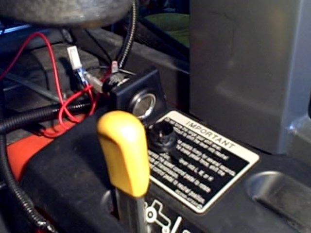

In my opinion, the side windows don't bring much to the party. Due to green house effect, you pretty much need the AC when it's over 70. Because the cab is so air tight, I hardly run the fan in winter for heat. I like an exchange of air and do leave the side window open, but the blower can send snow through the open vent windows at times. It's too bad they eliminated the side vent windows. It's too bad that manufacturers always look for ways to cut costs. One of my biggest complains about my B3030 was that it came with no 12-volt accessory plug. I purchased one from Radio Shack for $10.00 and installed it myself.
Good luck with your tractor.
