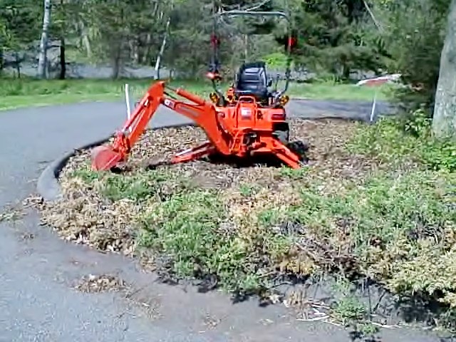

The rear wheels on my B2601 were loose with less than 10 hours use and they are standard non/adjustable 16.5" wheels. I caught it when I installed 2 1/2" spacers on the rear. (By the way there is no clearance problem with a 54" mid mount mower). Also cutting width is just outsde the wheel track.
   / B owners - check your rear wheels #12
My dealer mentioned that using the bh with the rear wheels jacked off the ground causes the right wheel to loosen. Don't know if that is true or not.
   / B owners - check your rear wheels #13
I've read that you should never have your rear wheels completely off the off when running the back hoe. They claim it puts a lot of stress on the tractor.
