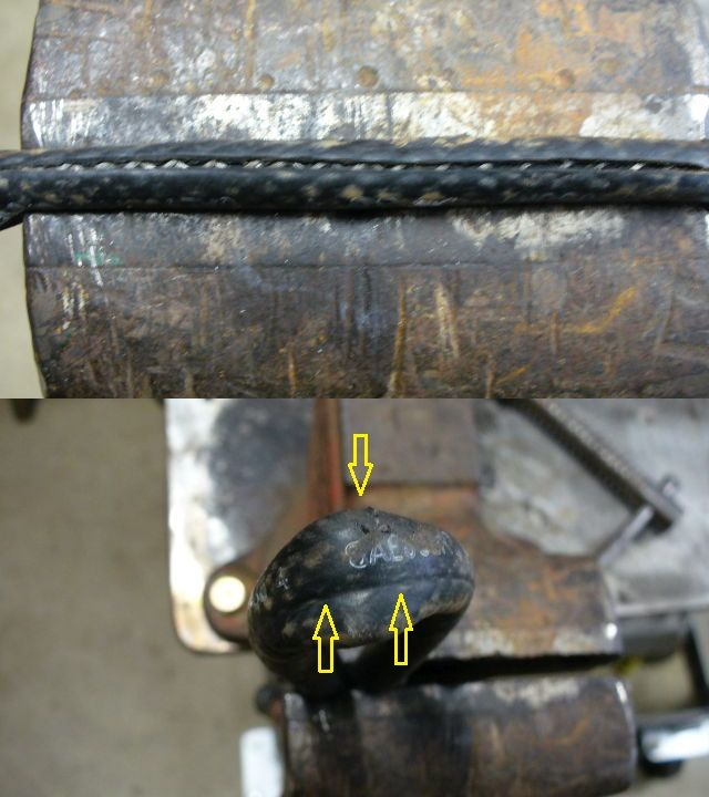

New fuel line on order.... Funny I could get 10 foot section of line with two filters and 20 hose clamps and with shipping was less than half the price of local auto parts.... Probably know early next week if it is the "fix"...

Only real problem has really been getting fuel to dry carb bowl after machine sets for a while.... That is why thinking bad fuel line (pin hole air leak) so pump has trouble creating enough vacuum to draw fuel...Runs great once started.....

Just may have found the problem.....Removed and replaced fuel line between tank and fuel filter.... Put a little air pressure to it once I had it out and yes it leaks...
