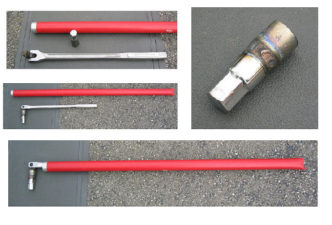

As an afterthought, I guess I should have included this photo , showing the tools I used for removal of the 17mm engine plug. The bottom of the photo shows the assembled socket / breakerbar / pipe extension combo that I used to extract it easily. /forums/images/graemlins/smirk.gif /forums/images/graemlins/smile.gif ..RayBee

Just installed a block heater in my B2400. Great instructions in this thread.
Just to add my two cents.
To get the plug out, I used a 17mm allen wrench and a cheater bar ( a 4 foot steel pipe) after letting the engine warm up. I did need to purchase a 35mm socket to tighten the block heater.
Approximate total cost for this modification $73. Cost breakdown follows: Block heater $45 at local Kubota dealer, 17 mm allen wrench $9 from Sears, 35mm socket $10 from O'Reilly Auto Parts, and 1 gal of premixed antifreeze $9 from O'Reilly Auto Parts.
