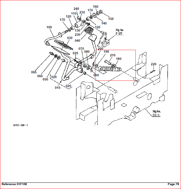

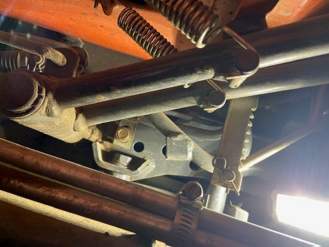

2006 B21, bought used. Getting around to addressing the funkiness of the FWD/REV (aka Speed control) pedal. According the the WSM pictures, the previous owner must have removed a part (after it broke?) and added a shade tree spring setup.
It DOES work, but not "great" as it sometimes does not return to "neutral" and needs a toe tap. Which sometimes causes a lurch into reverse for a moment. Not something I like.
The "damper" (part 180 in the red square) is missing entirely. No springs at all are shown.
It's a $100 or so for the part, I guess I would go for it, but need to be sure what I'm doing. I only have what is on the machine and the WSM illustrations to go by, which don't really help give me a clear picture.
Anyone with a B21 that can take some pictures of their linkage from various angles and post them? Do you have any large springs there at all?

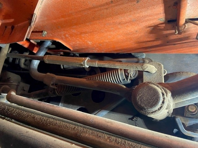

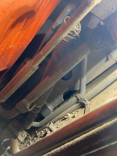

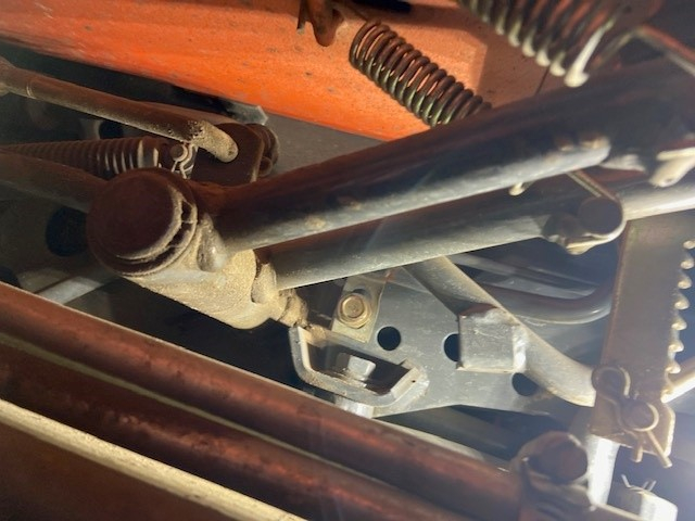

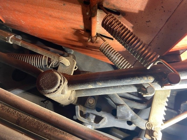

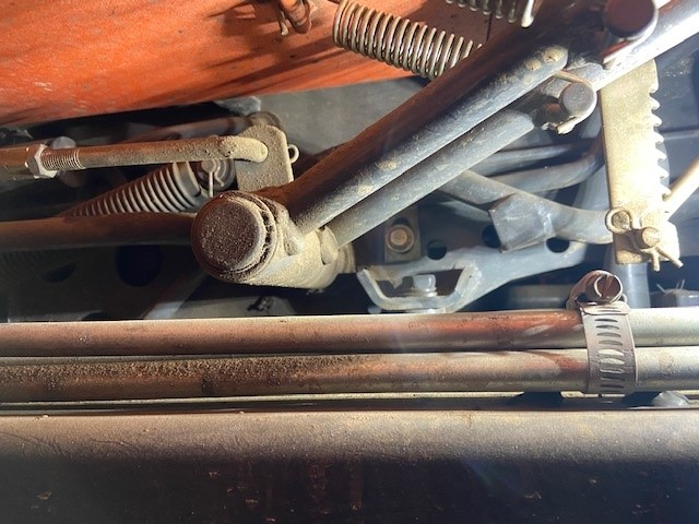

OK Got some Pics and Pic # 7 is the PN 180 is a single gas pressure cylinder I presume to retract or center the pedal.
OK thanks. It took me a few minutes to orient my brain, such as it remains, but have a better idea now what I might be facing.
Thanks much for your efforts.
   / B21 HST pedal linkage #6
Joe - NP - It's hard to get pics up under there -the cylinder is the centering/return as I see the mechanics of this - there is a lot of linkage (brakes) in the way and if you need some more pics of specific areas, I can try and get some in the day outside this weekend.

Not sure if the damper is to slow return to neutral if one lets off the pedal abruptly to act as a resistance to sudden changes in pedal position. Both?

It works in both F>R to return to neutral position. As soon as I leave off on the F pedal, it returns to neutral as it should. Never really had to mess with it other than lubing the mechanism.
