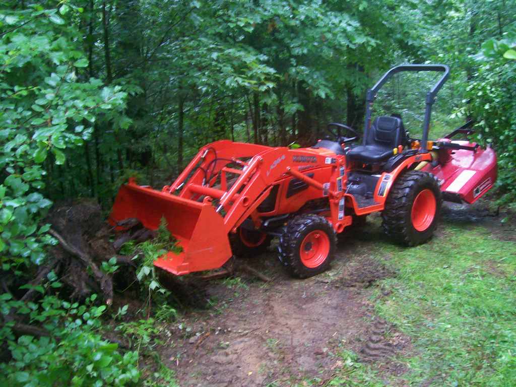

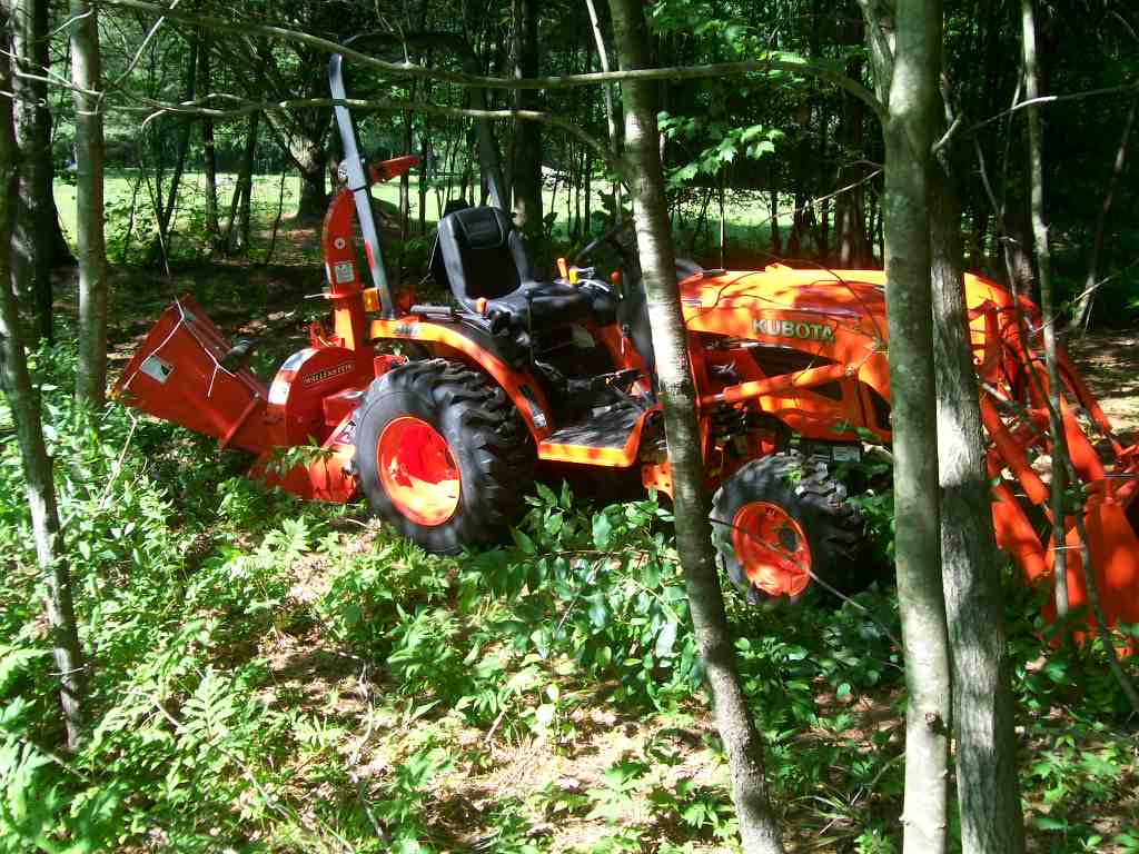

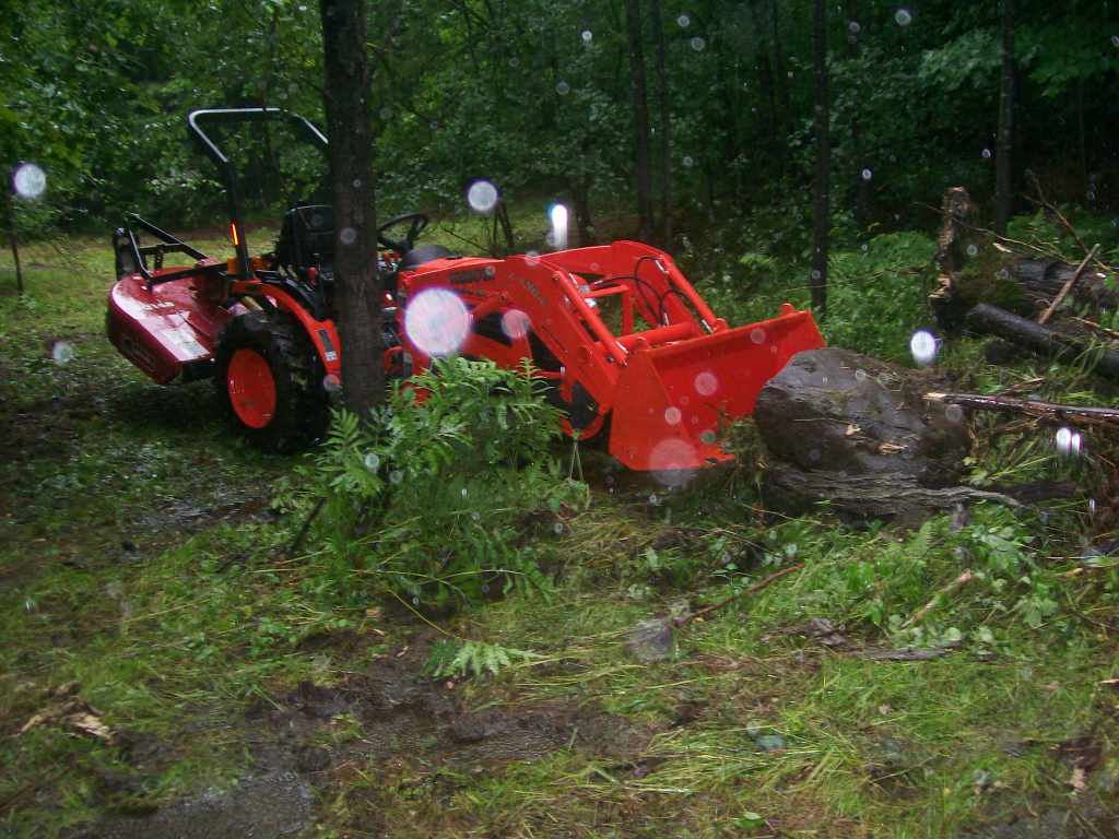

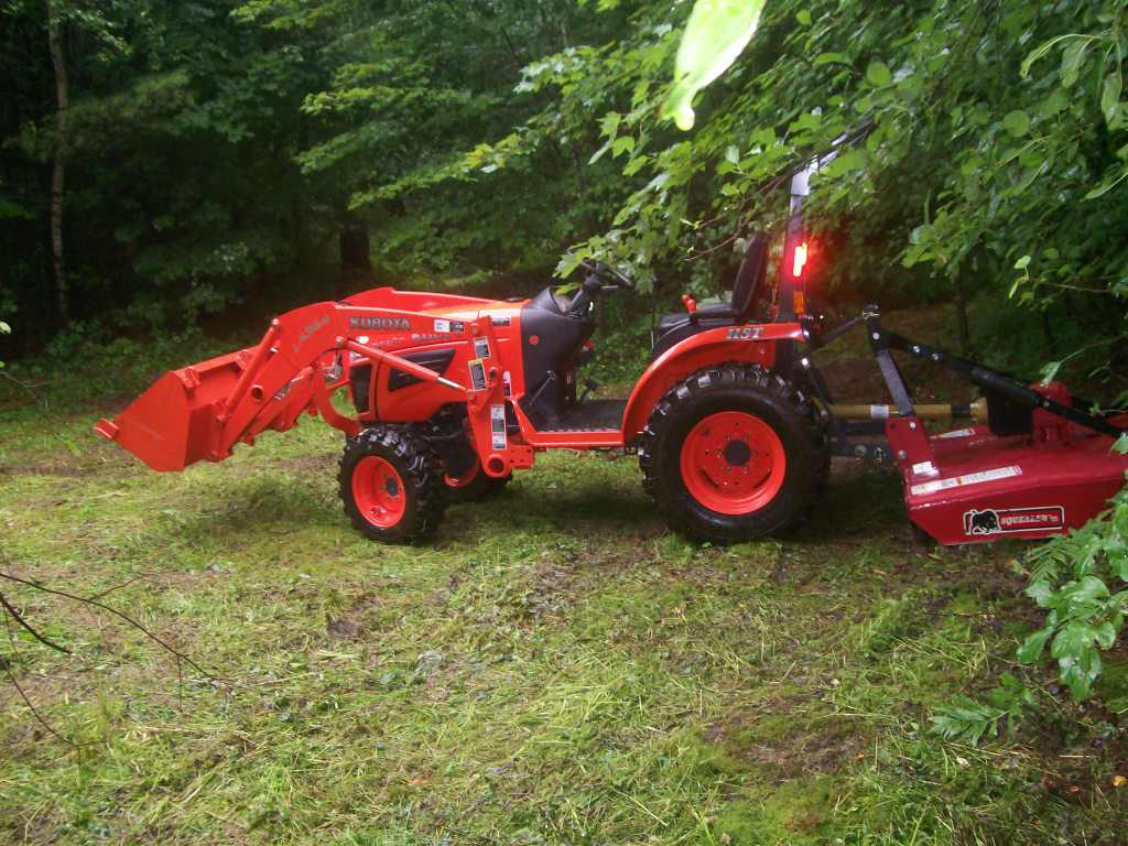

I have a B2620, and a 48" rotary cutter that I use to keep the woods from growing into my field, and on my trails, etc. It is big enough to be tight in places, and I might even consider a 42" rotary cutter if I were to do it again, but it works fine. I just take my time, and back into many places I can't drive through. You will want front weights if you take the loader off to make it smaller. I like that size tractor in my woods a lot. Sometimes I could use more weight, and sometimes I wish I had less, but it works pretty well.

   / B2320/2620 w. FEL/RM: turning around in woods? #7
if you have left and right break peddles. you may need to split them.
take tractor out of 4wd. if it is in 4wd / MFWD.
for sharp left turn. turn front wheels all the way left, and step on left pedal all the way. give it some throttle. and you should spin around on the rear left tire. for a pin point turn.
and do same like thing for a sharp right turn.
the raising of loader also works. though i tend never raising loader this high. or less it is empty bucket. a full bucket in FEL can take the saftey risk of a roll over even higher.
don't get me wrong, i have been in situations were i had a full bucket of dirt, on a hill, it was muddy and soft ground. and hitting left brake peddle and turning front wheels all the way to the left. plus had a few bumps to go over. but i would not recommend pushing your luck. i slowed a good amount and hoped nothing went wrong when i did it all.
i will still do above any time i need to. but i have had to do above so many times that i no longer remember most of the turns. and i slowly built up my ability to do above. and learned as i went.

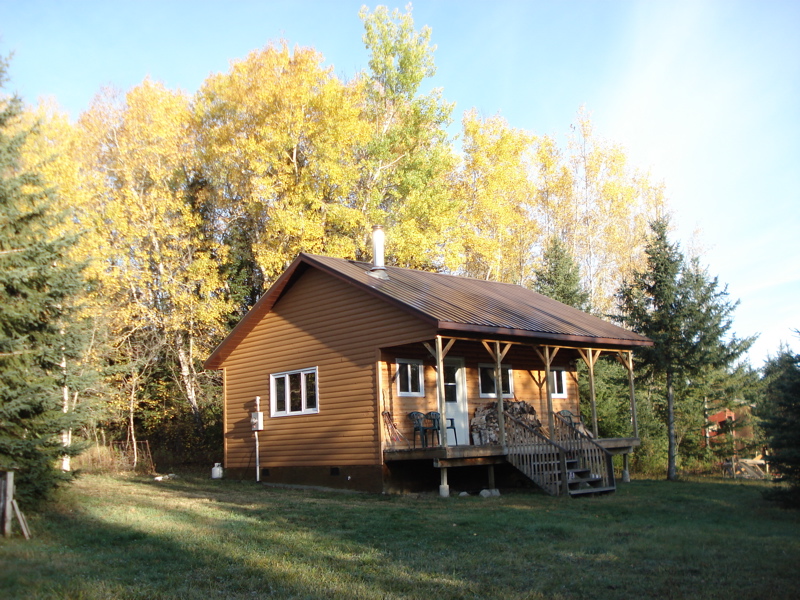

Thanks guys. Have worked this raw land since 2003. It's in NW Ontario a long, long way from my home & I started w. weeks of chainsaw work then weeks of Stihl hand brushcutter work & finally got to where an ATV + tow RM could get in there but decided I'd better get a tractor before I collapse. My 'working quarters' are so tight that I'd really like something like a BX for more agility but it is woods & as I've hung my ATV up on unforeseen logs etc. dragged by bears into my 'trails' think I'd hang up a BX the first few hours.
I've done the brake turn thing w. gear tractors in fields but think I'll do mostly back/forward in the woods so I don't smash a tractor part.
Appreciate the replies & now to post on Trailer subforum to get some ideas there as I try to finalize the order. Here's some pics of why I go there. The cabin sits in the only 'clearing' I've got on a total of 330A. The buck in the sled shows the land I cut behind it = cutover + tag alder + plain old bush. I've cut the bigger stuff already w. saw so mostly 1" saplings plus 6' high bull rushes etc. each year.
