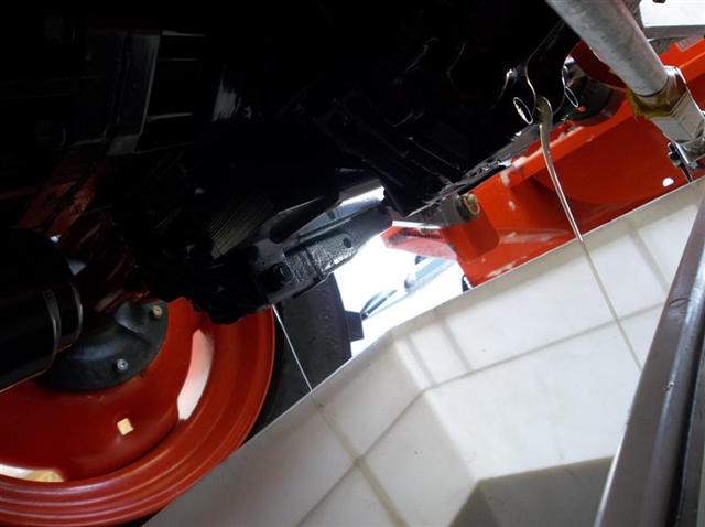

It's very simple to do your service. But the owners and shop manuals don't give very precise details or pics. Here's what I found for draining the trans/hydro on my B2620HSD. Pic #1 is what both manuals correctly show.

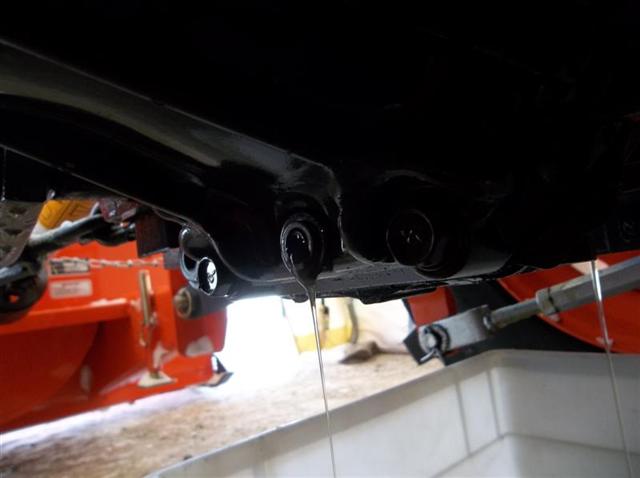

Pic#2 is the 12mm I removed which is a gasketed drain plug. Manuals show you to remove the 14mm housing bolt which is just ahead of it.

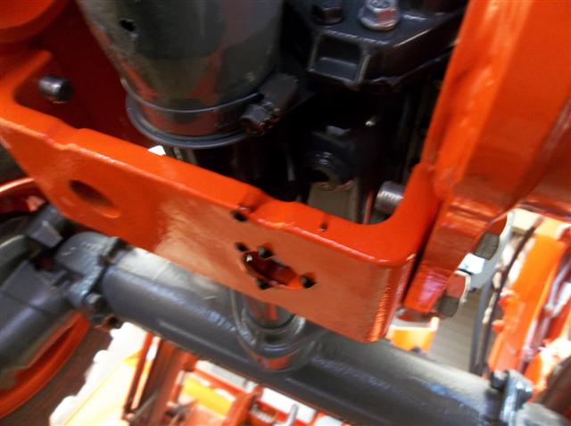

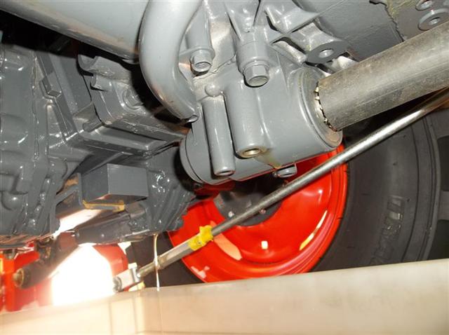

Pic#3 and 4 are the 12mm drain on the right side. Again, manuals show it as that 14mm housing bolt to the right of the actual drain plug.
Pay attention to the gasket washers.....mine were painted on and didn't look like there was any, but one fell off into the drain pan as it was draining.View attachment 363413View attachment 363414View attachment 363415View attachment 363416View attachment 363417

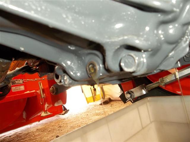

Pic 5 is the engine oil pan drain plug. Manual shows a double sump oil pan with two drains, mine only has a single with one plug.
