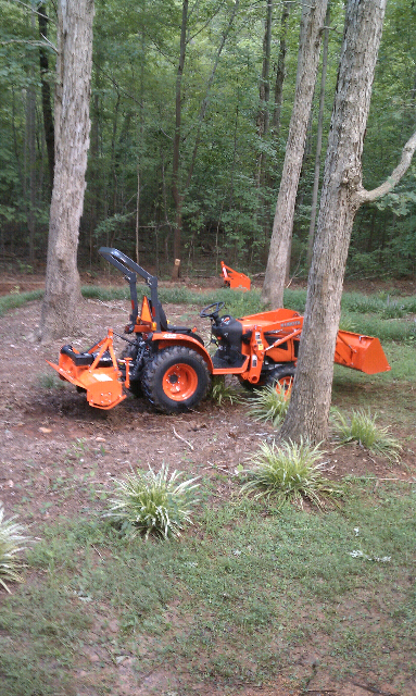

Well I used my tiller for the first time last evening. The 2320 has more than enough power to run the tiller.. i ran out of traction before hp. First time i ran the tractor at rated rpm for pto speeds... going to do some driveway work today..

How wide is that tiller? My family is thinking about a B2320 or 2620 and they have a 60" tiller already. I wasn't sure if that size tiller would work behind something this size or not.
   / B2320 first time till with LP0550 #4
I have a 2920 and it turns the 60" with more than enough power
The tiller is a 50'' tiller
RTR0550 model. it is also reverse tine rotation... The tiller will work with the BX and the B. I read the manual through and you must change the hitch point depending on what class hitch you have.. and tractor size
I know some others have said they have trouble with this tiller and the driveline angle on the B. I have not had thoese problems my PTO shaft it the right length though and Im running the slip clutch model not the shear pin.. the tiller maybe over kill for my current needs but I have hopes to have another garden spot soon..
BP is right the tiller is not the only way to go when putting in a garden.
