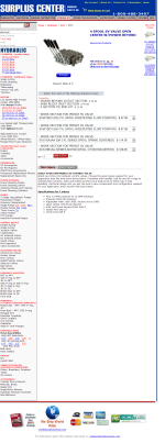

While I don't know those specific part numbers, the only "kit" available that I've ever see for a B20 series is for attachment to the ROPS. Otherwise, those part number descriptions make sense to me (first valve and option for second valve + stacking kit.) You just need to decide if you want double acting detent or detent with float option for the second remote valve.

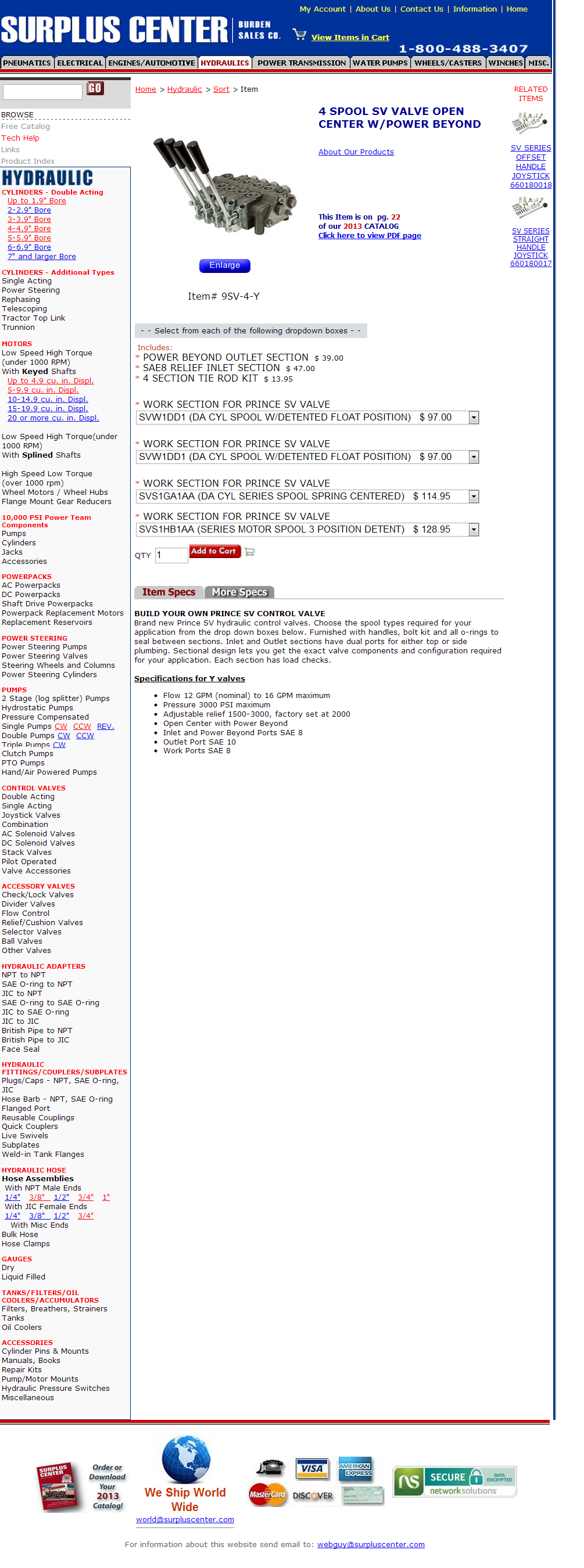

Are you really serious about those parts from Kubota?
You do know that you can do better with stacked valves from Surplus by about half that price.
$537.85
Burden Surplus Center
Yea this is the kit I was looking at before. I think you had recomended it a year ago JJ. I was just curious if the kubota kit was revised yet. I will go after market for this Im sure.

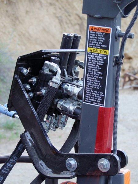

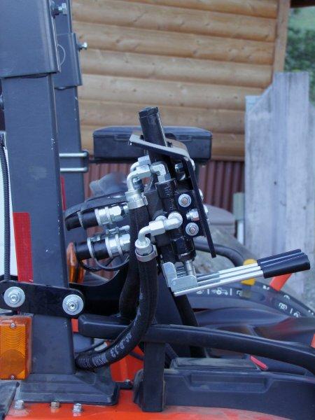

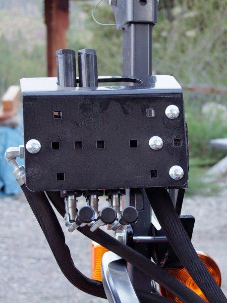

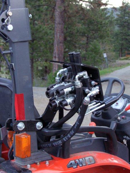

As promised here are a few pictures of a 3-spool stacked valve attached to my B3200. I have one double acting detent and two float detent valves + power beyond (for the BH). Initially I looked at getting a separate spool, as others have mentioned, it is cheaper but by the time I added in the hoses and tractor connections which are inlcuded in the kit I couldn't beat the price my dealer gave me.
Mike
/ B2320 remote kit #7

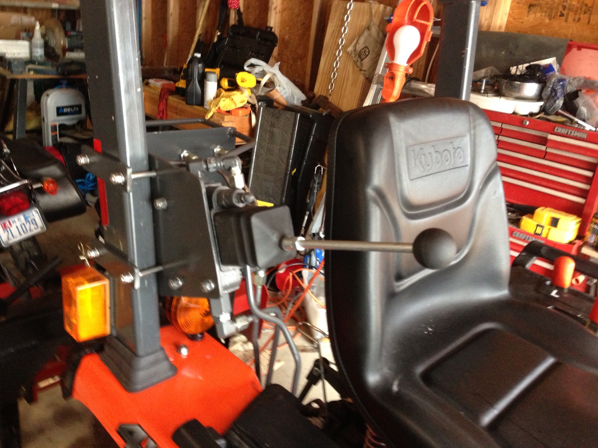

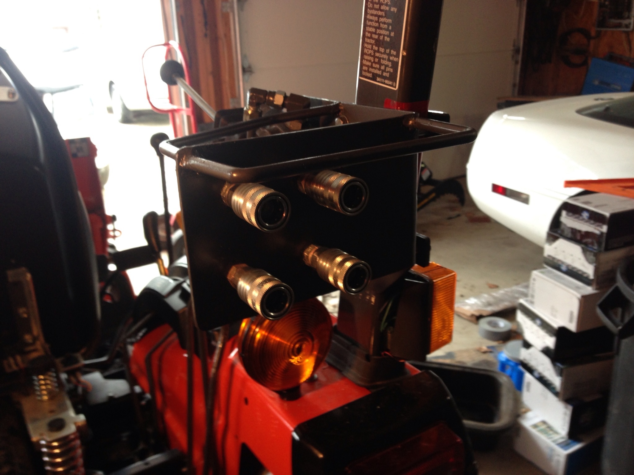

I didn't like the looks or price of the kit so I followed a few others lead here and added rear remotes with a valve from surplus center. I think I saved $200 by doing it myself and it wasn't that difficult once I got everything figured out that was needed.
