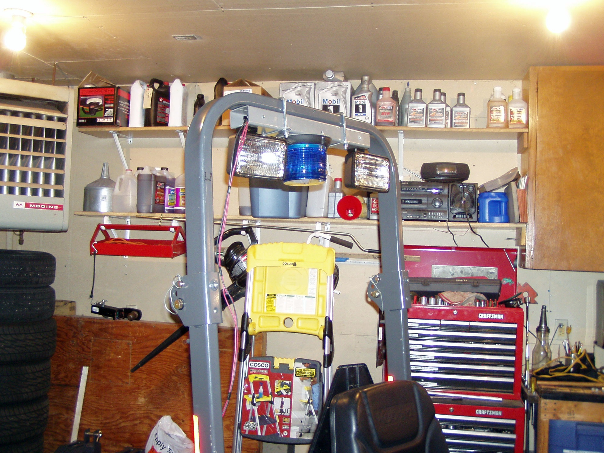

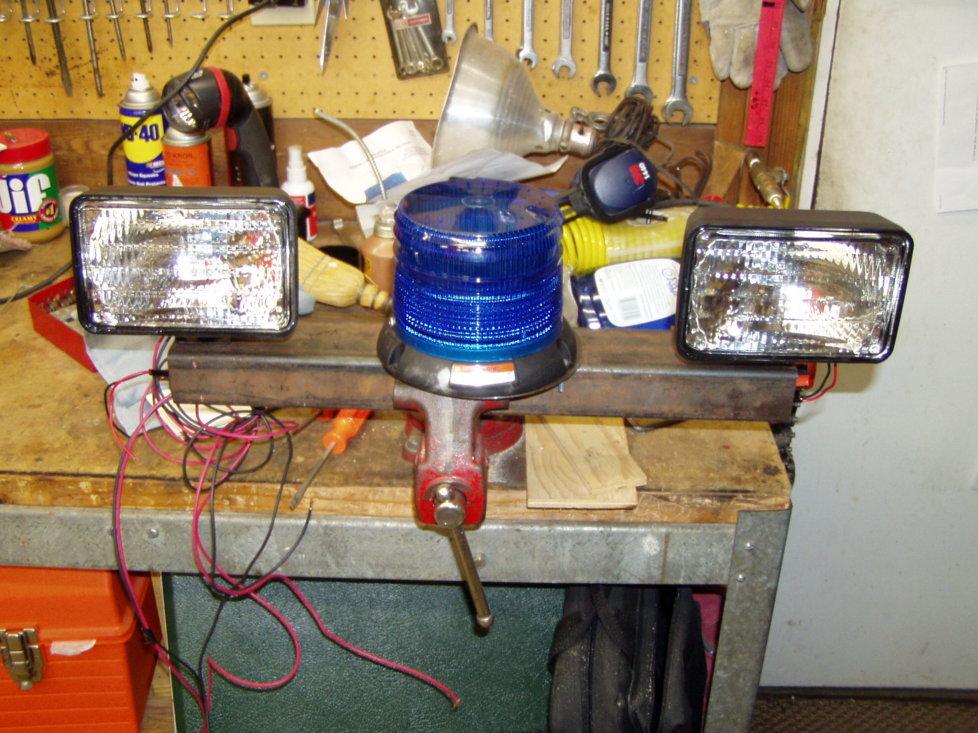

Well I have been busy getting my bracket for ROPS lights fabricated. This is probably a little bit after the fact to be asking this, but does it matter if I am mounting the lights upside down on the ROPS? Mocking them up, the beam pattern appears the same both right side up and upside down. I have seen a lot of TBN member photos with ROPS lights mounted upside down as well are right side up. Does anyone have any expeariance with the functionality of this?
I am going to take the light bar in the picture and use 3 inch square u bolts to secure it to the bottom side of the ROPS. This way everything will stay inside of the ROPS with no risk of damage. The position on the tractor will be upside down of what is pictures in the photo.

This is probably a little bit after the fact to be asking this said:
Worklight or flood it does not matter, as long as not mounted sideways; if trapezoidal, it does make a difference. If the lamps are sealed beams just re-index sealed beam in the housing, if lamp uses separate bulb, most lamps allow the lens/lens reflector assy to be flipped over, if the lamp has non fluted glass with free form reflector, the reflector assy must be flipped since the lens plays no part in the light distribution pattern.

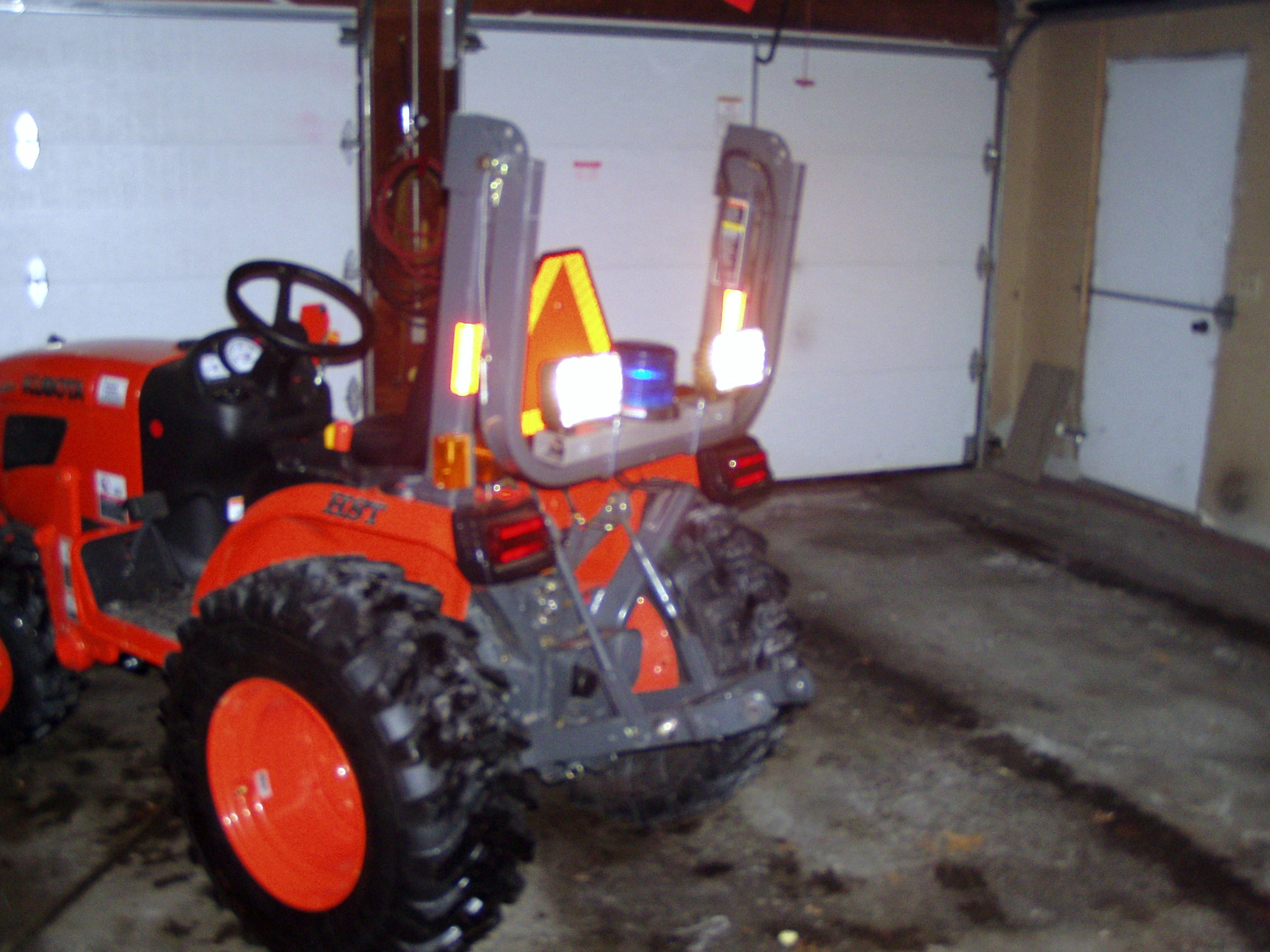

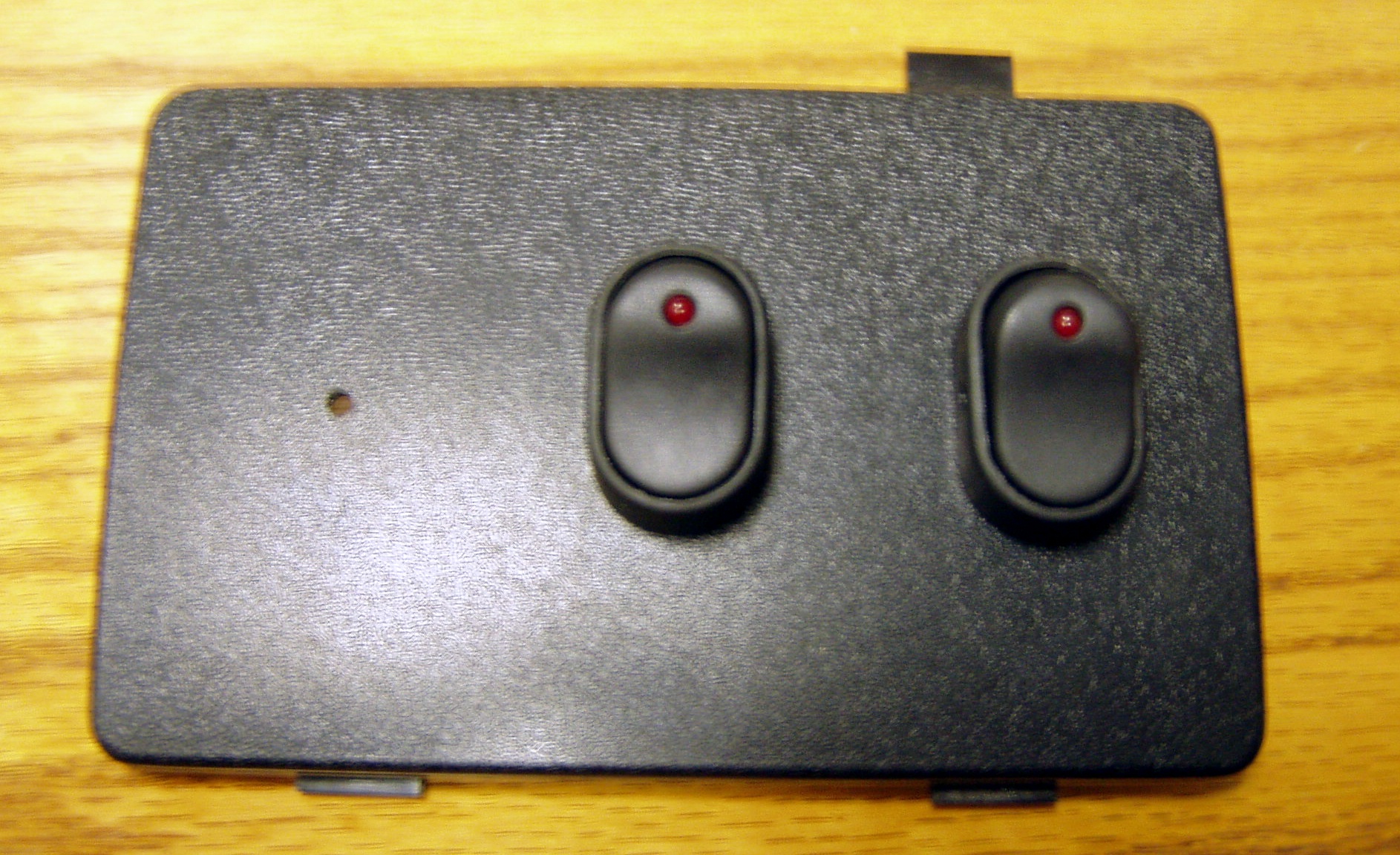

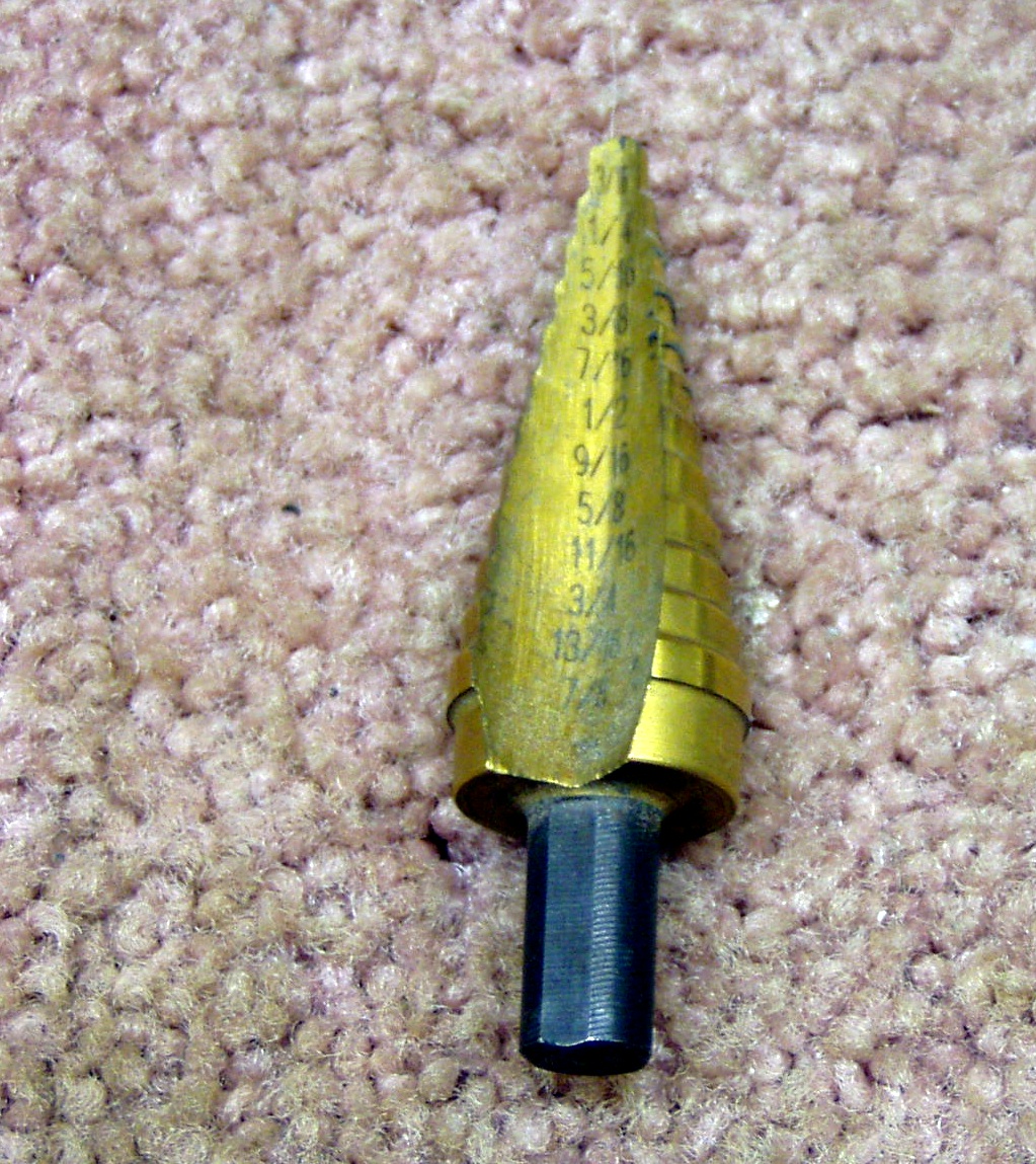

Here is my ROPS light project finished. I ended up using the 20 amp rear work light circuit to power these lights. I mounted switches in the blank panel on the right hand side of the operator's platform. The switches are rocker switches with LEDs from Wal Mart. I mounted everything so that it would all be inside the ROPs so I don't know it off the tractor when I forget about them. I found out a good way to drill plastic is to drill a small hole first and then enlarge it with a step bit on a cordless drill very slowly.

You Should go ahead and get new switches. I had the same ones and the first bit of moisture makes them inoperable. You need to get some which are waterproof.
