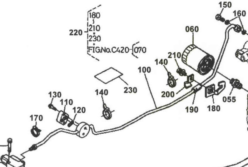

I have a B2400 with 370 hours on it. After bush hogging fields today for a couple of hours I noticed an oil leak - drops comming from the bottom of the rear axle on the right hand side of the tractor looking forward. The oil appears to be leaking when the tractor is running,and it looks like it is coming from high up under the seat. Any suggestions? Is it likely to be a loose hydraulic line?

Part #6C040-39216 is a common item to fail on your model.
It is item #100 in the attachment.

   / B2400 Hydraulic Oli Leak #6
My B2400 broke that delivery pipe at the banjo bolt. This pipe is a high pressure line. It's about $100 new. I still have my old one around with a crack in it waiting to get fixed by a local welder. On mine, the weld cracked.
If this is the problem for you, get a couple of new banjo bolts and crush washers when you replace the line. You cannot reuse the old crush washer; it will leak. The top of the banjo bolt will break off easily if you over torque it. Torque it exactly to the specifications listed in the manual.
To replace the line, you must remove the fender, seat, pedal linkage and deck. It's easy, but involves time. The hardest part was getting the pedal linkages back together. Take a photo or draw them before disassembling them.
By the way, the part number listed by TractorTodd is the correct number for the B2400. A new pipe may have a different shape to it back by the banjo bolt; mine did.
Oh by the way, mine broke a couple of years ago. At the time, I had about 380 hours on the clock. So I'd say, yours broke right on schedule. /forums/images/graemlins/wink.gif

   / B2400 Hydraulic Oli Leak #8
Hi Eph,
When mine broke, there was no spray, just a little drip. I found it with my nose; super UDT is stinky. You might be able to locate it exactly if while running the engine for a while (like mowing) so everything gets nice and warm, swipe a paper towel around the weld near the banjo bolt.
You are correct, this is the only line that high up. Unless a lift arm seal is bad, but I'll doubt that.
