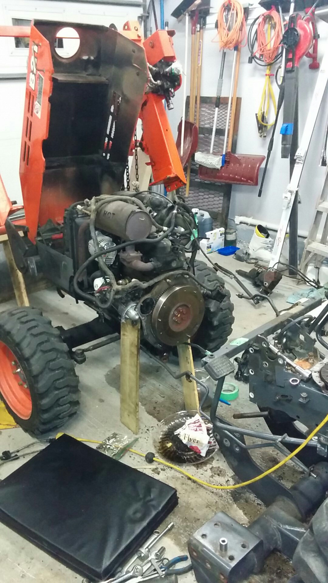

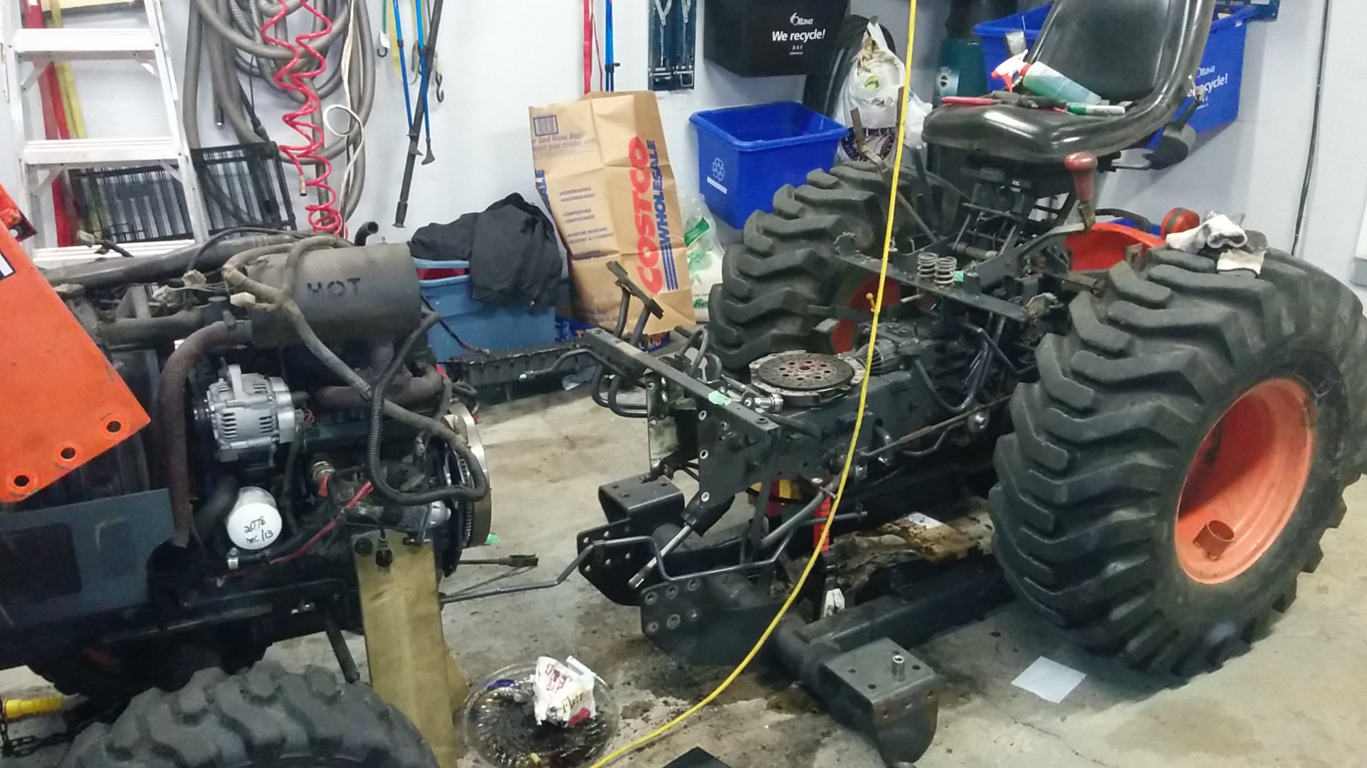

Great idea on the shaft removal!! Wonder what book time would of been?
book time is 12 to 14 hours at 75$ an hour i did the initial job with some modification to tractor and all parts on hand including the machined shaft new seal and seal install tool in less than three hours . With parts and new shaft with the tractor modifications done and the new desined shaft i can pull the shaft with stock couplings and install the 6 dollar seal in a half hour .
   / B2400 leak from clutch shaft seal. Help. #12
I just had the same issue with my B21 and the seal and the plug where leaking so I had to split the tractor to replace the seal and plug, the new plug is made of metal instead of rubber that would crack. I did it my self and it was a big job as the B21 has a extra sub frame and larger hydraulic tank.
Seal.jpe
