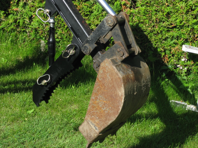

I built my own mechanical thumb out of 4" by 3/8" plate welded to the stick. Very handy and have about $150 into it. It maybe light for your b26, but works good on my little hoe.

Great job!

I bought a B26TLB in July of 2008 with a backhoe thumb. It is useful. However it is very flat (ie no curvature). There are small points on the end of the fingers, but they are too small! Some teeth about 2 inches long need to be welded to the ends of the fingers (which I have yet to do).
You will have to determine if the $1400 is too much.

I bought a 2010 B26 about 2 months ago. The hyd thumb was backordered, so I had to wait. Anyway it just came in and was installed and i got it back a couple of days ago. So I got a chance to use the machine with and without the thumb. I can say without a doubt that the thumb is just a pleasure to have.
I am regrading a ramp to a lesser pitch, so I am working on an incline. When digging and coming across rocks, which there are plenty of, instead of pulling them out and have them roll back hitting the machine, I am able to pick and place them where i want. Much nicer way to work.
$1400 for just the thumb sounds expensive. With my tractor, the dealer agreed to sell me the thumb and valve, to operate it, at cost and install it free.
----------------------Retail-------------------My cost
Thumb---------------$1100--------------------$900
Valve----------------$850---------------------$600
Install----------------$550---------------------$0
---------------------$2500--------------------$1500
So as you can see the very most you should pay would be $1100. Looks easy enough to install. The valve is the tough part. I could send you some pics if you think it would help with the installation.

The quick attach coupler is not required to install the factory thumb kit. When teh B26 first came out the Wholegoods list said it was, but was later updated to reflect that it isn't. I have a 2008 B26 that i bought last fall and also bought the thumb kit and remote kit and it installed fine using the original bucket.
As mentioned, the valve is a PITA to install (especially getting the roll pin for the lever to line up with the valve shaft).
I saved $700 buying the 2 kits from a US dealer versus buying here in Canada......
