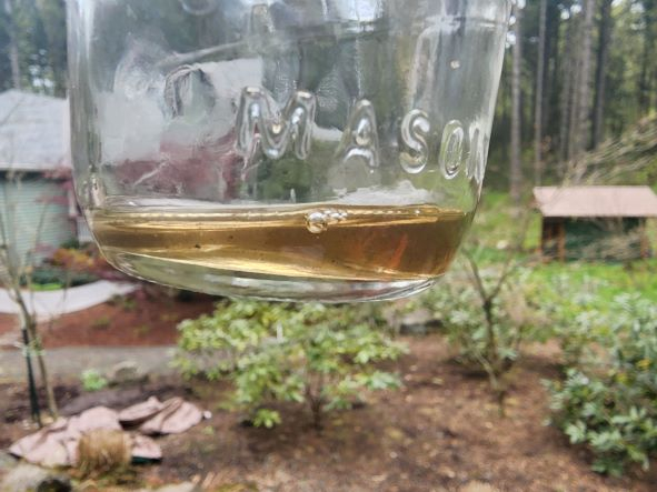

Here's a sample of it. Pretty sure it's beet juice.

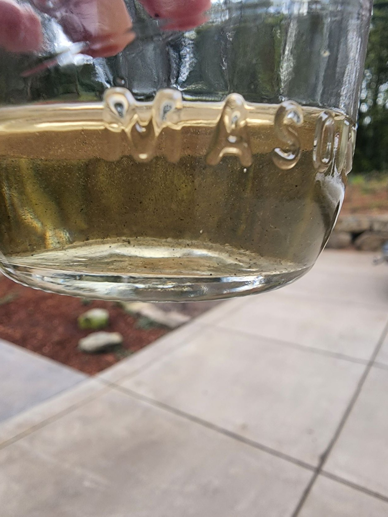

This is the same sample after diluting it with water. Not hydraulic fluid.

Beet juice has a sweetish smell, and dries sticky.
   / B2601 rear tire full of hydraulic fluid? #7
It’s some type of ballast fluid. Your air pressure got low and it squirted out the bead.
   / B2601 rear tire full of hydraulic fluid? #9
I guess its not out of the question that some mechanic had the bright idea to use their used UDT to load tires in new tractors. The last tractor my work bought came with beet juice loaded rear tires without us requesting it so i guess some dealers just do that. I could see some environmental types not being too happy about udt if thats what it truly is.
   / B2601 rear tire full of hydraulic fluid? #10
If it is almost clear, has no smell and feels slippery, chances are it's calcium. It was often used as tire ballast before beet juice & synthetics.
Dip a finger in it and touch it to the tip of your tongue. If it tastes salty, it's calcium. Don't forget to spit it out and wash your mouth out afterward.
