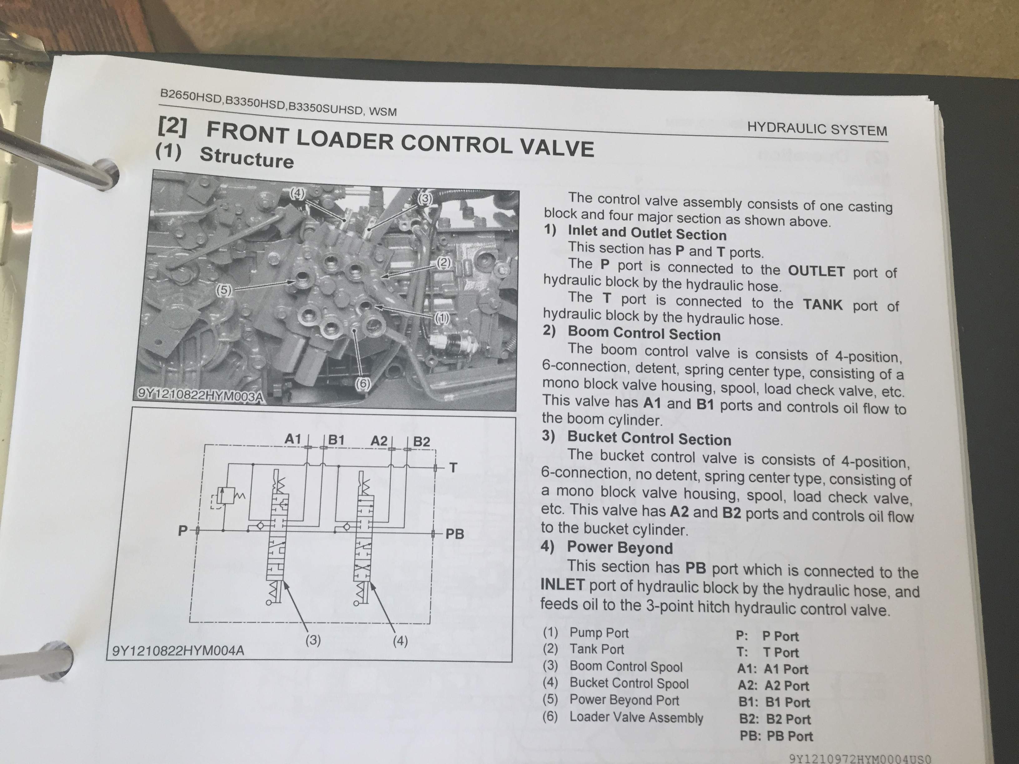

The loader control valve is leaking. It looks like it's leaking at item (1) in the picture at the top left of my shop manual for the B2650.
That looks like the pump port. My guess is that's at the highest pressure. It only leaks when I curl the bucket though. It might be that this port was removed when the dea;er added the 3rd function remote a couple months back.... IMG_3180.jpg

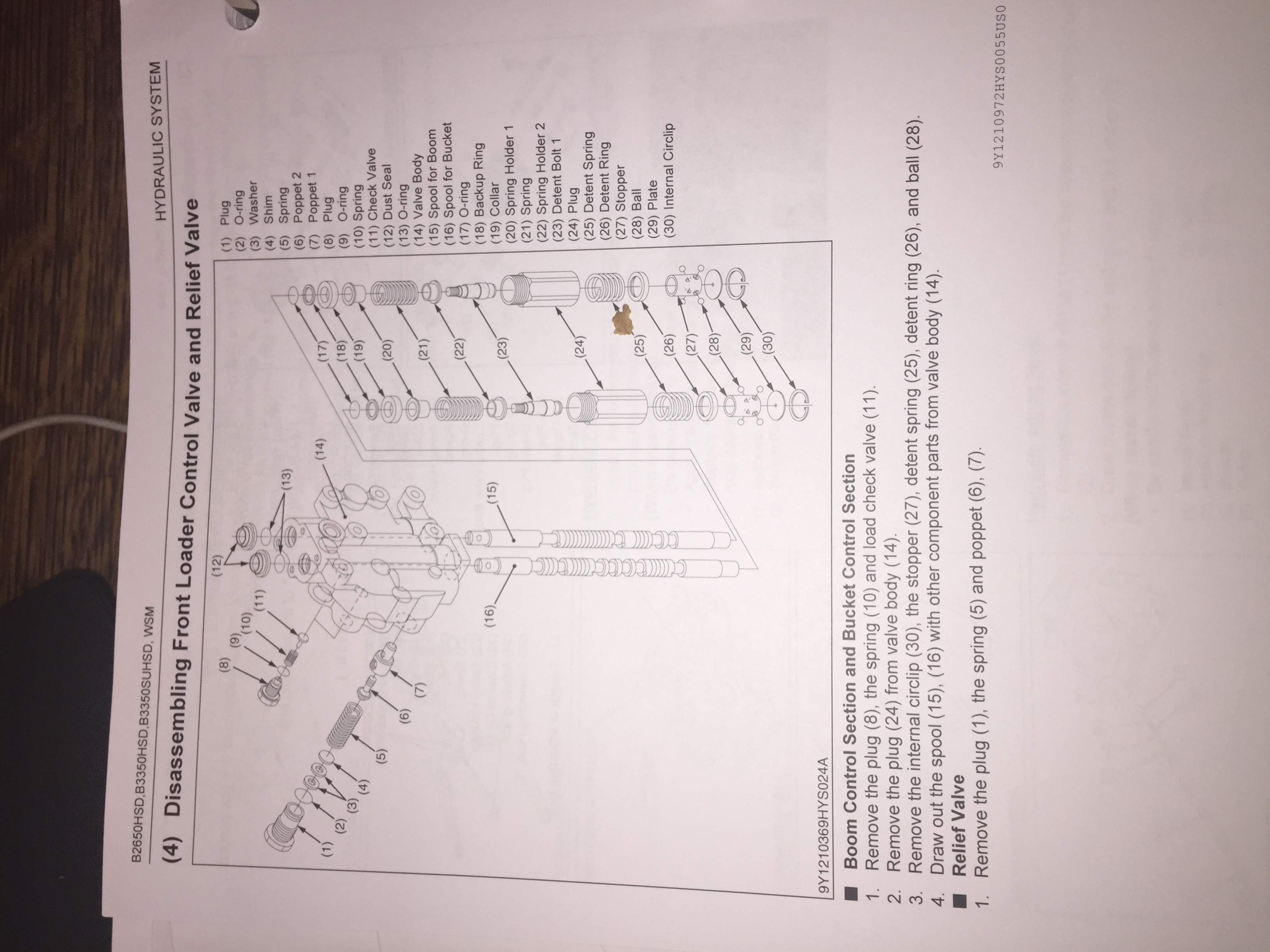

Here's the servicing section of the loader valve. looks like the issue could be one of 7 parts. My guess is it's the o-ring (2) or the poppets. I'm not sure whta a poppet does. Time to find out....IMG_3185[1].jpg

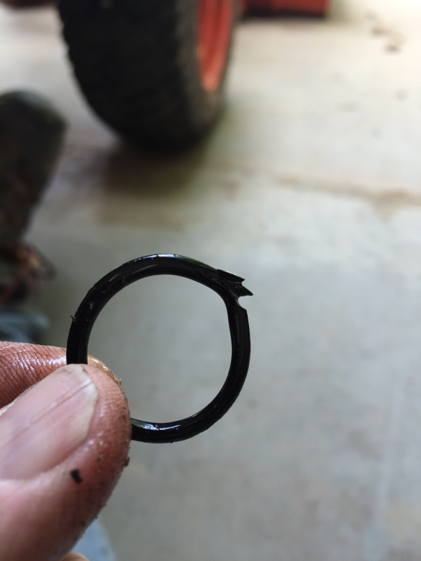

The fix is covered under warranty. The dealer told me it's probably the o-ring. I'm gonna pick up a couple washers and an O-ring this afternoon and see if thy does it. If it doesn't work, then I'll let the dealer fix it for free. I'd rather try the simple fix myself than to drag the tractor the 20 miles to the shop
   / B2650 Hydraulic leak near rear axle when curling the bucket
Simple fix. The o-ring towards the body was not put on there correctly when they added the 3rd function. It took 5 minutes to fix. It definitely looks pinched and finally failed at that point.

Thx. When I have issues I will post pics and videos every time. I use other videos and forums to fix just about anything you can think of. The Internet is awesome if used correctly......................................On this, The shop mechanic told me to put a little grease on the o-ring when installing it. That kept it from falling on the ground. You do NOT want to get the it dirty. Also - The breakout pic above from my shop manual does not show how the 3rd function is attached. As a result, the only thing other than the banjo fitting were two o-rings and the banjo bolt. There is one o-ring at the head of the bolt and another at the housing flange and banjo fitting. They are different sizes. The dealer gave me two of each and I did it myself. It was easy once the wheel a was off.
