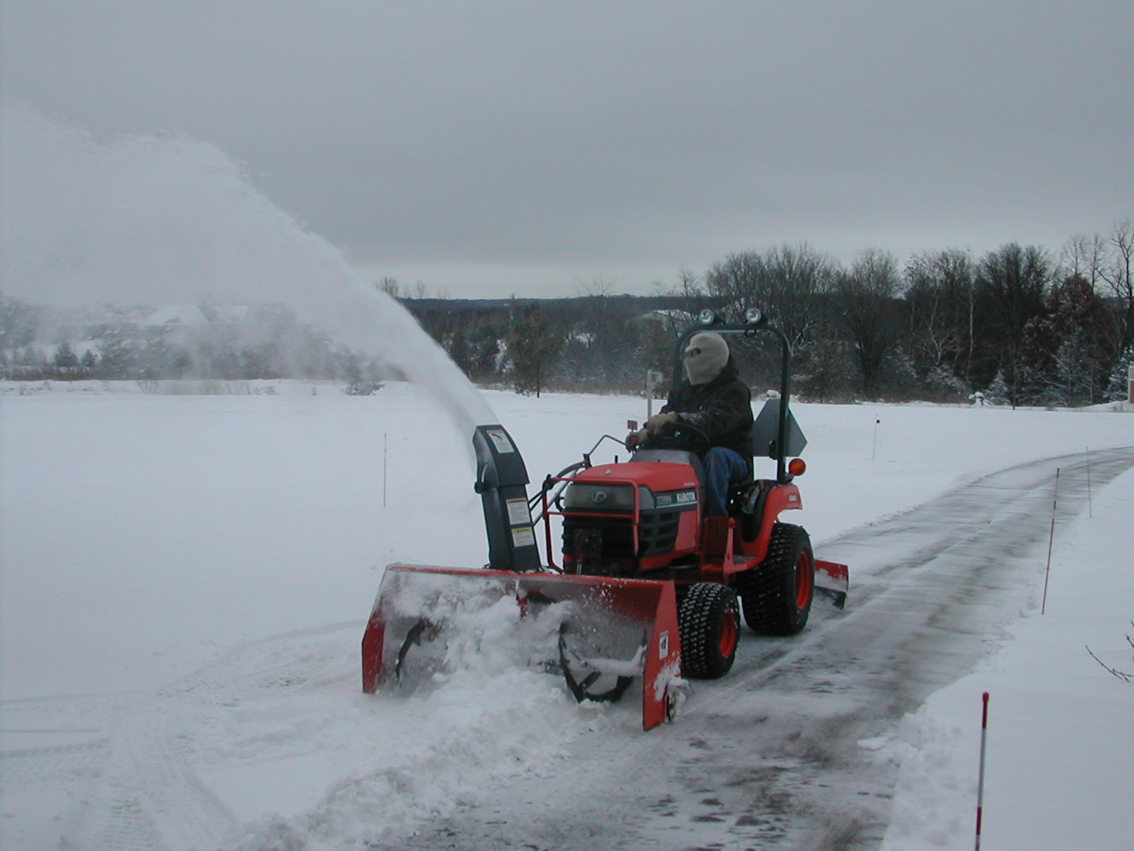

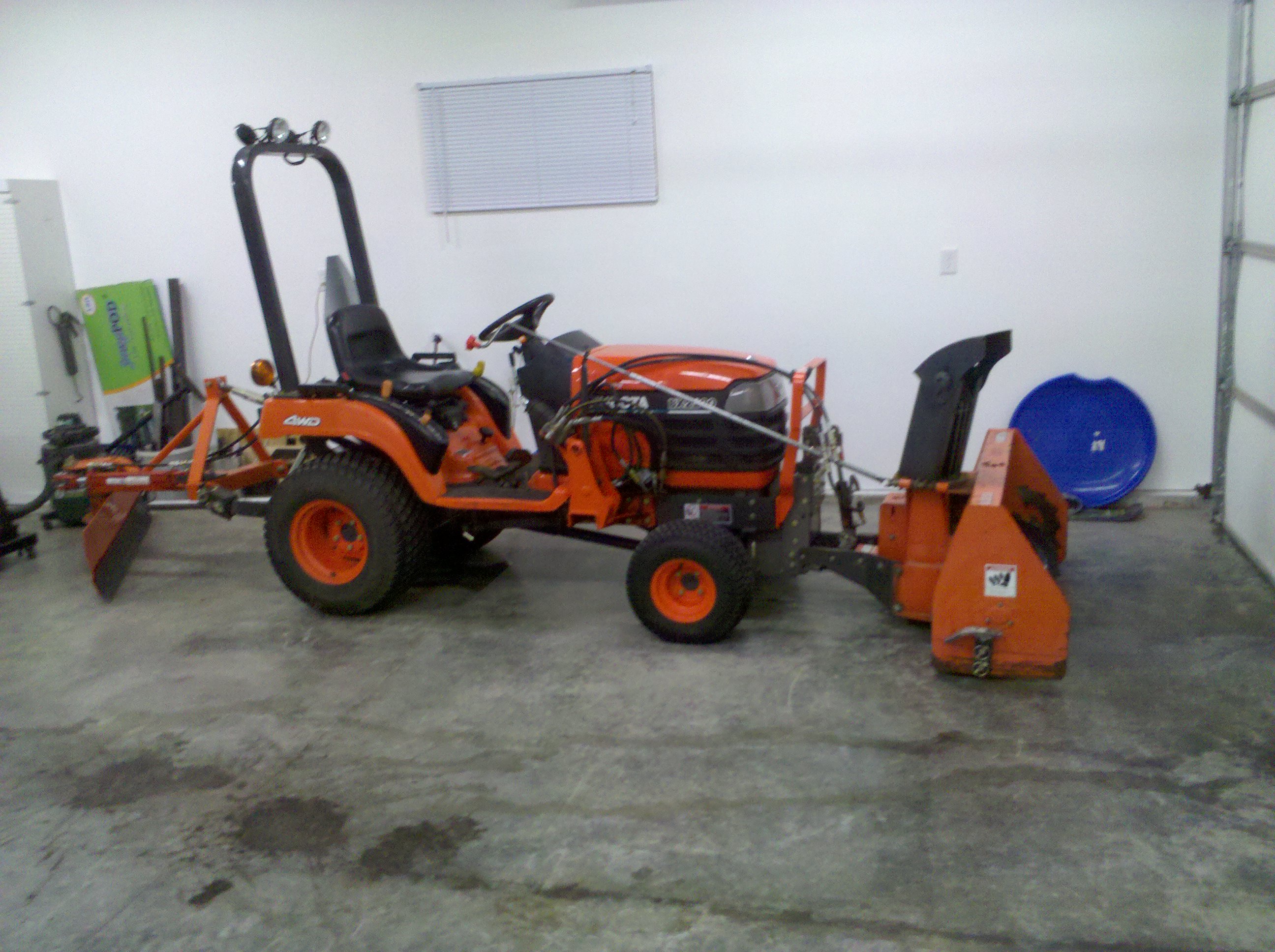

In the past I posted that I was converting a B2650 snowblower to fit the BX2200. I received several inquires as to my progress and whether it would work. The B2650 was designed to fit the B-series tractor. Thankfully the frame widths were similar so converting the mount was relatively easy. The hardest part about this whole project was finding the pto shafts to make it all work. The nice thing about the quick hitch assemble I made for this attachment is it will also work with several other front end attachments available.

Nice job! now what you should get is a femco weatherbreak to keep the blown snow off from you!
