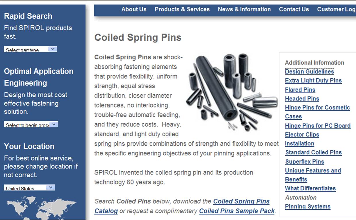

One trick I have used in the past if staying with the roll pin is to put one inside of the other. ie: use two of them. Another option would be the use of a coiled spring pin. See attachment.
The above can be considered if staying with the same design. The other options that require machining are probably better.
Additional thought...
1) Can the hole be enlarged? 1/32" or 1/16" This can increase the double shear strength by approximately 50%
2) 300 series Stainless pins typically have 60% of the double shear strenght of the standard 1070-1095 steel or 420 stainless.
