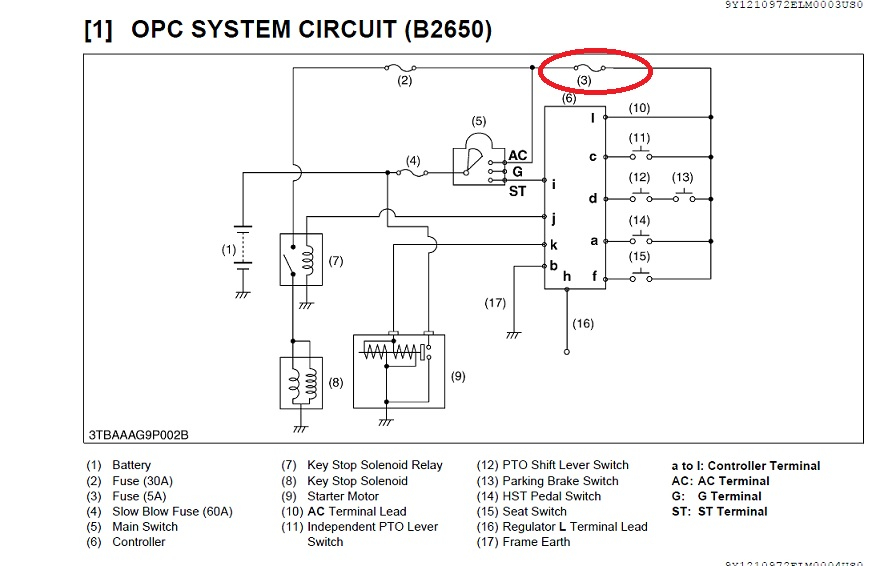

I have 291 hours on my B2650. Love the tractor. But recently, it has picked up this not starting thing. I go out to turn the key, sitting on the seat with the parking brake set, and the dash lights come on, but no attempts to turn over. If I wiggle the HST pedal forward and backwards, I usually find a sweet spot that it will start at, and on most occasions it will start, idle and run fine. Other times, as soon as I move my foot, it stalls again and cannot get it to start. I have left it, came back a few days later and it has started and idled fine.
So that's one issue, and the other issue is, when I am stopped, sitting on the tractor, or after I have set the parking brake and gotten off the tractor, it will stall. The dash lights will remain on, but the engine shuts off. Now, not all the time, but intermittently of course.
I can see the first problem being related to the HST pedal switch by the rear of it not working properly, due to dirt, debris, whatever, but I would not THINK that that would cause it to stall when the parking brake is set and I am off the tractor, or why it would even stall at idle.
Thank you much in advance folks.

The pto switch could cause the engine to shutoff. Seat switches cause me griff. CorrosionX and adjustment of switches critical especially with age.

291 hours. Still under warranty/extended warranty? Have the dealer look at it if it is. probably sensors/switches out of alignment or a chafed wire? how good are you with a multimeter? & do you have a wiring diagram to trace circuits? Something different happen right before it started acting up? Branches caught up in the underside?/sat out in rain/flood? different fuel supplier? when did you change fuel filter? air filter? does it have a Water in Fuel sensor? mass air flow sensor? any codes? too many variables.

It is still under warranty, but it's an intermittent problem and I would hate to bring it to the dealer 45 minutes away to have it operate normally for them while it's there, only to bring it back and happen again down the road. I am alright with a multimeter and do have the print-off on testing the pedal switch.

There are 4 safety switches 12,13,14 and 15. Tractor will start if not on seat if 12,13 and 14 are satisfied. If so and tractor dies when you depress HST pedal it usually points to the seat switch contact.

And the tractor does not die when I push the pedal, but that was the only way I could get it to start a few times, was by rocking the pedal back and forth to find a sweet spot where I assume the switch is properly engaged. Which is quite baffling as I knelt beside the tractor and rocked the pedal and the switch APPEARED like it was moving properly.
As for the tractor does not start if not on the seat, that safety on mine is definitely not working as many times, I have been standing beside the tractor, with the parking brake on, and started the tractor.
   / B2650 stalling or not starting - one problem or two #10
Correction - all have to be satisfied. Still leaning to seat switch or brake switch. One you get running with PTO on, lift off seat and should shut down (indicates PTO switch working) same with HST pedal, if it dies while moving when you get off seat its working. The tractor will start if the brake is locked down and 12 and 14 are satisfied.
