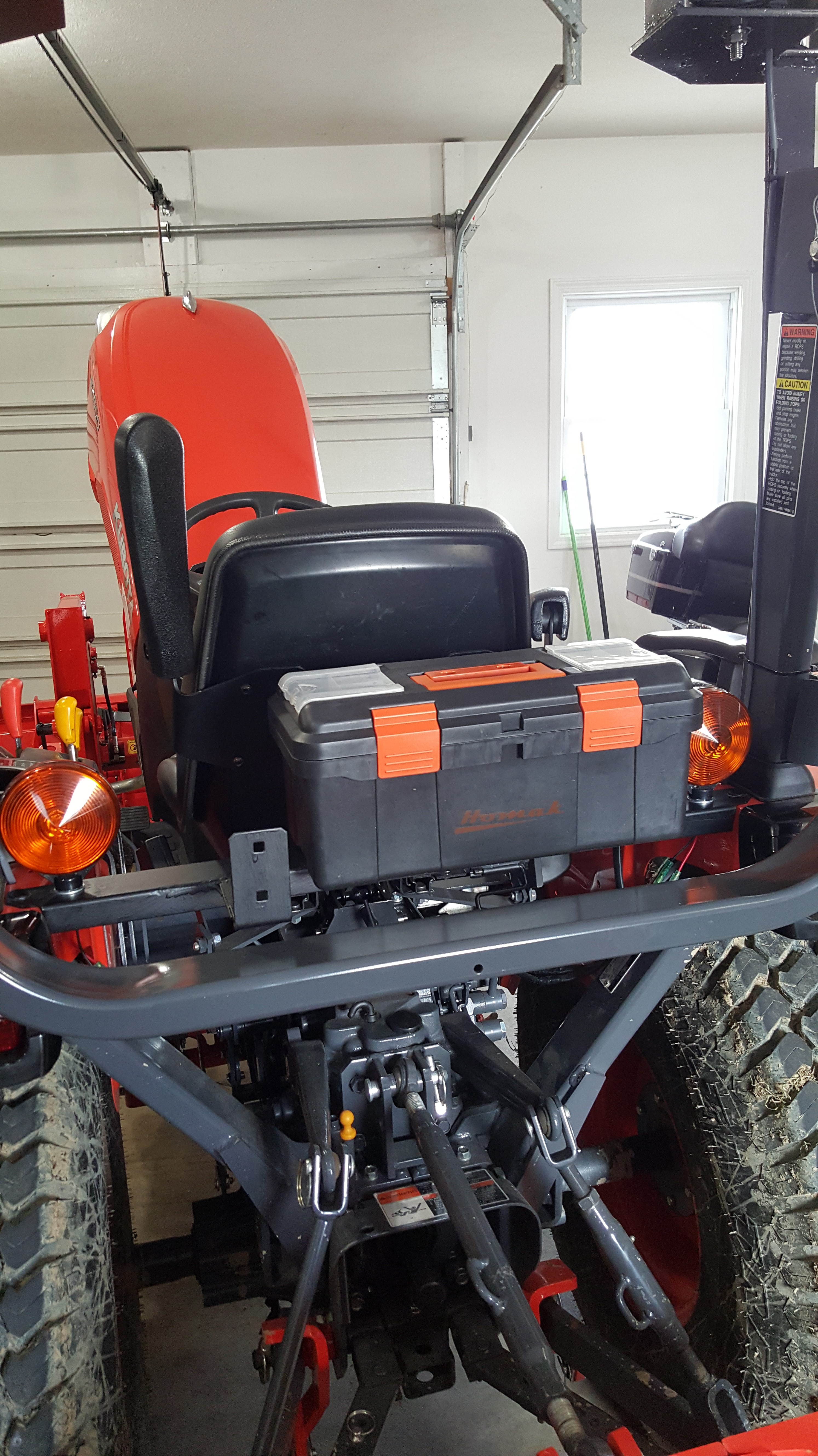

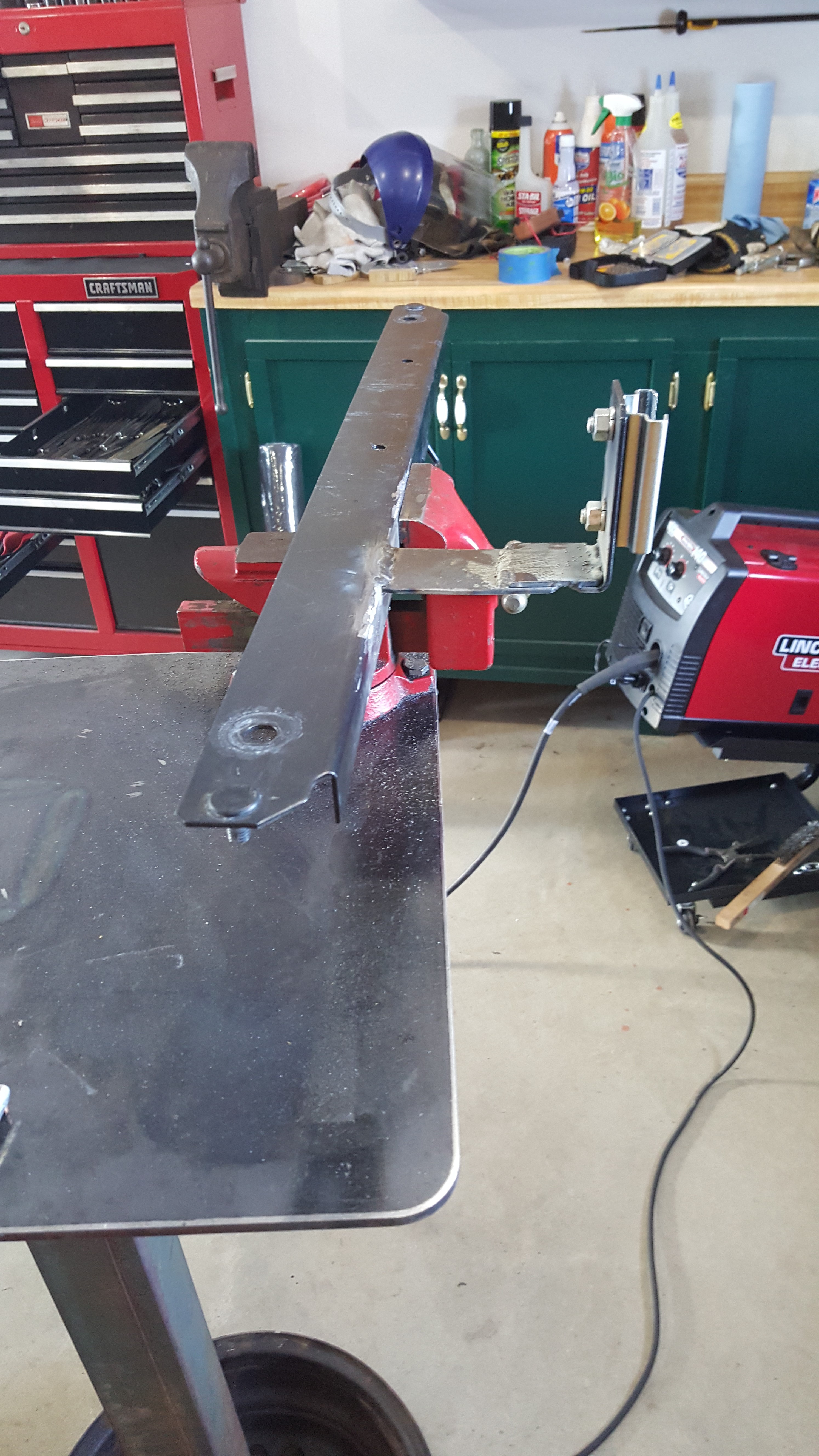

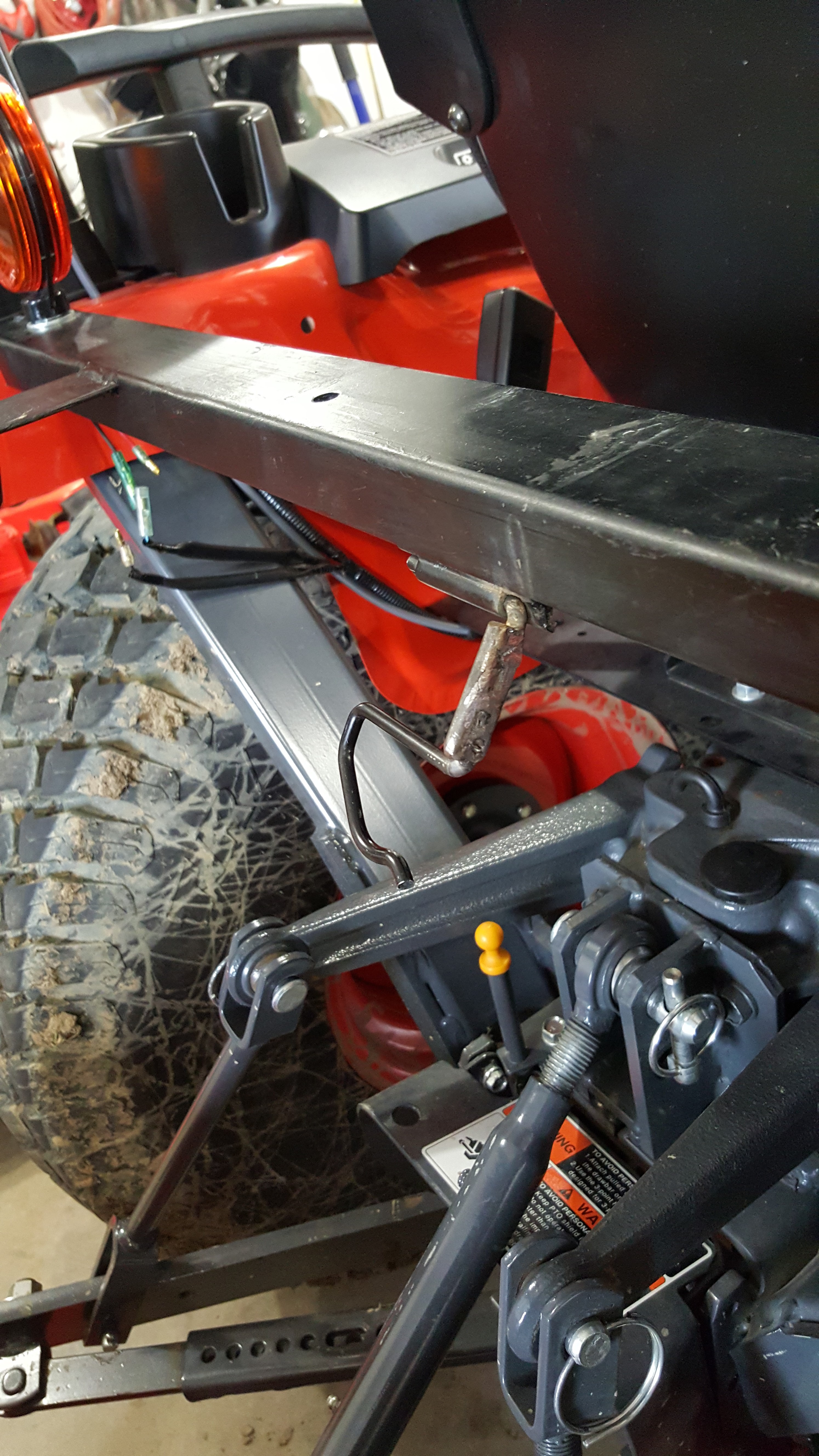

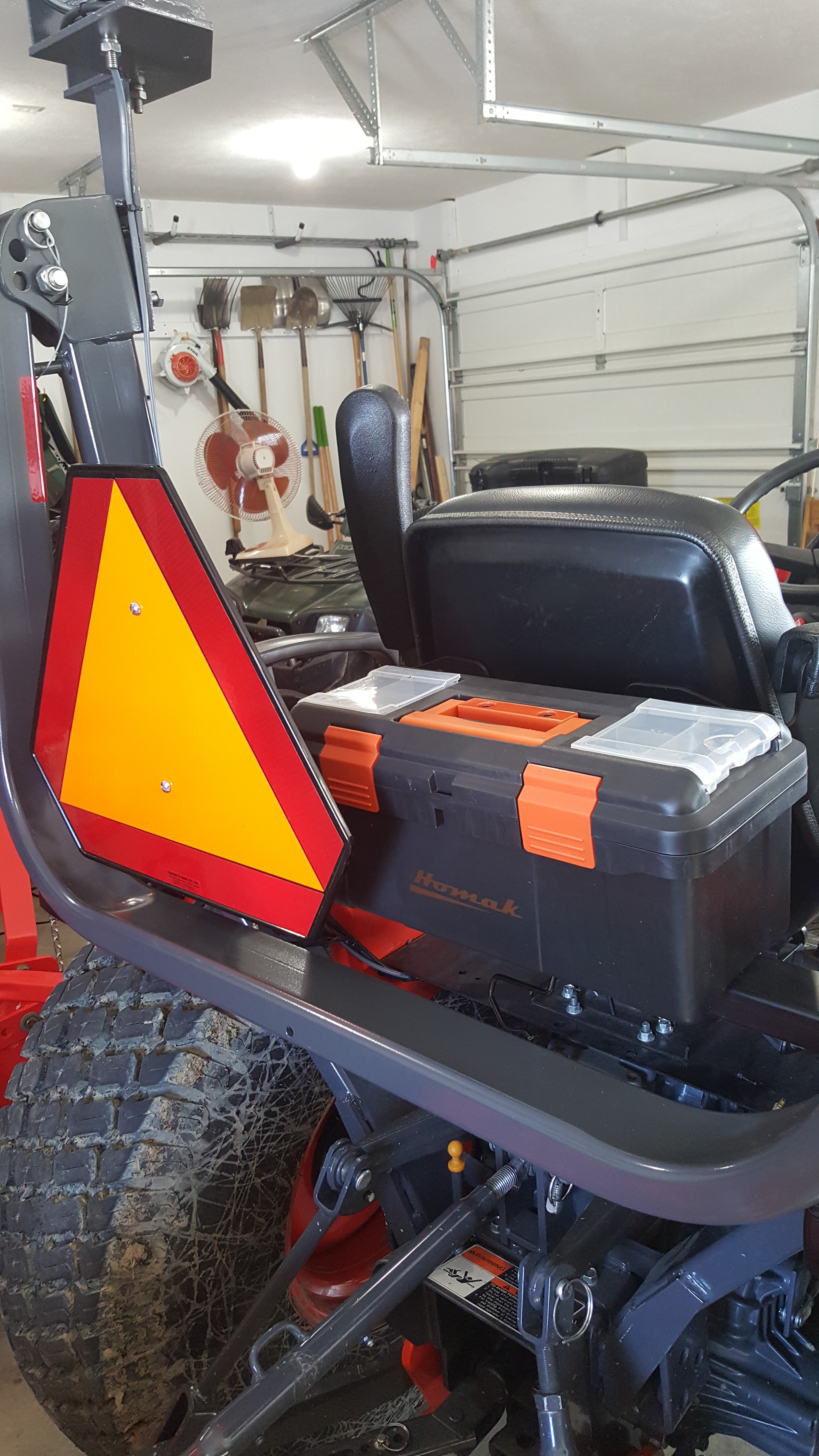

I decided to install a bigger tool box on my B2650. I found on at Napa for $12.00. Took the crossbar off that holds the tool box and removed the lights. I then cut off the bracket for the slow moving vehicle sign and moved it as far left as I could and back 3 in for the room for the bigger box and room to get into it. Welded it back on. I then cut off the hook that holds the top link and moved it back 1 in and welded it back on. Painted it back up and installed crossbar and new tool box. Everything works great and I now have room tools and gloves and more.

Good looking job,the colors match perfectly.
