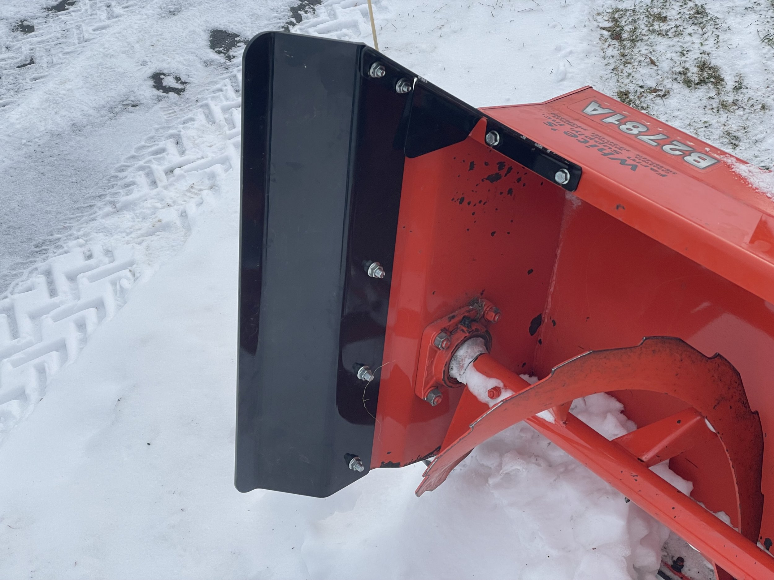

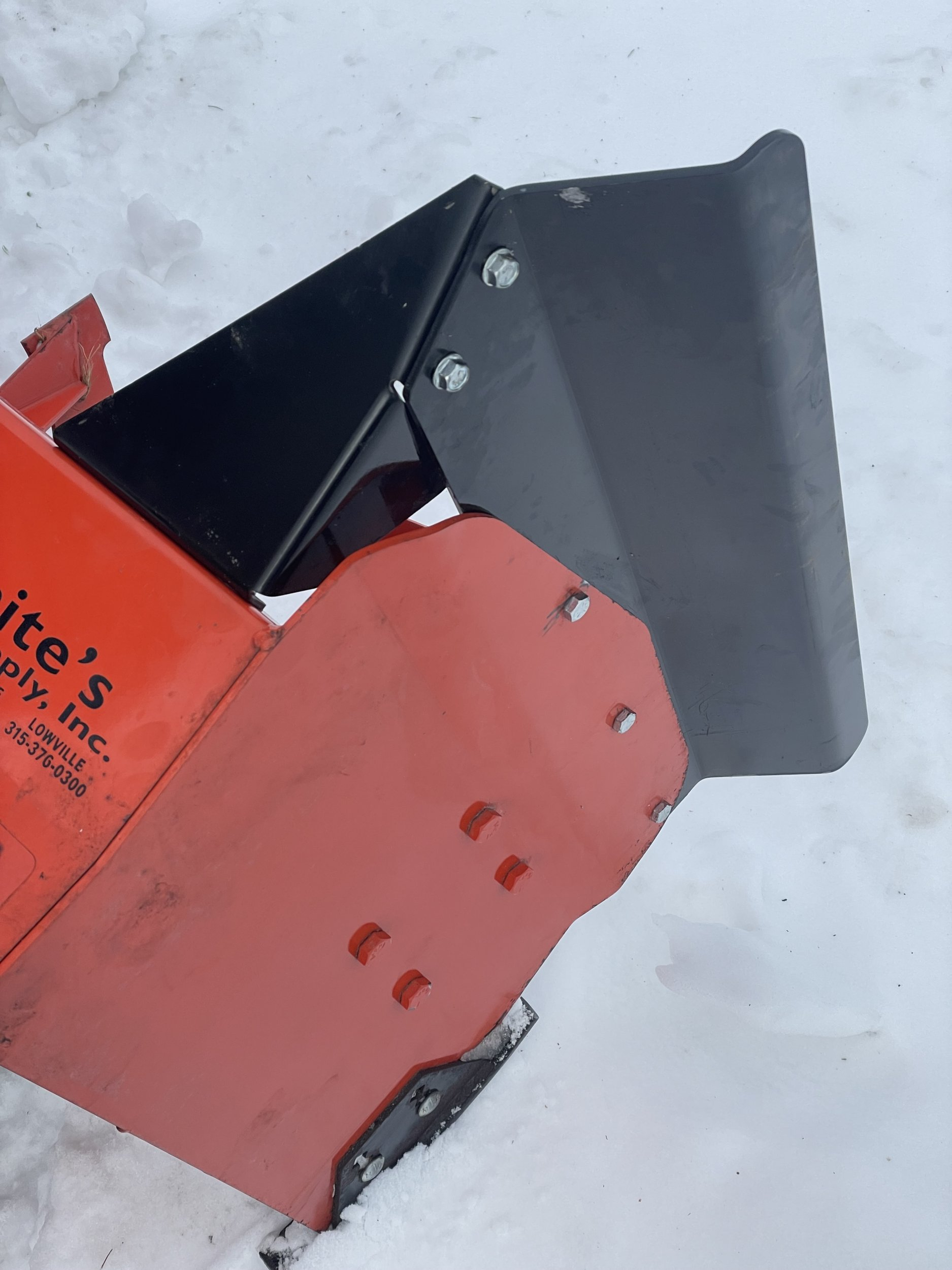

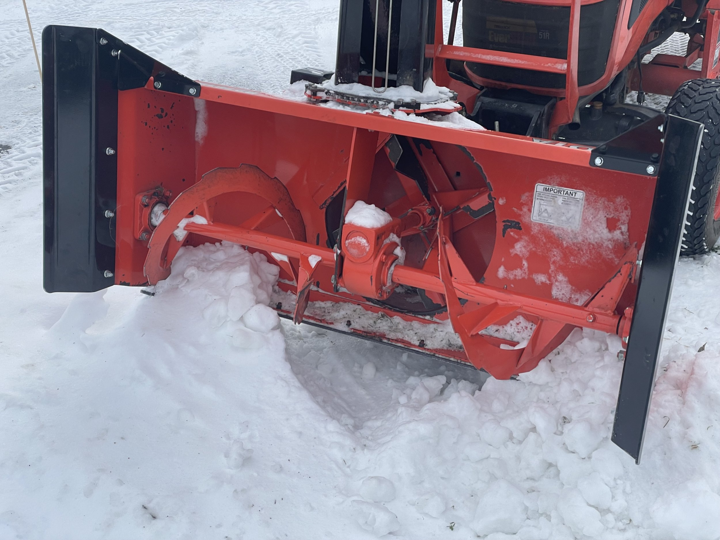

I haven't posted in such a long time, but figured this would a good time to re-connect. I picked up a set of Kubota B2786 drift cutters for my B2781A 51" front snowblower and just installed them. I'm hoping they help steer more snow into the augers for fewer clean-up runs. Installation was pretty straightforward, but make sure you have the correct drill bits to cut through the hard steel (11/32" and 13/32").

I've had them on my B2782 for 5 years now.
Helps a little to reduce clean up,but not as much as hoped.
If you're trying to widen your frozen/semi-frozen driveway banks,they suck you in real quick!
My vote is 65% worth it.
Good Luck!
   / B2786 Drift Cutters #3
Those are some heavy duty wings, and well designed.
Some day I'll get around to adding some to my blower, which is the same width as my rear tires... A couple additional inches of blower width would be better.
