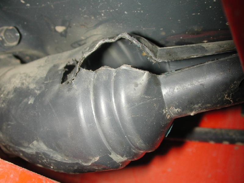

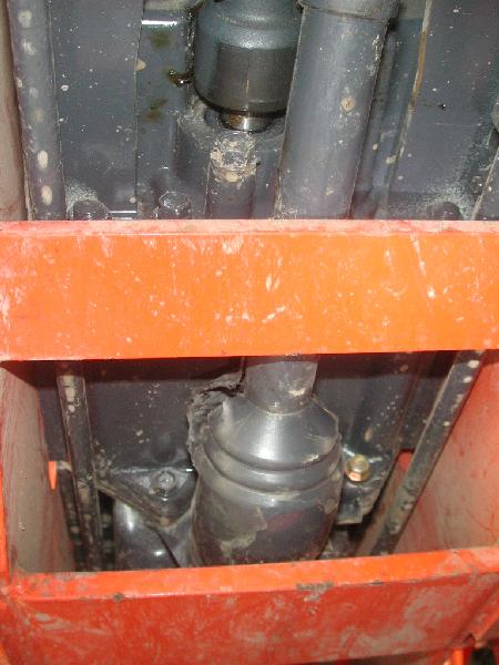

Here are a couple shots of the damaged cover...
The little hole that shows in the close up was all that was evident when I first looked. But some plastic was folded in and I had to pry it out with a screwdriver.
The thing that bothers me is that the damage is on the top, rather than bottom half.
I did get stuck in some mud once...perhaps that caused the cover to be pushed up somehow. That mud was BLACK though, and not the brown color of the dust I have been making over the last couple weeks.
attached is the overview, with the closeup to follow...
Bill

and the closeup...

   / B2910 driveshaft plastic shroud damage common??? #5
Re: B2910 driveshaft plastic shroud damage common?
Can't tell from your picture, does the subframe from your backhoe touch the cover? If not I'm suprized it didn't protct it better.
The plastic shroud does not touch the subframe. It is actually about an inch away I think.
That puzzles me too...The damage seems to originate on the top, rather than the bottom, and the whole thing is pretty well protected. BUT, I was deep in muc once so MAYBE the mud got up there and pushed on the plastic cover...
Just don't know...hard to cry too loudly about this as I might have caused it myself.Then again, maybe I didn't....
Bill
   / B2910 driveshaft plastic shroud damage common??? #7
Bill
The picture looks like the middle U-Joint has been hitting cover. I would ask your dealer to cover it under warranty. It may have off to one side when built causing it to wear through.
Hi,
Took my laptop to the dealer's today and showed the owner the close up picture.
Talked to the mechanic before the dealer got back and when he saw the picture he figured it would be a warrenty repair. The owner I guess said the same thing.
The mechanic also mentioned hearing a sound that could be related to this cover at times. He also thought he may have seen a service bulletin on it, but could not find it.
I will report back after the repair is done. Not sure how soon that will be as I still want to use the tractor while the weather is good. But I will probably buy a box blade from this dealer, and if I do I will try to combine the repair and the delivery so they can save a trip.
Sounds to me like this shroud damage problem may be more common than we realize. I put a fair number of hours on my tractor the first month [about 60, now have 93 in about seven weeks] and so the problem appeared quickly. Other wise it may not have appeared until next spring! By then warrenty may have be debated more.
