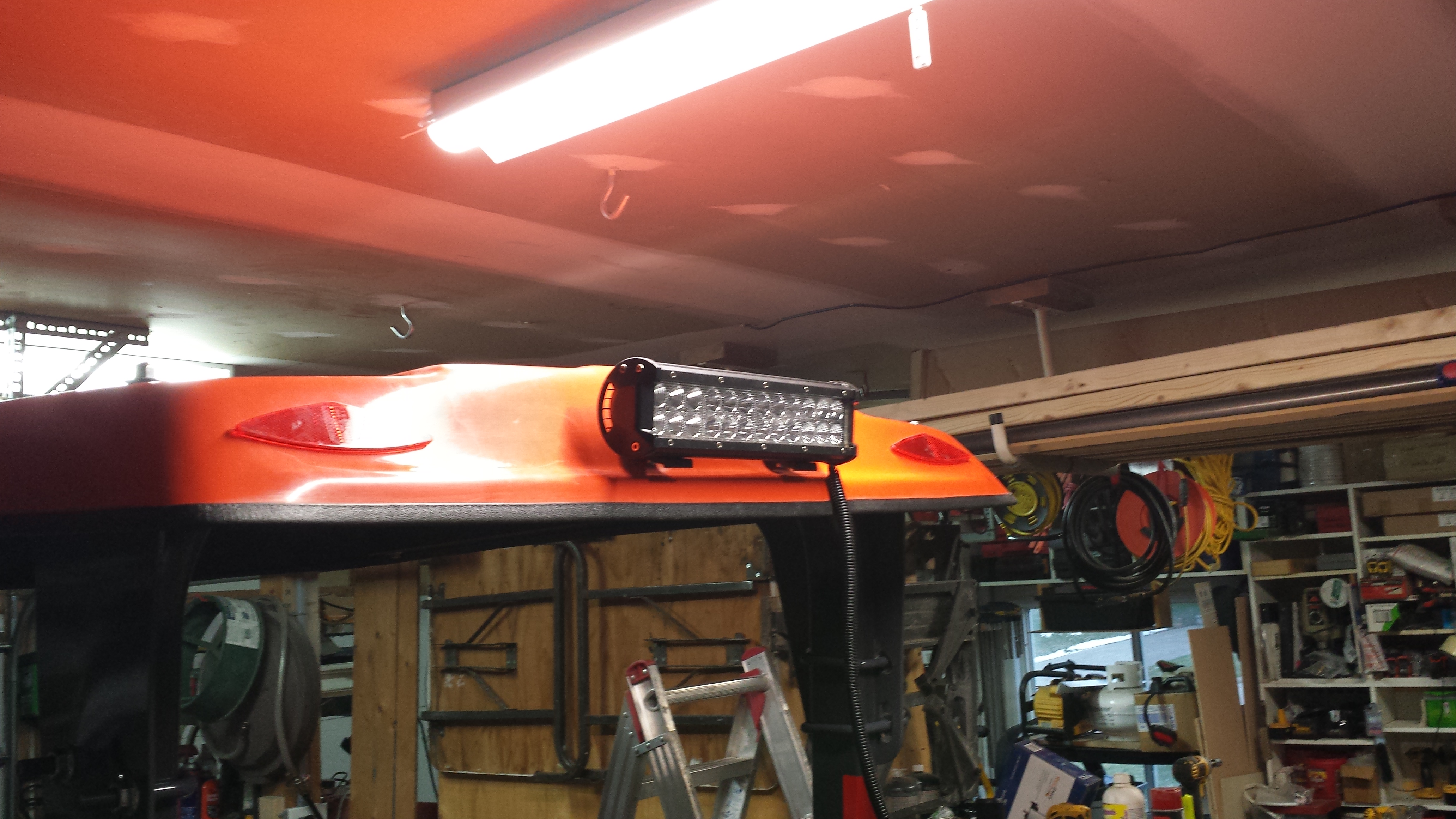

Nice job on the lights. I have LED flood/spot lights on my hard top too but I don't always have it on my tractor. It's too tall to fit through my barn door so it comes off for the winter.

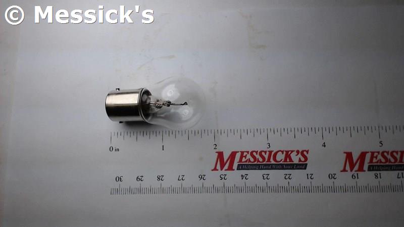

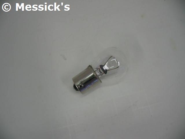

I am stuck not being able to get to my camp and my tractor for a while so I can't pull my bulb to compare. But from the brief searching I've done, the 1073 bulb appears to be the same configuration as an automotive 1156 bulb.
From Messick's parts site this is the bulb from the 2650
From the same site this is the bulb from the B3000
Don't know if this will help you in your search. Hope it does.

Thanks GRTkub.
That is a picture of pretty much, what I have.
I have done a search for bulb #1073 LED Replacement and gotten some results back.
I believe the LED equivalent of the 1073, is an 1156, but not positive.... yet...….
Now I need to research to see what others have used successfully and if they liked the results.
